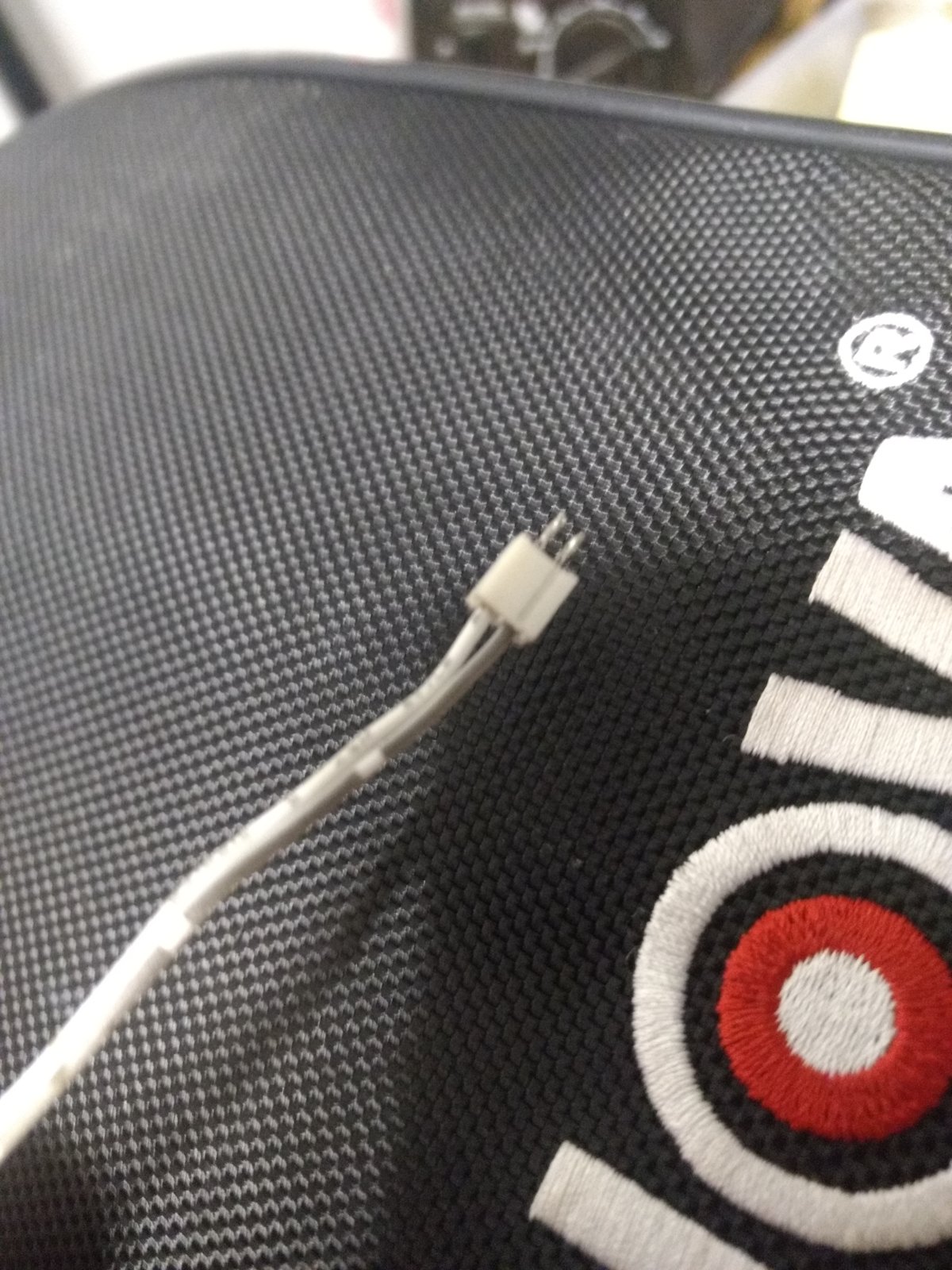

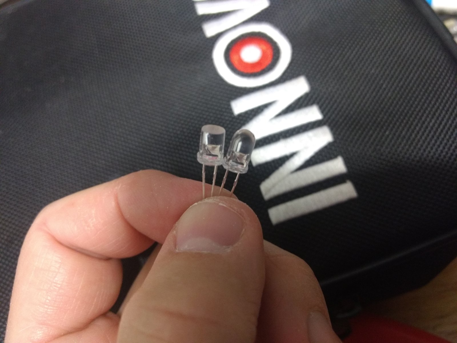

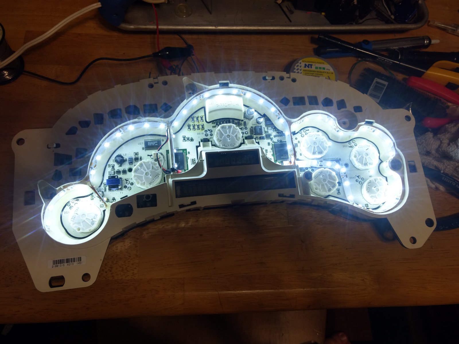

How are you doing guys?
Well I decided to replace the bulbs with some leds I ordered from ebay
I can get these to turn on with a 9v battery but when I connect it back to the dash they wont turn on
Can someone help me out?

I would double and triple check that the polarity is correct. If that is not the issue, then make sure you have voltage at the dash plug. Could be the dimmer switch is turned all the way down, or a bad fuse.

i had them reversed
thanks for the help
