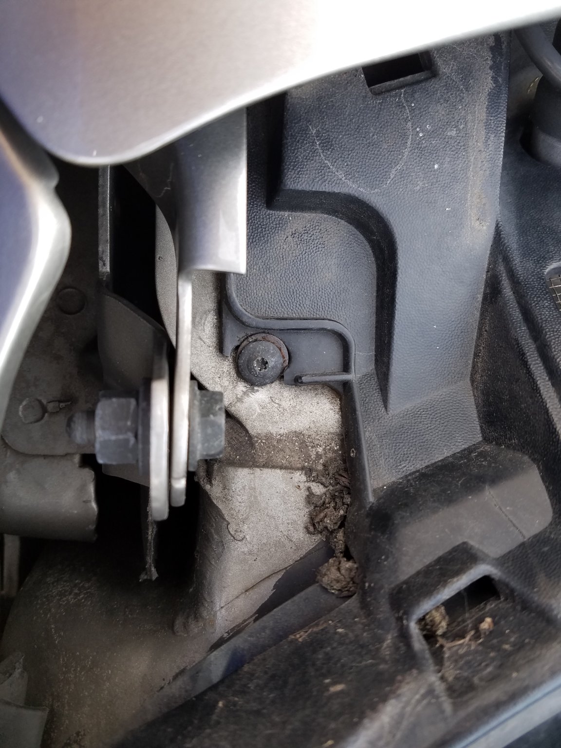

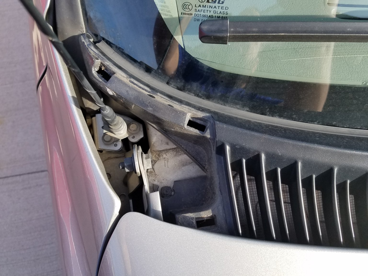

I went looking looking today for the screws that hold down the wiper cowl today, and I found that they were both broken:
(They are under the hood hinge covers. The covers just pull off.)

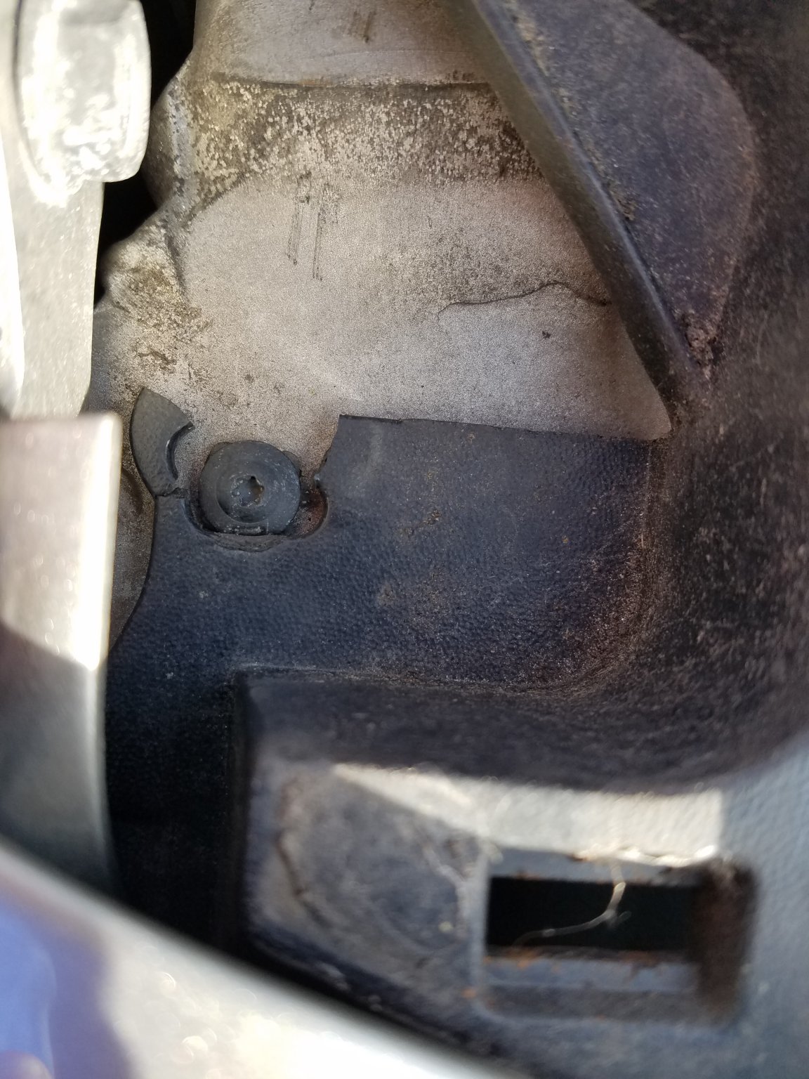

Passenger side:
Driver side:

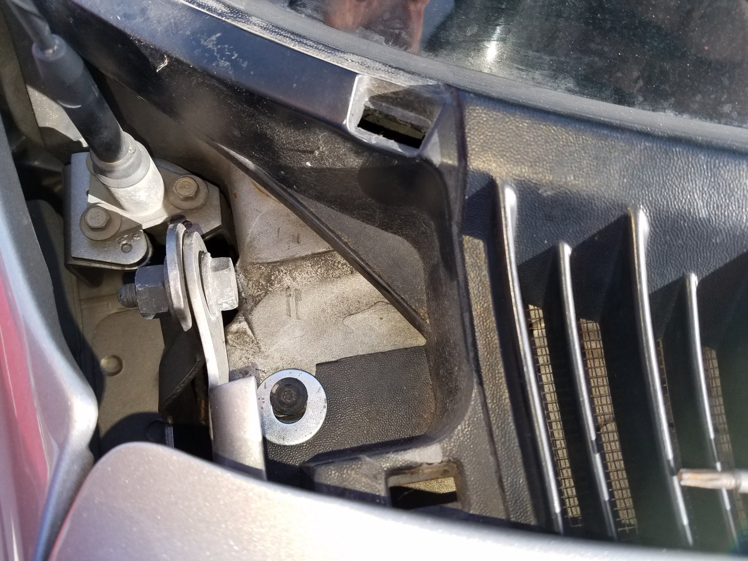

I used a large washer on the passenger side:

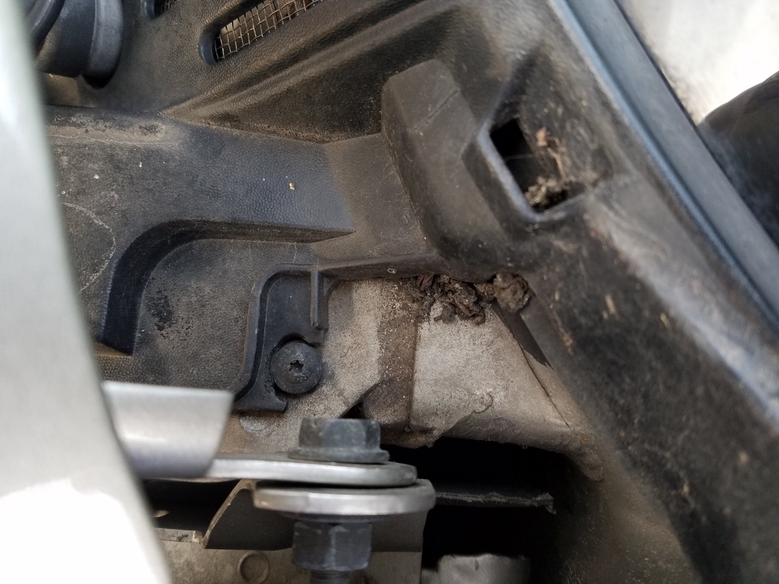

And a small washer on the driver side:
Way cheaper (and a lot less work) than buying a replacement.
