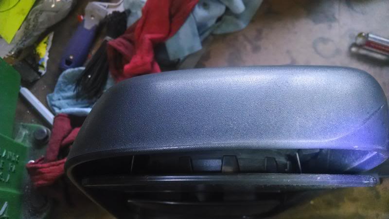

Next, remove the top glass from the housing. You can see in the next picture there are a bunch of small tabs holding the mirror to the housing. Put a small amount of pressure on the mirror pushing outward, and with a small flat screwdriver pry up on the tabs one by on until the mirror glass comes out. If you have heated mirrors unplug the heating element. (this is for power/heated mirrors. Manual mirrors may differ)

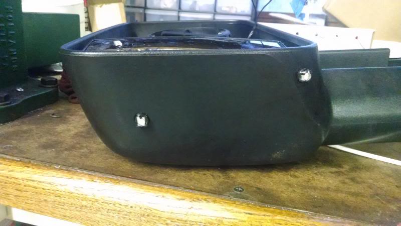

Now you are ready to mark the outside of the mirror for your lights and drill the holes. This is the orientation I decided on. 5 vertical LEDs on each mirror, and 2 of the white LEDs on the bottom for the courtesy/puddle lights.

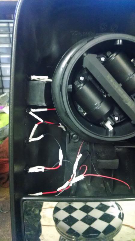

Once the holes are drilled you can insert the LEDs and wire them up. Like I mentioned earlier, the turn signals are wired in series, and the puddle lights are in parallel since they have their own resistors. All of them share the same ground, but have two separate power sources.
The factory mirrors (which I removed to add the towing mirrors) already had a puddle light in them so I was able to wire the power source for the new puddle lights into pin F (white wire) on the existing mirror plug, and picked up the factory ground for the defrost from pin H (black wire).
