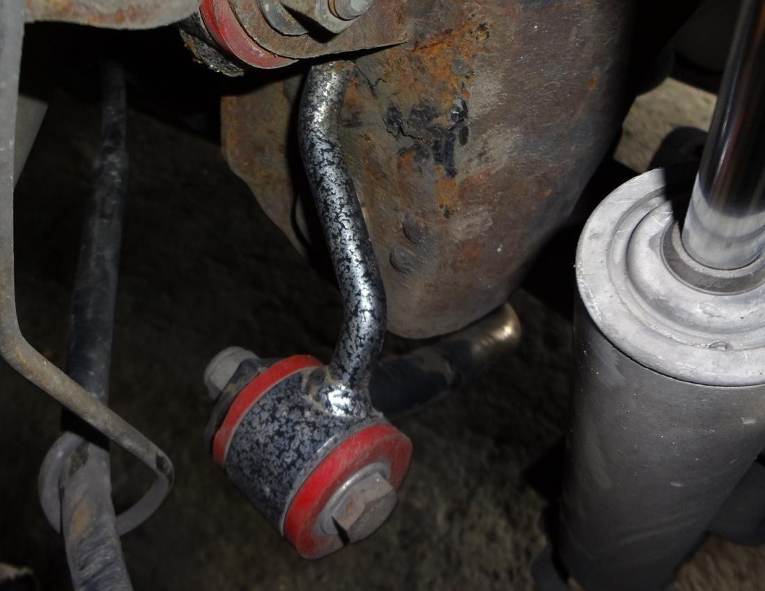

hang the calipers by wire from truck, or lay on rear control arms.

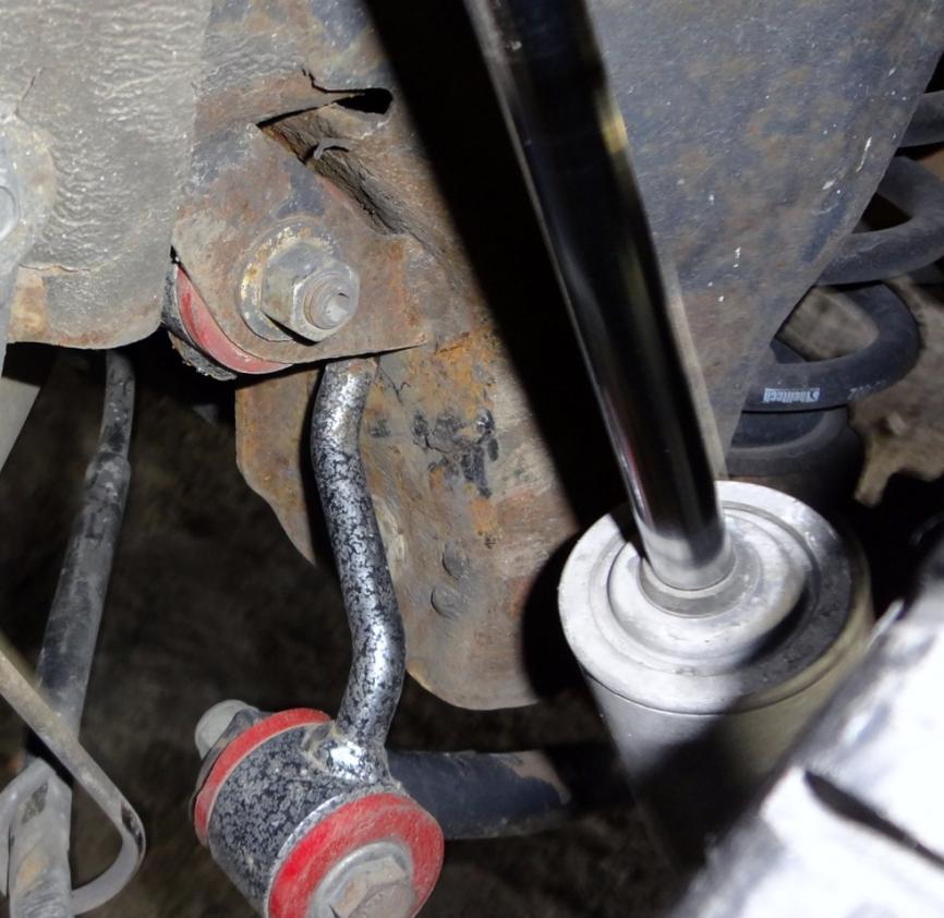

basically for the rear, support the rear end, pull the shocks, wiggle the springs out, wiggle them back in (see saw the rear end down on each side)

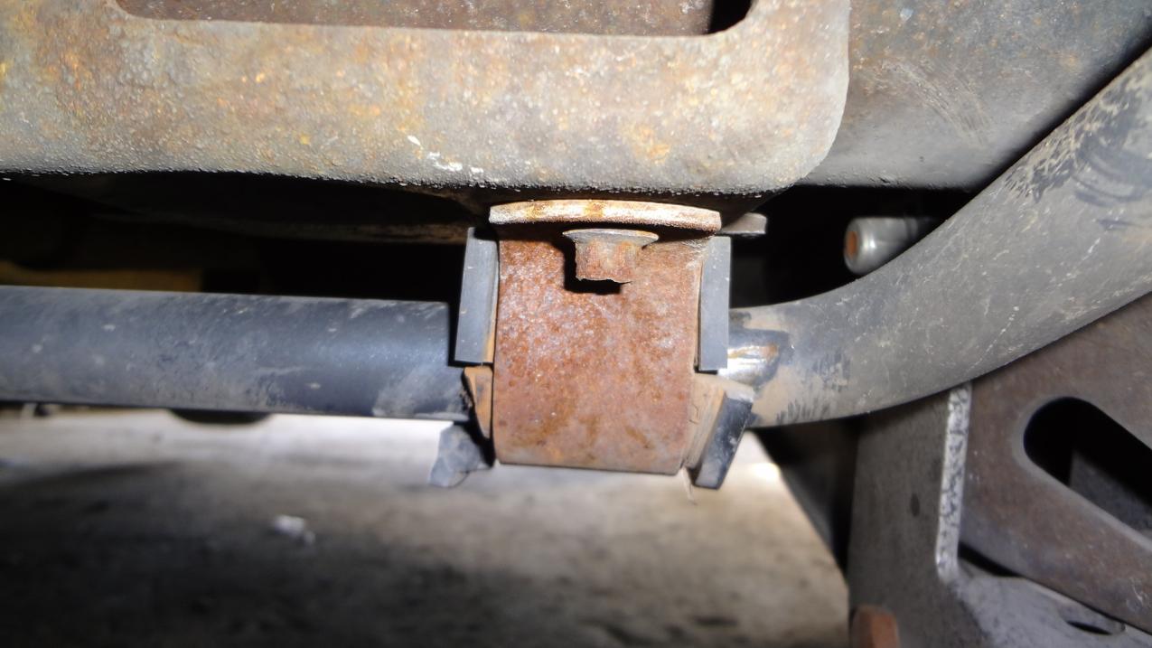

you can NOT support it by the sway bar, we had to move this under the pumpkin
make sure you re-use the OEM isolators (the rear springs come with some plastic parts I did not use, maybe Tony can chime in, they are in the box, in the pics)

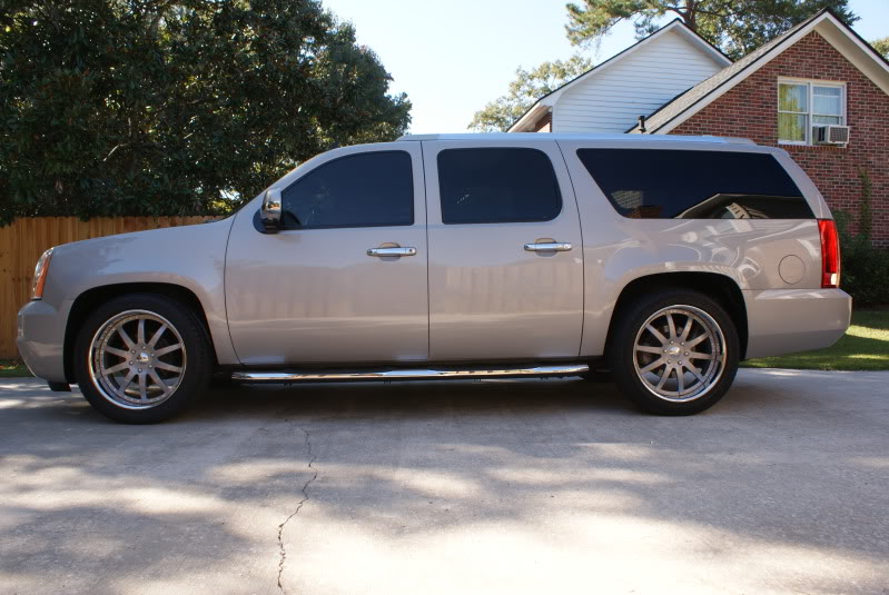

i set the adjustable strut up WAY to short, as you can see by the pics in the field. that severe drop is one 10mm & one 8mm ring.
my rims offset has the tire edge too far out, and it would have hit the fender lip.
i had the truck on a lift, and had to use a floor jack and a post about 3.5 feet tall to lift up on the bottom of the strut to get it out with the spindle intact.
in the pic at the gas station, and in the driveway, i put 3 more rings on the strut (a 10mm, and 2 8mm)

lets start with the rear end. You support the frame on jackstands and have to have the rear end hanging down then you just put th ejack under the rear end pump it so barly lifts rear end take off shocks put new shocks on but dont attach to axle yet but shock extender brackets on then let the floor jack down a little. SPrings pop right ou then put in new springs and jack up rear end and attach lower shocks. at most takes 1 hour.
the black spacers are 1 inch lifting spacers per side if someone doesnt want the full 4 inch drop. If your not using the rear spacers and have the full drop you need to cut the rear bumpstop bracket off the frame completly to get a good ride.
