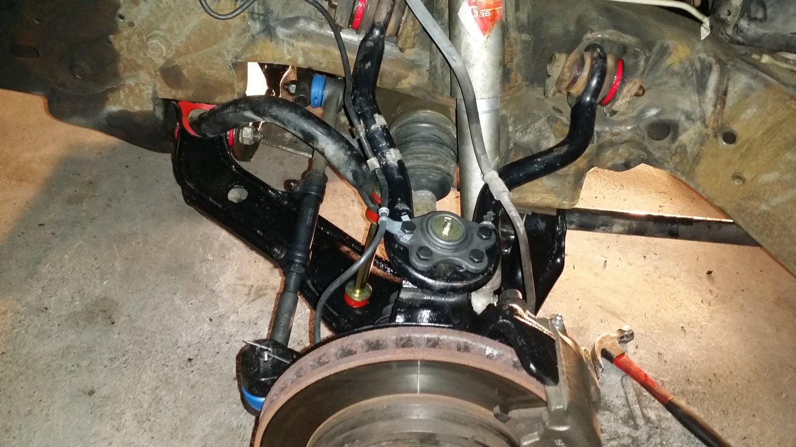

I found this post incredibly helpful. I just orderd my suspension parts, and plan to follow your step-by-step process to rebuild my front suspension (93 GMC K1500). I plan to remove and replace upper control arms & ball joints, install new LCA bushings & ball joints, remove and replace sway bar bushings & stabilizer rods, and remove and replace tie rods. Mine has bolt-on lower ball joints, so probably wont be as difficult to press in as yours.
I’m most concerned with
1) removal and installation of LCA bushings. Might try your sledgehammer technique.
2) whether I can get the torsion bars to separate from LCAs. I’m sure I’ll be removing the crossmember. If they’re rusted stuck, I might just have to leave them stuck and reinstall.
Feel like I’ve got a handle on the rest of it, though I’m sure it is harder than you made it seem.

Brother, I was successful! Thanks to your post – gave me confidence to tear into it. Took me four days to get it all done. I was able to separate the torsion bars – one was loose and separated easy. One was rusted solid – I knocked it around with a sledge hammer and was ready to give up – then I figured out how to get them to separate. I held the torsion bar vertically with the control arm end in the air, the other end pointed straight down into my garage floor, then dropped it from about six inches. With the weight of the control arm – it released about the third drop. Much easier than with a sledge hammer.
By far, the hardest part was getting the LCA bushings out. Wow. That took hours. I had a 20T press from Harbor Freight, and they still wouldn’t budge (I took the press back – I don’t think I was getting 20T of force). I saw videos of people burning the bushing out - not an option in my neighborhood. I used a drill to loosen the rubber bushings, then pressed out the inner sleeve with a balljoint press C-clamp. After getting the rubber out, I cut, drilled, and pounded the snot out of the sleeves until they released. Happy to say – reinstallation of the new bushings was a breeze – they went in really smooth. Had them in the freezer overnight, and used some motor oil.IMG_0604.JPG IMG_0647.JPG IMG_0649.JPG IMG_0650.JPG
The second hardest part was getting the rivets out for my LCA balljoints. I’ve got the stamped control arms with bolt-on balljoints. The rivets were rusted tight. I ended up having to drill the rivets all the way through to get them out.
After that, everything came apart and went back together with no major trouble. Got a lifetime alignment now from Firestone, all Moog parts from Rock Auto, and all is well.
