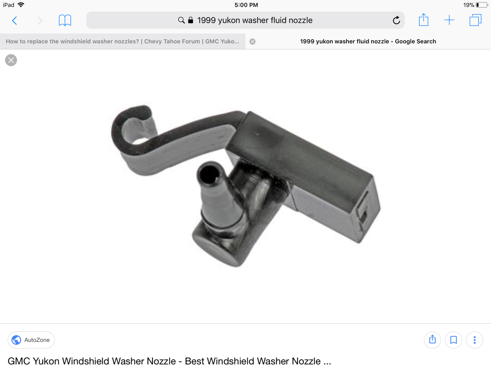

I ordered a new plastic windshield cowl (the piece under the wiper arms) because mine was cracked and broken in several places. Removing the wiper arms and such seems pretty easy, but how do the washer nozzles come out of the cowl? I've watched several video tutorials but none mention this step.

Do you have these, they just clip in from front to back from the under side so removal would be pushing out from back towards the front

Most likely those are what I have. Any tips on replacing the plastic cowl? Looks pretty straightforward. I guess some people have trouble getting the wiper arms off. I was able to pop the clips with my finger, so that shouldn’t be an issue.
