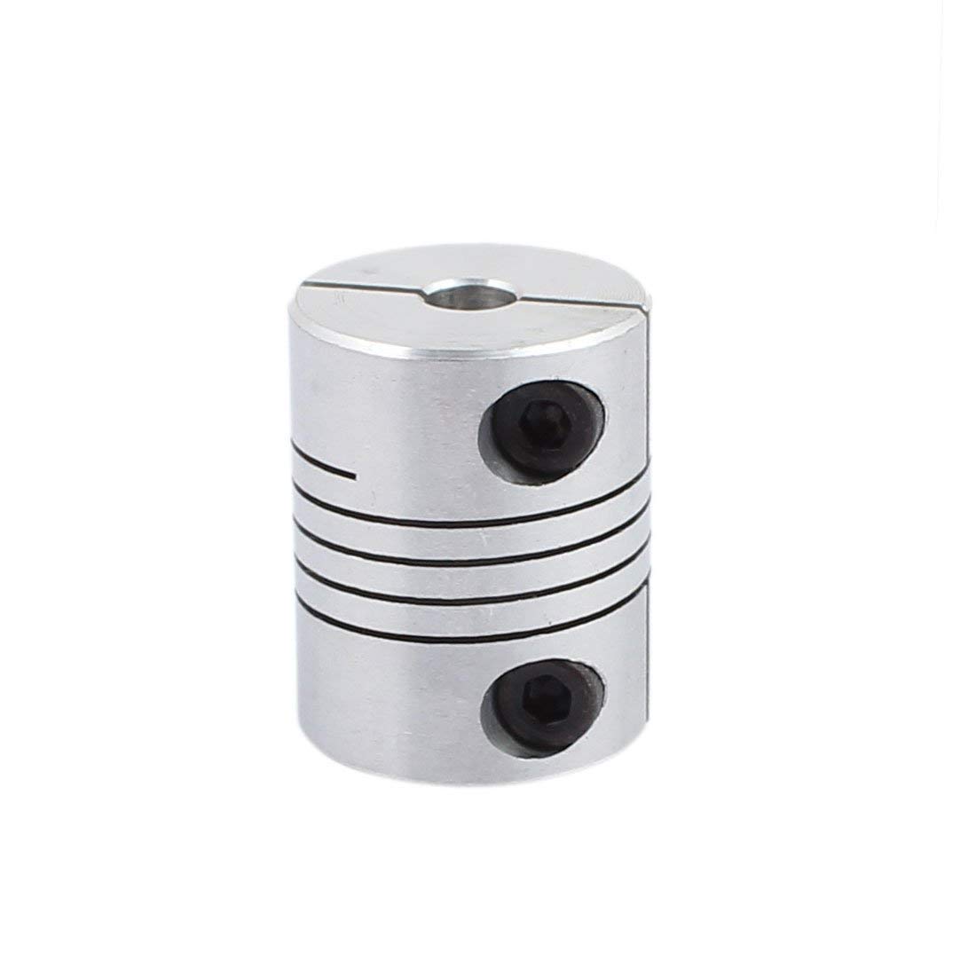

Here are the FTS ride height rod extensions. You cut the stock rods then lock in the desired position with set screws. They come two in a bag as a set.
