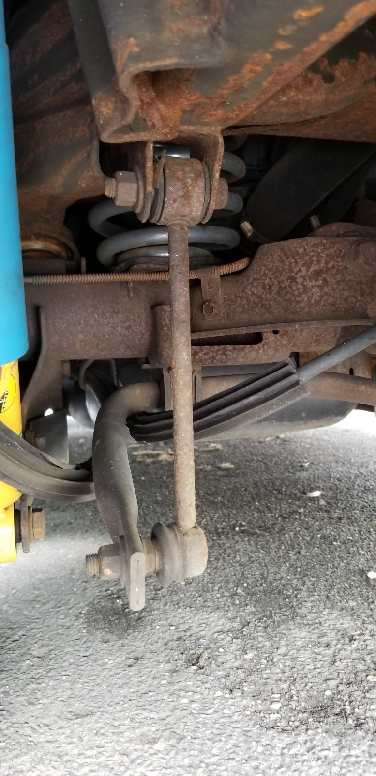

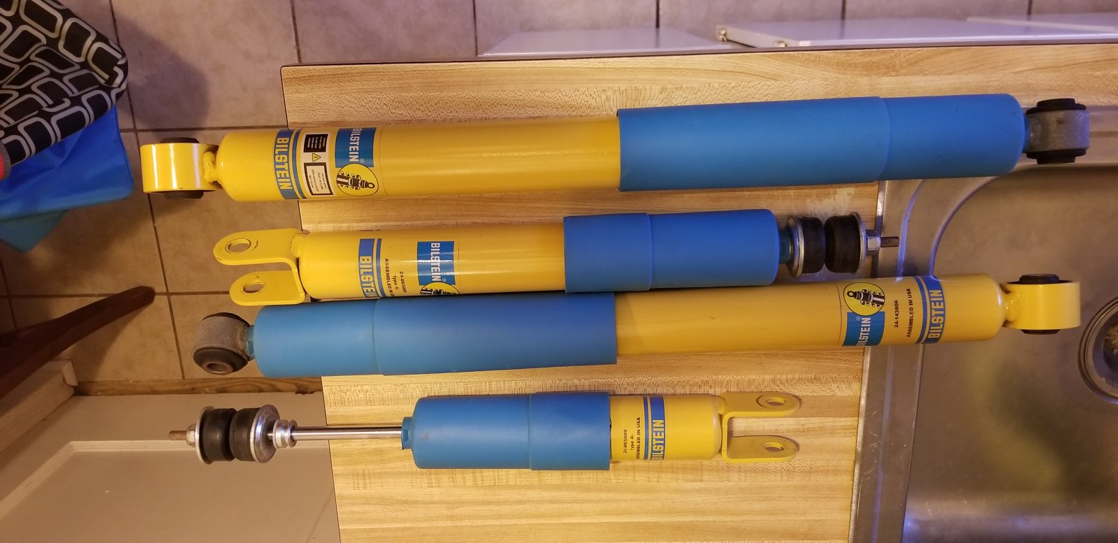

When I bought my 04 LT last year it already had Bilstein 5100's in the front and 4600's in the back. I dont know how old they are as the truck had several owners. The truck has a bounce but what I dislike the most is the side to side sway on the freeway and over bumps. Its pretty floaty and has a body roll.
The truck has new sway bar end links as well as new inner and outer tie rods and an alignment.
I am right on the brink of needing new tires
Will a new set of 5100's fix this problem? Are there other, smaller suspension parts that would fix the issue before going for new shocks? Thanks.

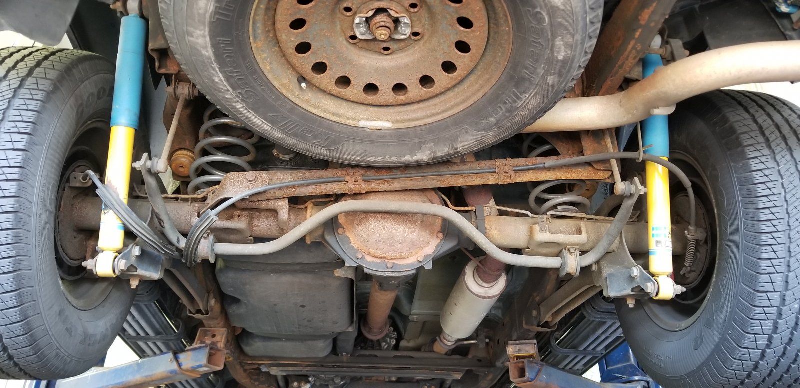

Shocks probably won’t stop swaying. There’s a few suspension and steering parts that need to be inspected though. It all works together. Sway bars, end links and bushings, tie rods, pitman arm, idler arm & bracket, ball joints.[/
I just replaced all my suspension everything you can imagine except the actual sway bar and rear sway bar links

I’m starting to think my shocks have gotten bad since I’m on a 2/4 drop with Monroe shocks all round
