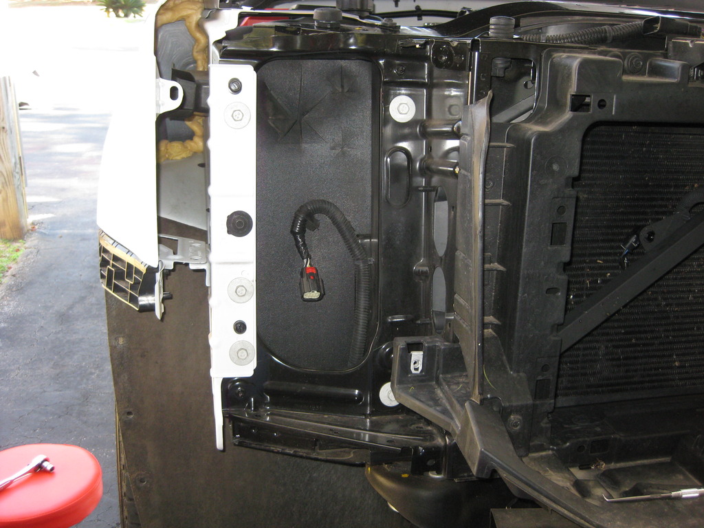

Unfortunately, there's no way around it. The bumper has to come off to remove the headlights. There are a total of four bolts that hold the headlight in. The two obvious ones under the hood and these two.
Once removed, the headlight pulls straight out.

Are you replacing the headlight housings? To change a bulb you just remove the air intake box. There are a bunch of threads here that show you how. Also, HIR is pretty old tech, definitely won't match the OEM HID or aftermarket LED colour temp. Still, curious toes what how they look. Do you have any pics?

Not replacing them. Had the bumper off to do the Denali grille and thought it would be a good opportunity to show what's needed to remove the headlights in case anyone ever has to.
