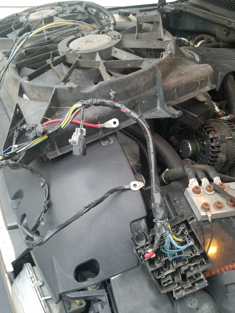

I installed E-fans on my 2001

I am going to be starting the e-fan upgrade on my 2004 Tahoe shortly and was wondering where I get the pins that I need to put in the connector.
