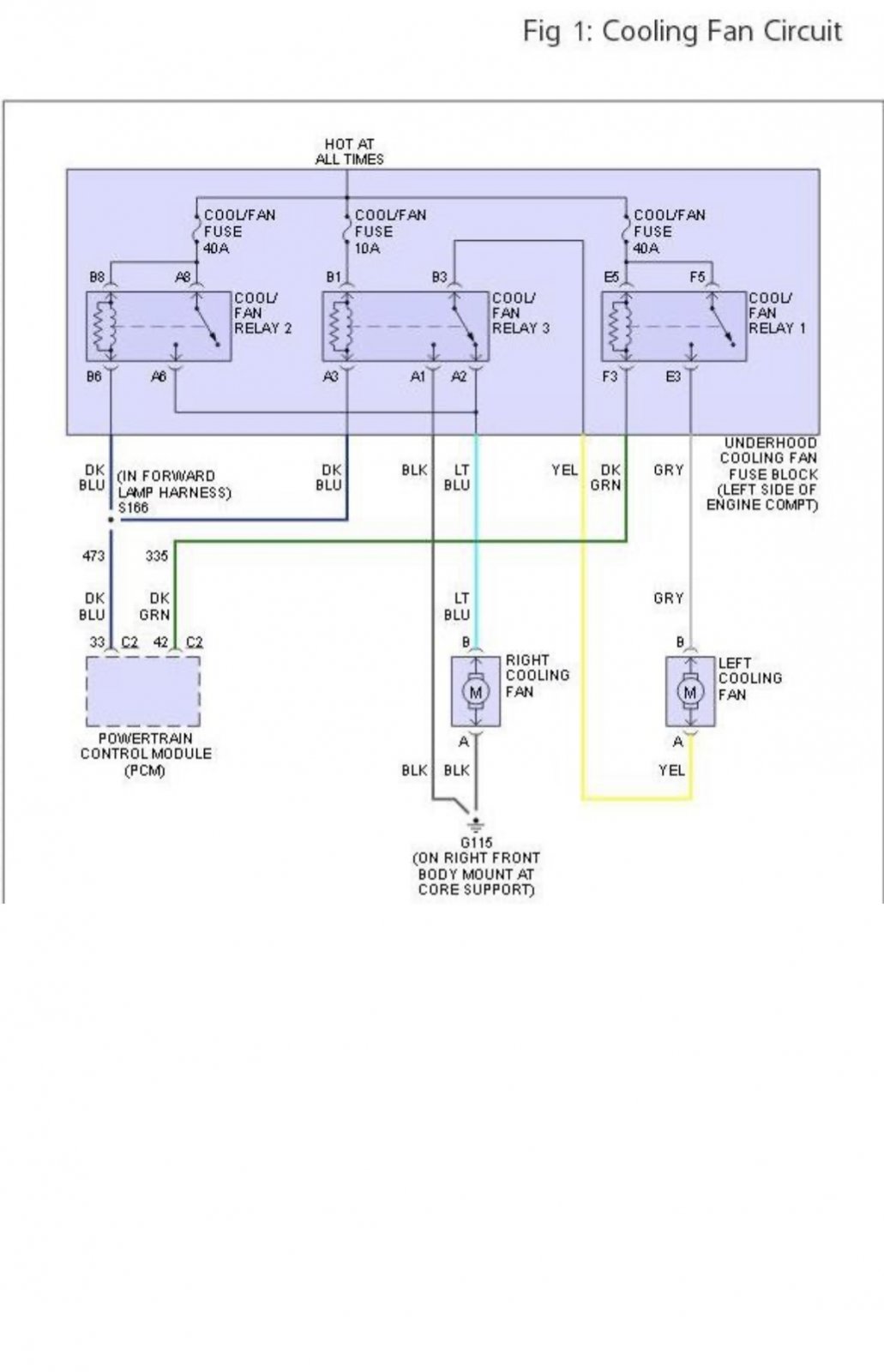

My 01 wiring Dia for the HVAC controls says that Pin #43 on the Red side is the relay control for the A/C clutch, and it is a negative trigger. I'm going to look into this today to verify that it's correct. If it is, then the extra relay isn't needed when using the OEM harness.
livingez_123
Feb 18, 2013
1,798
113
Sandy, OR

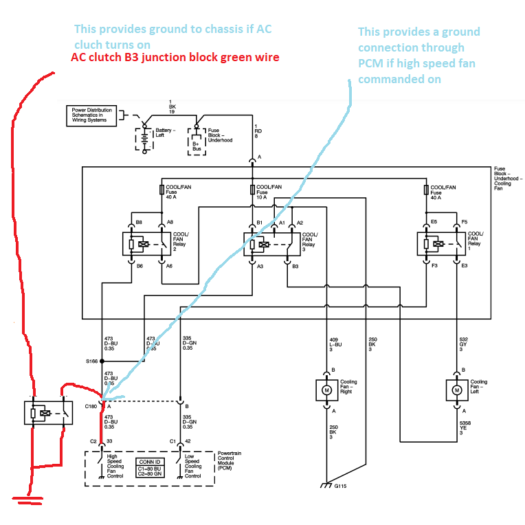

As I found out the hard way, you can't tie into the #43 pin on the red connector. If you do, you will have a dead battery in the morning. It energises a relay up in the PDC under the hood, and I didn't notice it right away. Now I have an extra relay for the AC trigger.
I also am having a problem with my fans not coming on the low speed. I'm having the dealer see if they can update my ECM in the morning.
livingez_123
Feb 18, 2013
1,798
113
Sandy, OR
Well the dealer showed me today that my ECM is current, and no updates are available. So, I'm not sure what to do next. the fans are wired correctly, the ac fan works, but no signal from the ECM to trigger the low speed fans. I guess maybe find a core ECM and start over, or just sell my Diablo Trinity and go with EFI live and have BlackBear tune it.

Installed OEM fans from a 2005 Silver. Used LS1 wiring harness (BB doesn't sell them currently).
Got a tune from a local, reputable shop.
The AC fan wont come on when I turn on the AC.
Engine cooling fan works great.
What gives?

Start checking connections and voltage on ls1 harness. Its a simple wiring and sometimes the connections suck. My connections suck so bad they burnt up the relay bases and 4 relays. I suggest all connections be soldered to limit heat with 30 amp continuous.
