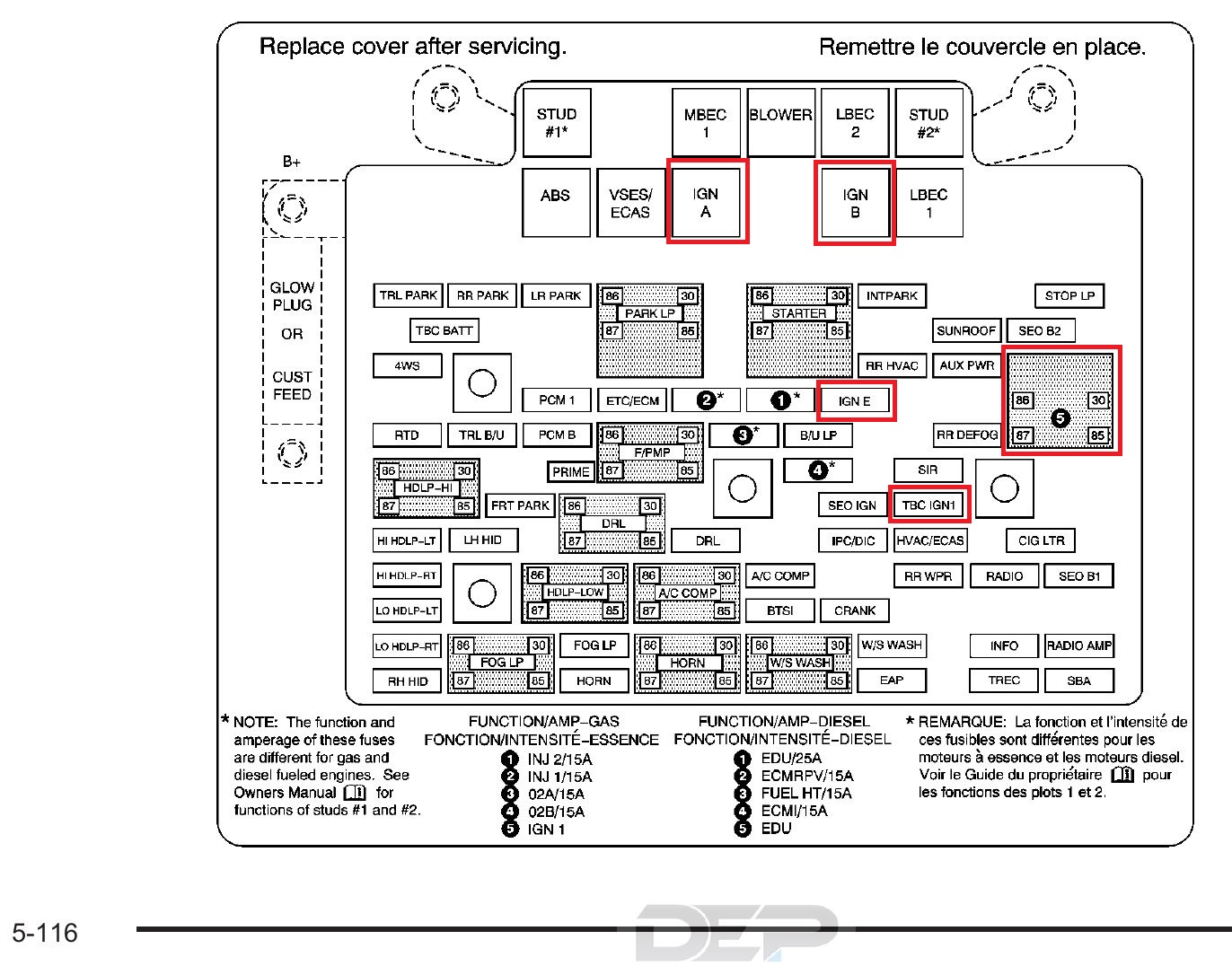

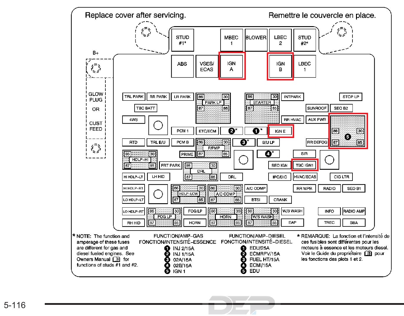

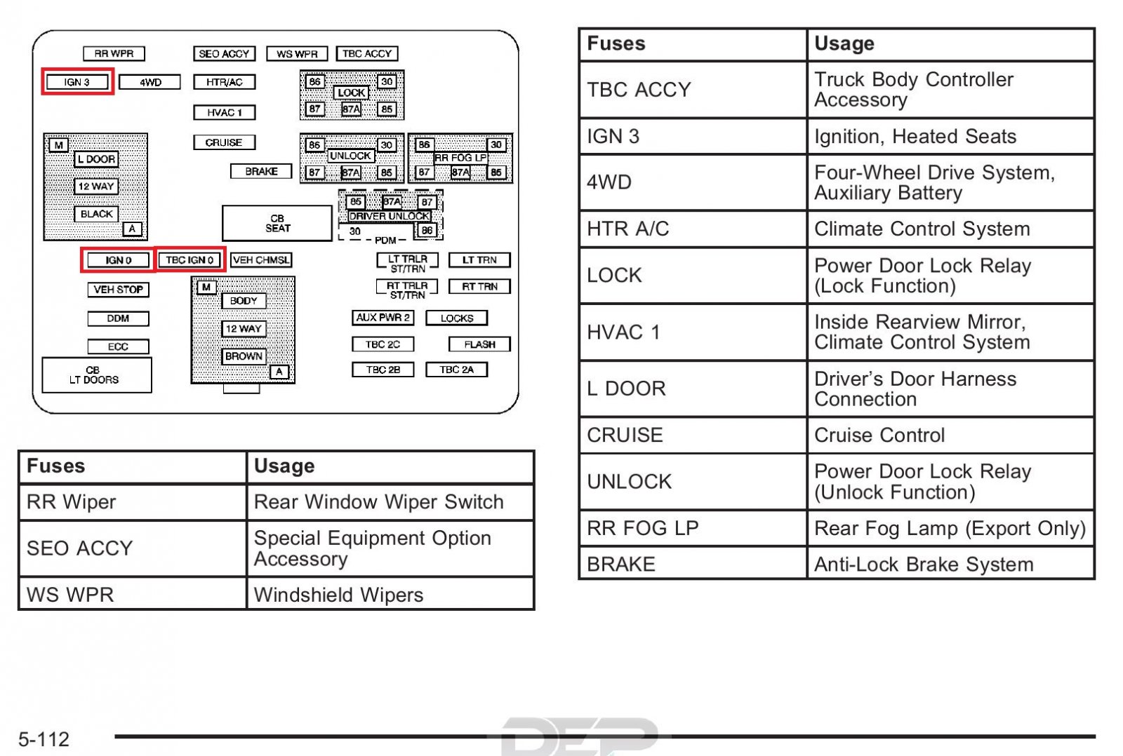

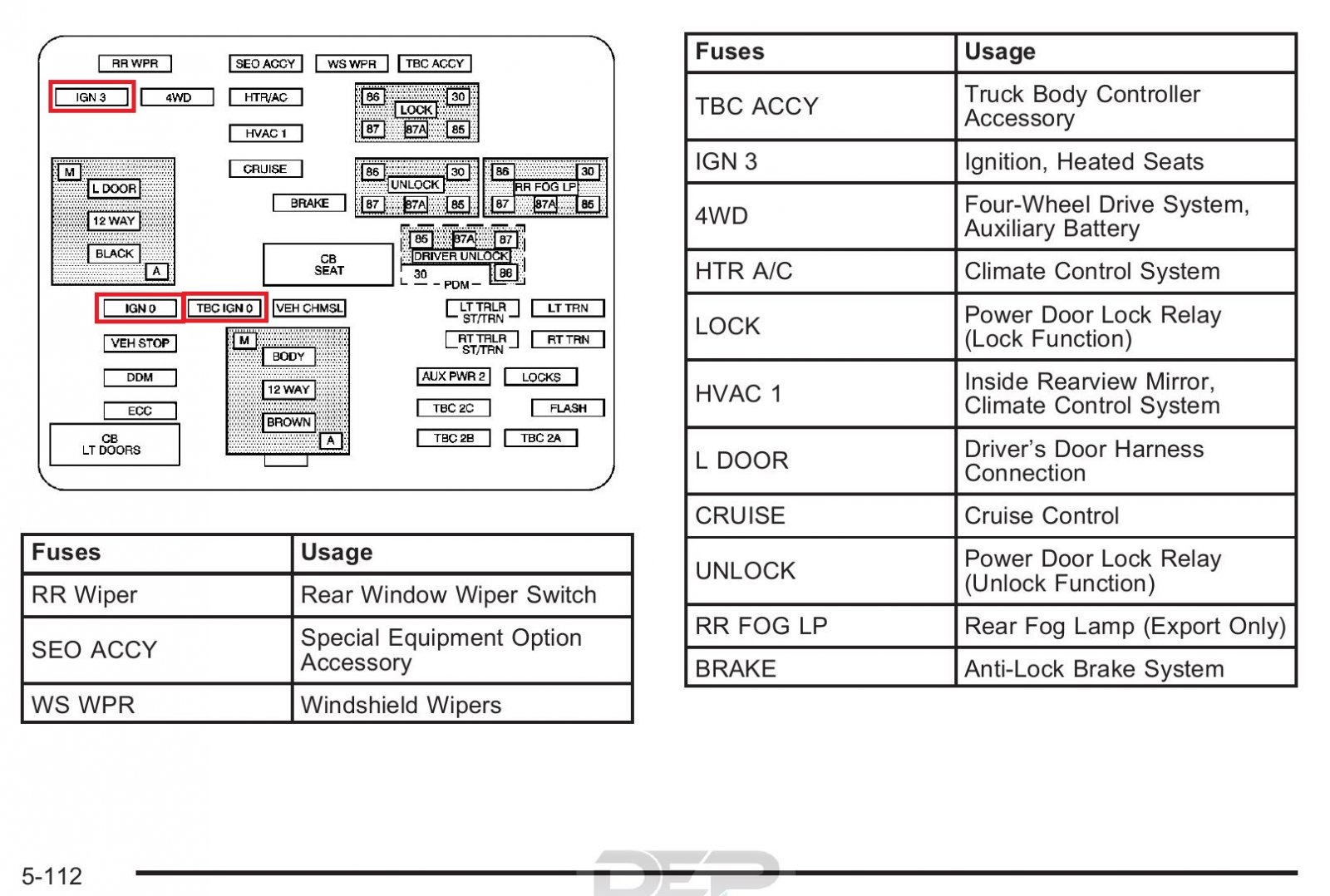

The owner's manual could be helpful; if you don't have one, download it here:
or https://www.chevrolet.com/support/vehicle/manuals-guides
I've indicated a few of the IGN fuses and relays, so you may want to start checking them for pin fitment and blown or defective fuses.
Instrument Panel Fuse Block (left side of the instrument panel; open the driver's door and pull the cover off):
Underhood fuse block:
That might not even be all of them, but gives you a place to start. Use a voltmeter to test the mini fuses using the integrated test points, but also pull the fuses to verify the legs are intact and fit tight into the connections.

Fless - That's awesome! All good information. I am going to dig into those fuse panels when I get home this afternoon. Although I have visually checked all of those fuses, I haven't checked all of them with my meter. So that would be good to do. I have had fuses that looked good and tested bad before.
One question I had for you. I suspect it's entirely possible I may have a defective fuse panel. I would think the way to test this would be to check from b+ to the fuse posts to make sure I am getting voltage to the fuses themselves. In my profession ( Automation Controls ) I work a lot with low volt electrical. In my mind, I should only have power to one side of every fuse. that being said, I ran across a few posts saying to check and make sure I had voltage to BOTH fuse posts on certain fuses. I think it was the ECU fuse I was supposed to have voltage to BOTH sides of the fuse. This dosen't make any sense to me, but I saw this on more than one post. Another thing, i was expecting to read 12V POSITIVE to each fuse post getting perhaps a common or negative from the body / ground and positive 12VDC at the fuse post. I suppose this is wrong, they run common through all the fuses. This is why you grab positive from B+ and test with your common lead from the meter to each fuse post.. Maybe I am misunderstanding what they are saying about having 12V on both fuse posts for the ECU fuse.. How should I properly be testing these fuses? Which fuses should have power on both posts from B+?
