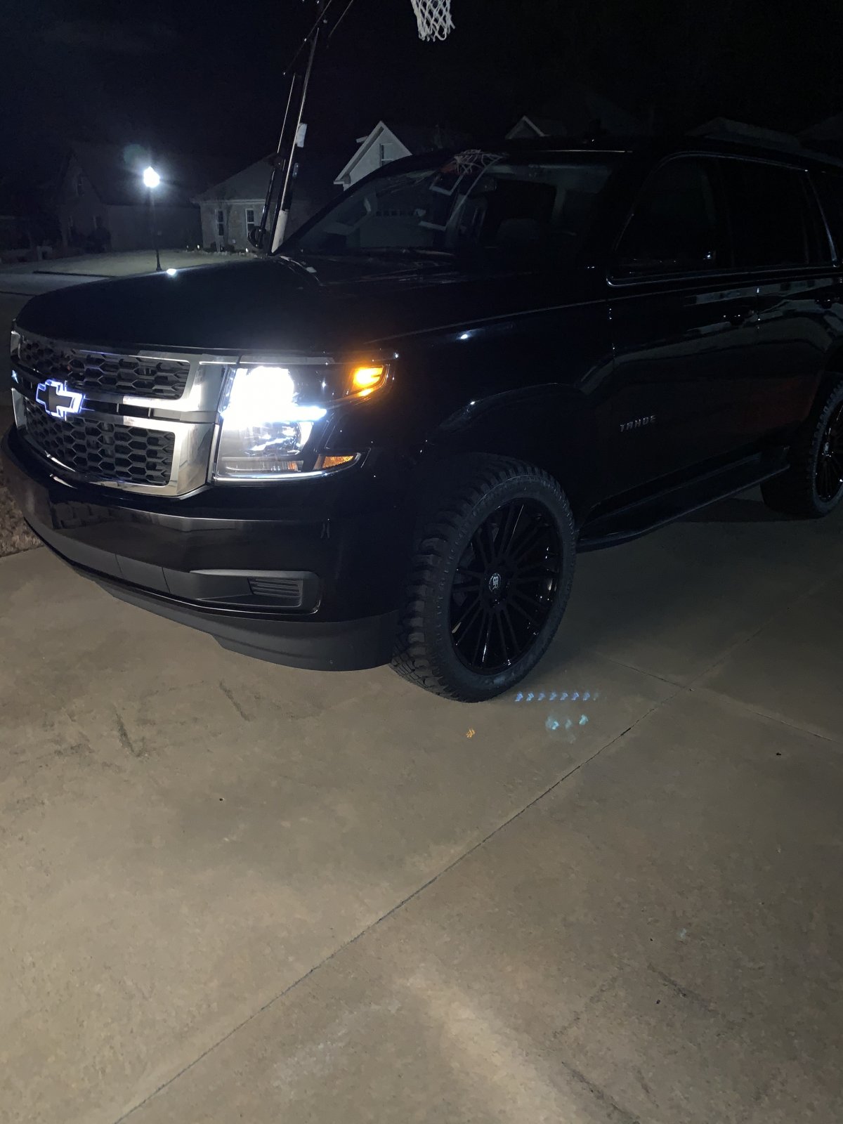

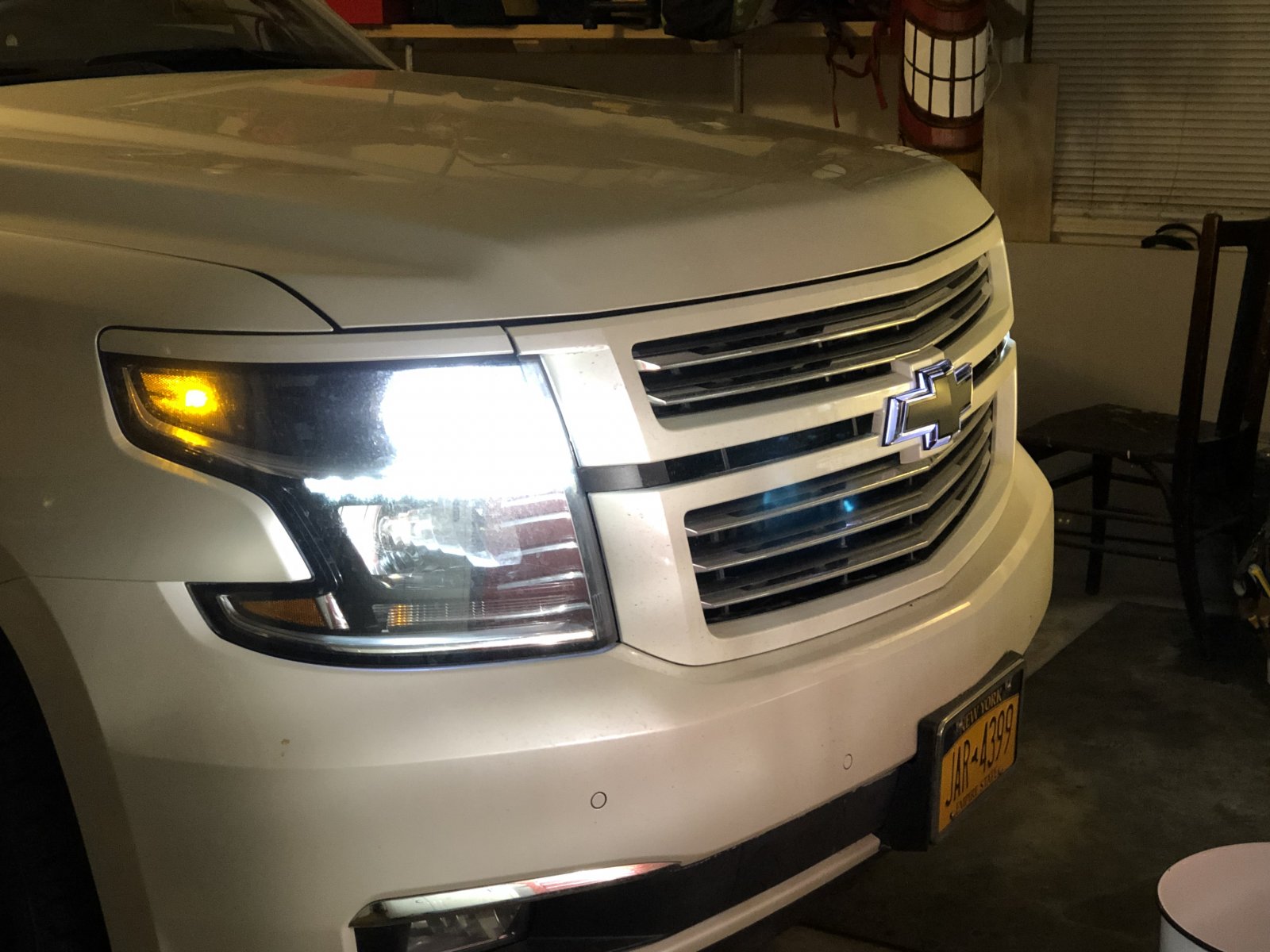

That DOES look great. What a great idea- We've come so far from the days of the simple brushed billet aluminum, or custom painted emblems. Very nice.
