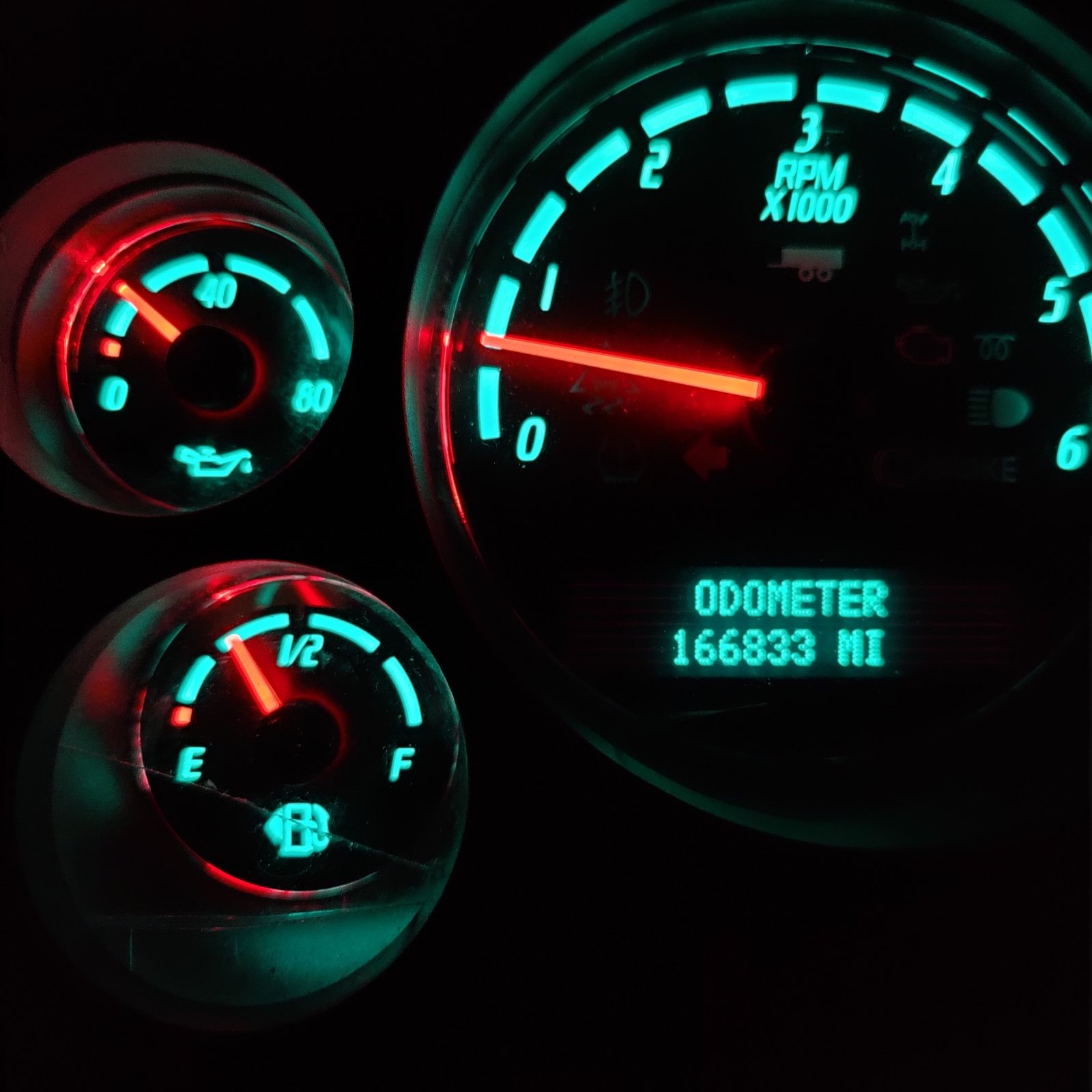

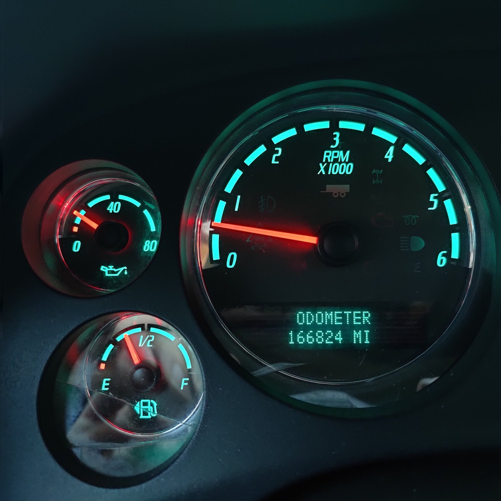

Just sayin... weird stuff started happening when my oil pickup o-ring went bye bye. Had, stabilitrack, and multiple codes thrown, CEL that came, then went...
If you're having any low oil pressure problems, I strongly recommend taking a look at what happened to me. Pics at the link below, and I've got multiple posts with video of my dash lights going off. After I change the $10 part, no problems. We're about a year after and still going strong. It's a stupid easy fix, but one dealership the guy that sold me the rig put 2k into the engine without fixing it, and the dealership I took it to gave me a line about of garbage until I decided to go in a hunch since it cost me only a rubber grommet and new oil pan filter. Instead of I don't know how many more hundreds and maybe thousands, I'm fixed with about $50 of parts and a little (a lot, for me) of labor.
