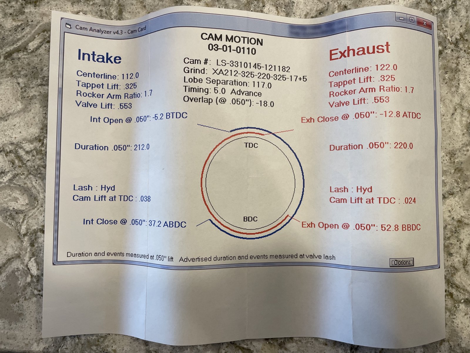

Much appreciated everyone. I’m out of my wheelhouse of knowledge on this one but catching up as best I can.
CM did send me over their package they suggested. I’m attaching for reference and feedback.

You are welcome to your opinion and I won't try to change your mind, so I'm responding here for the benefit of the OP so that he has the complete picture. I stand by my analysis.
1/ The 6.0 has a significantly different head design than the 6.2 (e.g. cathedral intake ports vs rectangular) which means the flow dynamics are different. So what applies to the 6.0 doesn't necessarily apply to the 6.2. Most of the advantage that the 6.2 has comes from its head and associated intake design. This is also why my first and second cam swaps didn't generate the gains of my third - I was buying cams that were optimized for the cathedral port engines and while compatible with the 6.2, they were not optimized for it. For my third, I bought a 6.2-specific cam.
2/ For larger than stock cams, you end up having to limit VVT operation to about 12-15 degrees of total rotation (~5 degrees advance and 8-10 degrees retard) so its benefits diminish the further you get from a stock cam. The benefit to VVT on a stock cam is about 15 lb ft on the low end, and decreases as you progressively limit its range of operation. There is a sweet spot between VVT effect and cam "size" so that is the more salient question, I believe.
3/ In a pushrod engine, there is no way to vary the intake and exhaust cam rotation independently. On DOHC engine designs, it is possible to vary them separately which leads to much greater gains in both power and efficiency, which is why it became so common in the market and became part of the marketing and differentiation strategy of other brands - you could FEEL the difference. But on a pushrod V8, I believe its benefit is more marketing than reality and benefits fuel economy more than driving experience.
To each their own, but for my needs and if I had it to do all over again, I would still not worry about retaining VVT on a 6.2.
