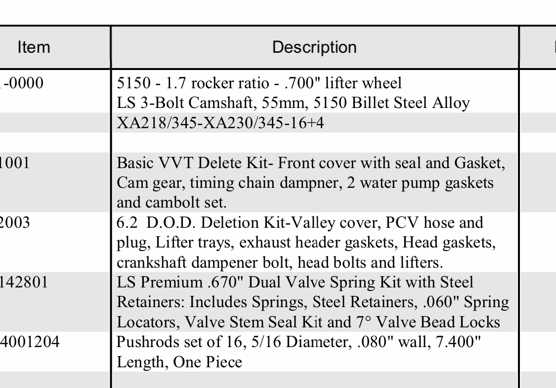

So I’m pulling the trigger this week on my cam package but decided I’m going to go ahead and do a supercharger at the same time:cool:
I believe I’m going with the tsp cam package linked in my 1st post on this thread with long tube headers
Guessing I’ll go with the maggy tvs1900 since they stopped making the tvs 2600 for my 2011 Yukon Denali :mad:
Anyone by chance have a combo suggestion or feedback?

Bumping this thread in hopes of a response. I spoke to TSP again about a cam package that will play nice with the supercharger getting installed at the same time.
They’re really pushing me it seems to do a VVT delete. Below is their suggestion:
We would recommend a dod delete and vvt Delete and our stage 1 l92 cam. Will give a great boost in performance. Here are the links
Dod delete
Add 6.2 head gaskets
Add head studs
Add l92 valley
Add 16 lifters
Leave rest as is
Vvt Delete
Leave as is
Cam kit
Add stg1 216/228 cam
Add gm 0303 oil pump
Leave rest as is
I plan on having any needed maintenance refreshing, steering rack and 2/3 suspension drop done while they have the truck for the cam package the SC install. Leaning towards BB for the updated tune as well.
Thanks again for any info guys in advance

So that cam is 'compatible' with the 6.2, which is not the same thing as optimized for it. I learned this lesson with my own cam swap a couple of years ago. The flow dynamics of the heads on the 6.2 are significantly different and the exhaust system is different. You will leave power on the table with that setup. I deleted VVT on mine and haven't missed it but others say they're glad they kept it. With a supercharger though, I don't think you'll miss VVT one iota.
If I were in your shoes, I would give Cam Motion a call and tell them what you have and what you want to do. They can spec a cam for you that's dead nuts on and optimized for your future setup.
