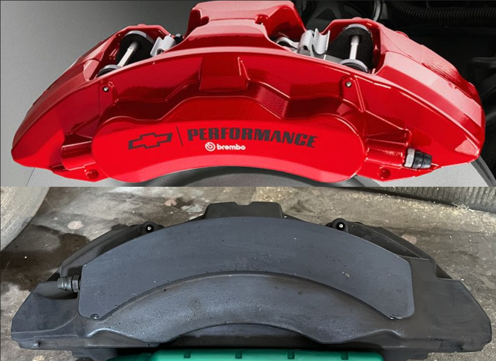

I did this swap over the weekend. As far as major upgrades, this was as easy as it gets. My only difficulty was getting the old banjo bolt out of the line... Someone had jammed the wrong size crush washer in there, and took me a while to get the bolt out...
Two questions for the guys who have done it. Have you noticed the brake line extending to almost maximum stretch when you turn the wheel to full lock? Has anyone run the stock 2007 Escalade wheels with these brakes? Looks like it clears by maybe 1/16" of an inch from the spokes.
Thanks guys for this thread

Thanks for the heads up on the brake line stretch, I didn't think to check that.
My 2011 Yukon Denali factory 20" seven spokes (similar to those esky wheels) had at least 1/16" clearance on the test fit. Unfortunately, I didn't account for spacing the caliper to center on the rotor, which of course caused contact with the wheel, so I need to order some spacers.

Brief update: The '07 Escalade wheels clear the calipers by the skin of their teeth, even with the centering spacers (probably 1/16" or less.) At some point I might get the later model wheels, but for now, they work.
I'll keep monitoring the hoses and report if I notice anything.
Thanks.
