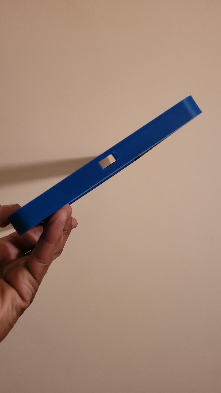

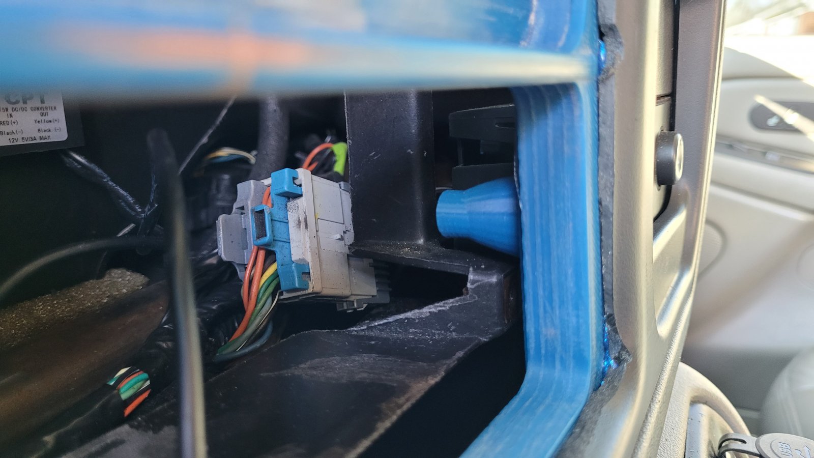

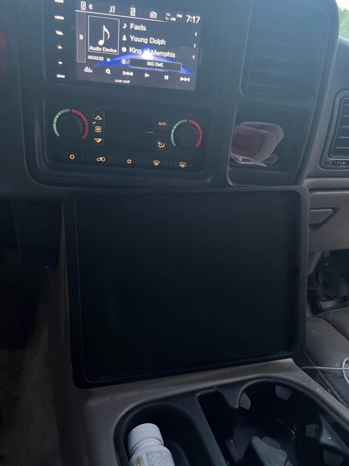

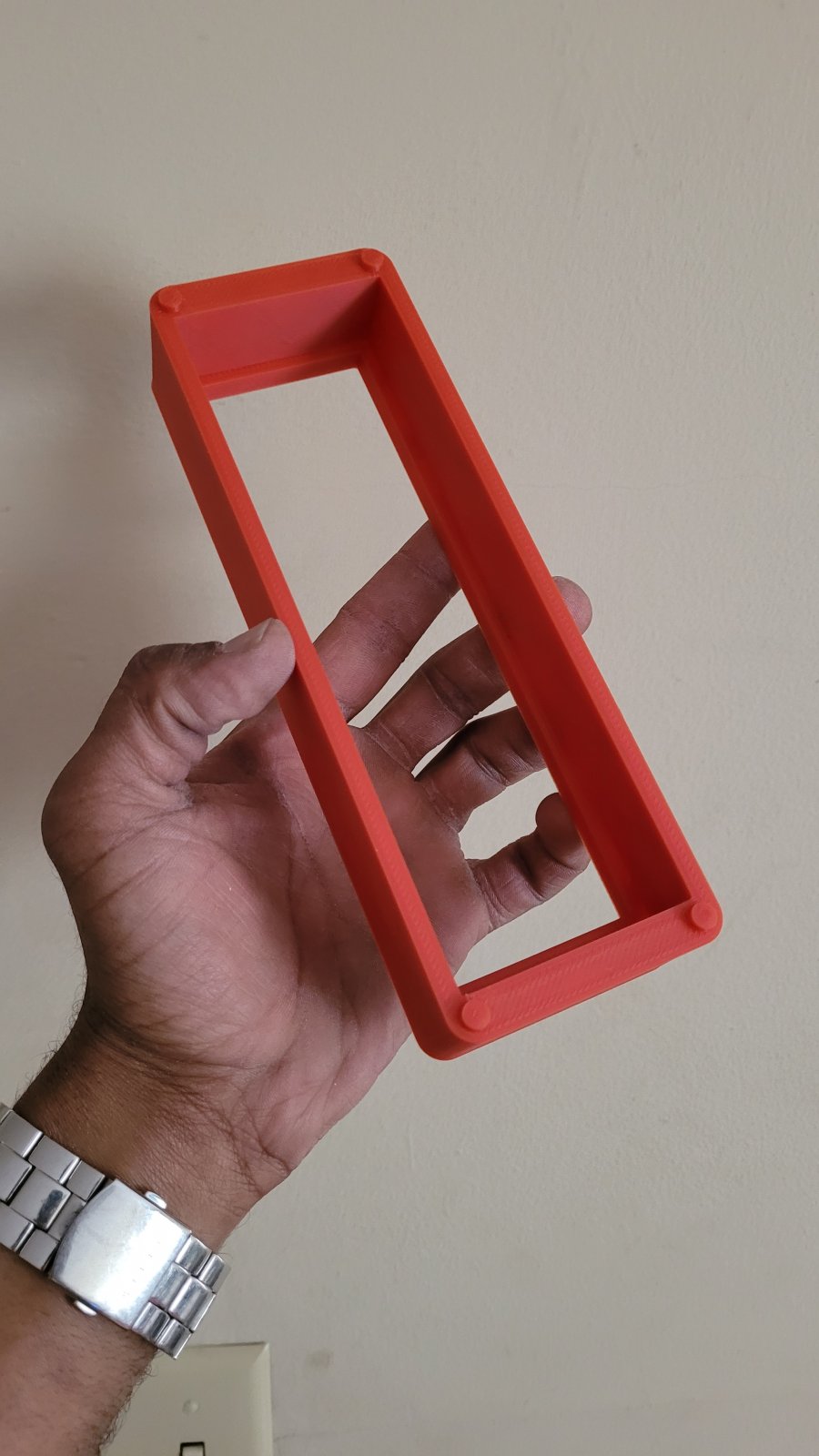

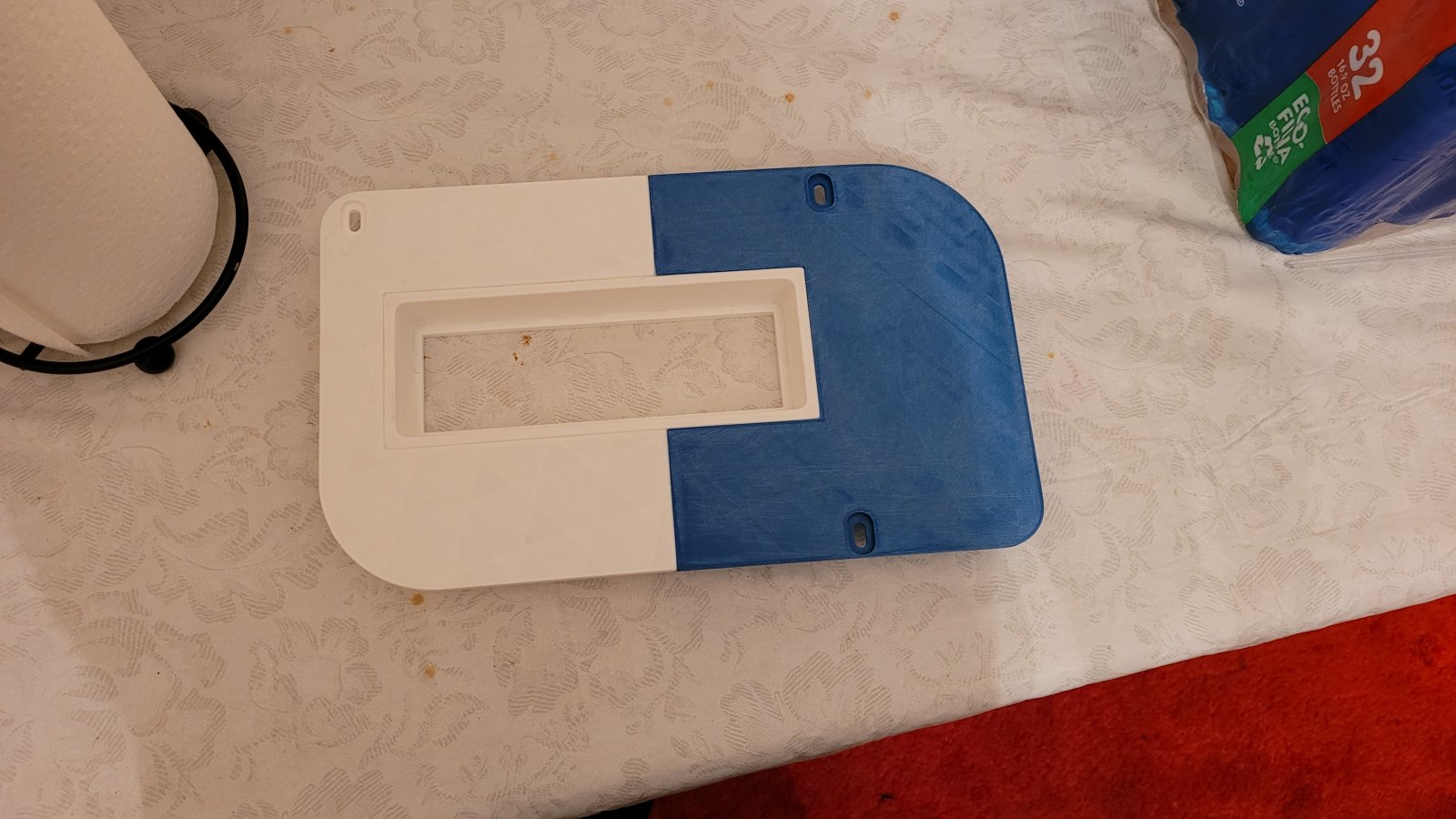

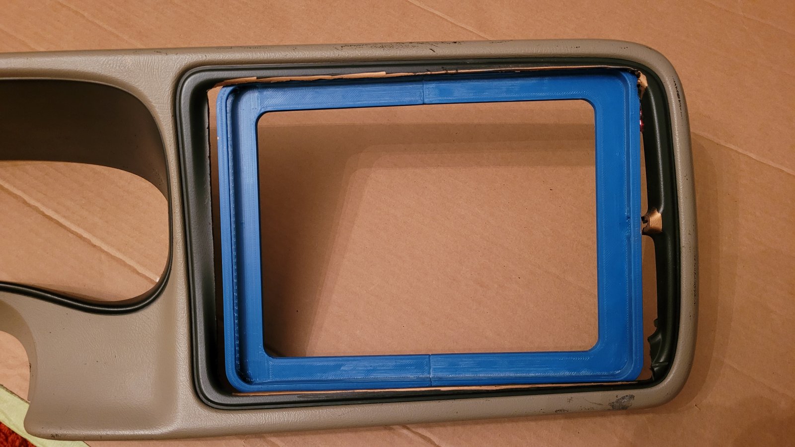

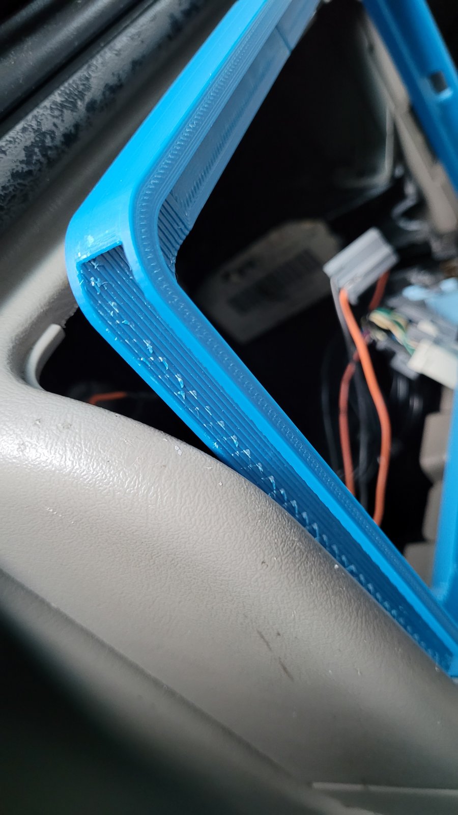

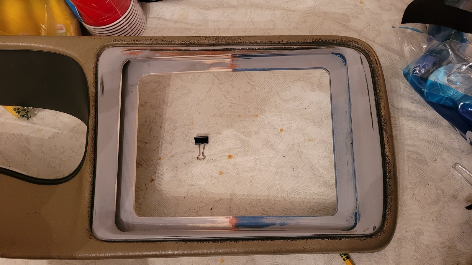

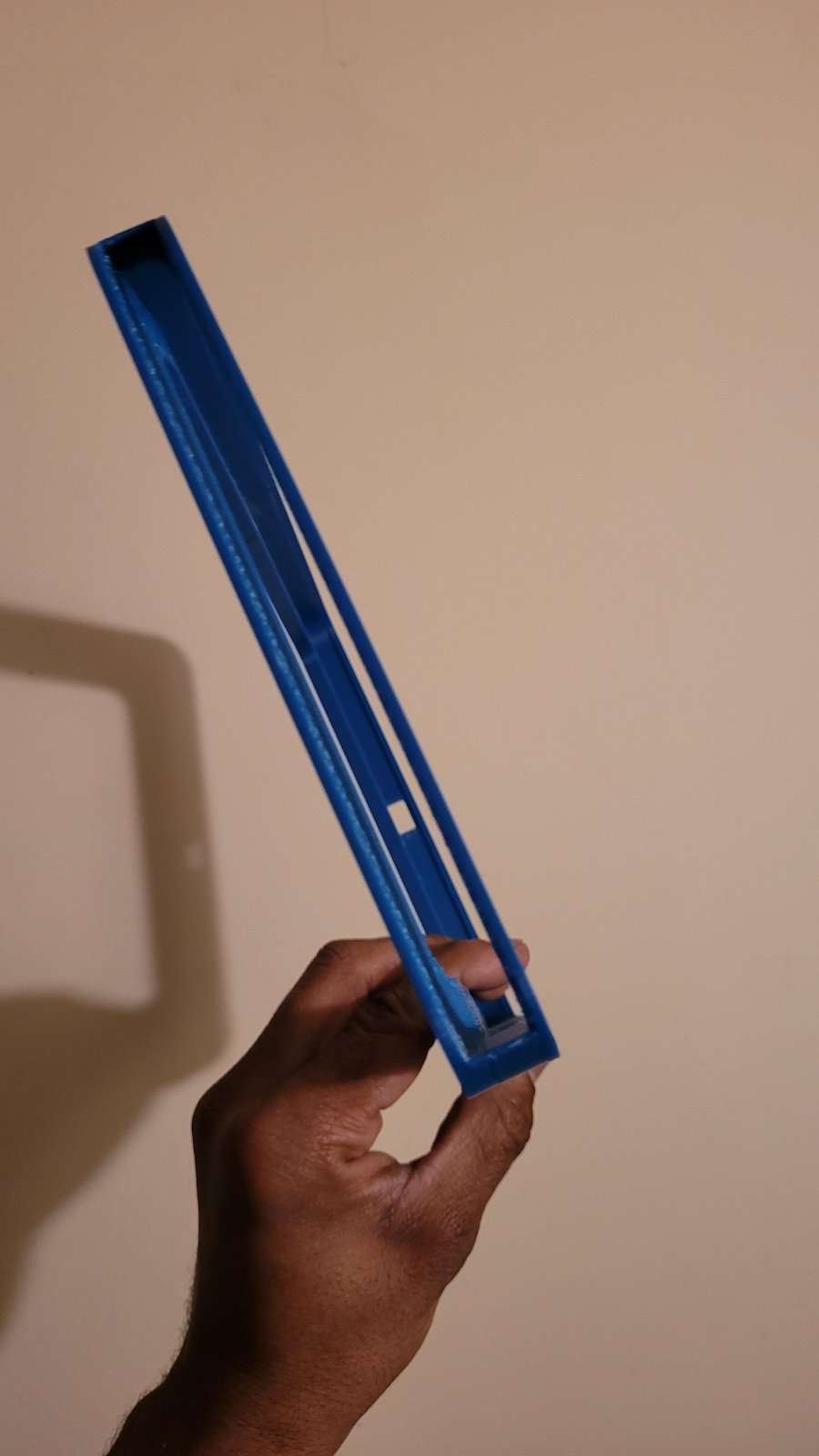

I 3d printed a bracket to hold the ac bracket in place. I'll post a pic of it in a Lil while.
C
CheatCodeSlim
Jul 12, 2021
50
63

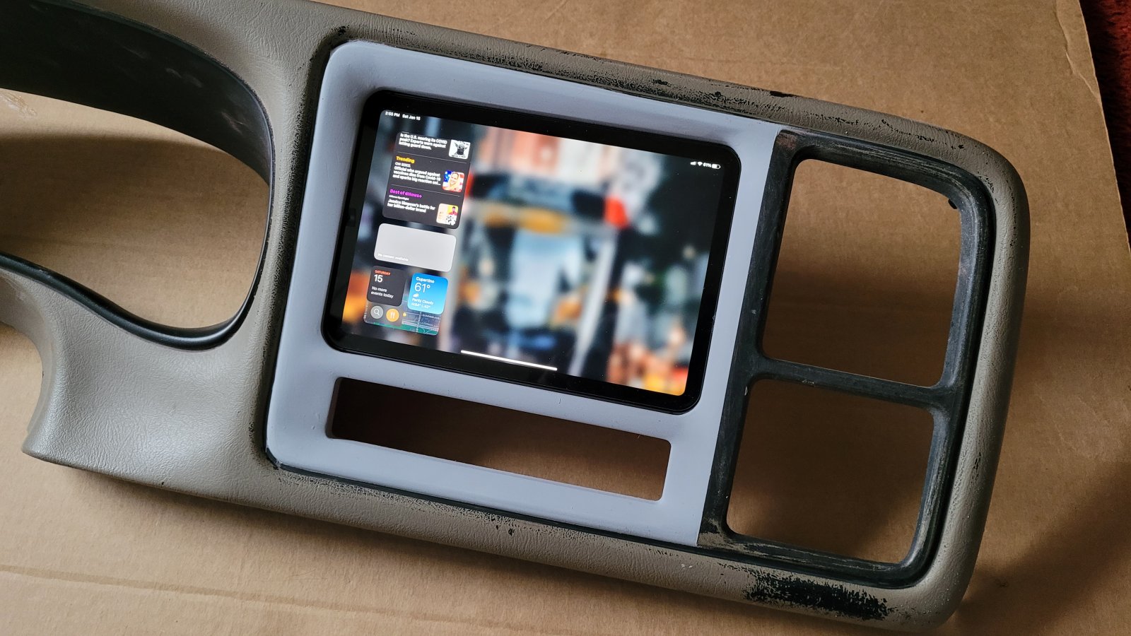

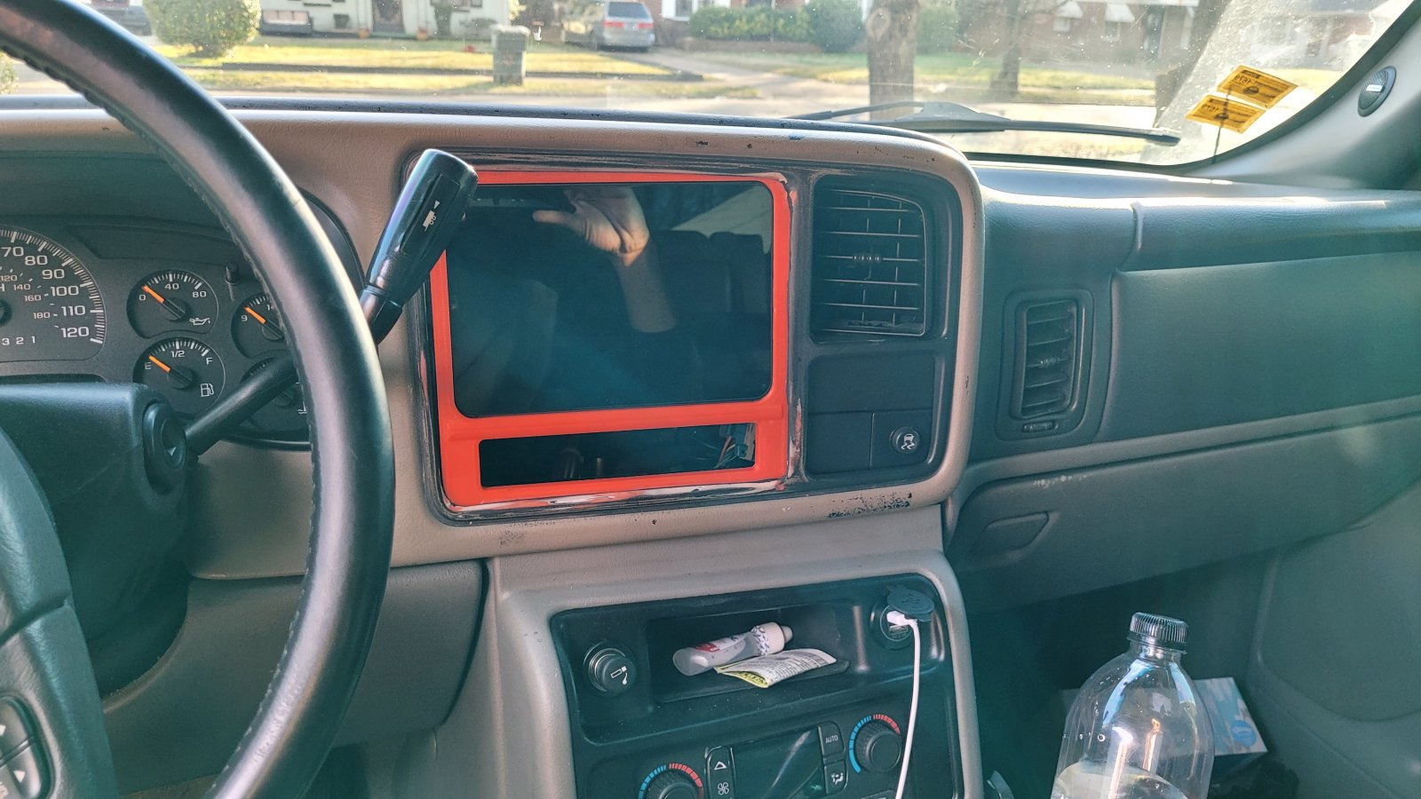

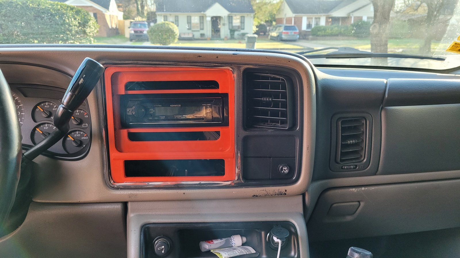

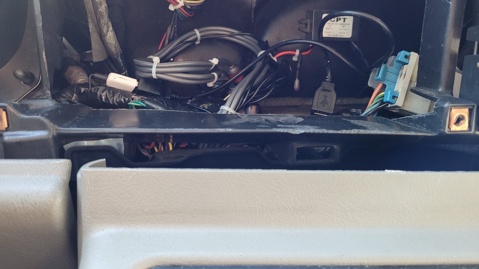

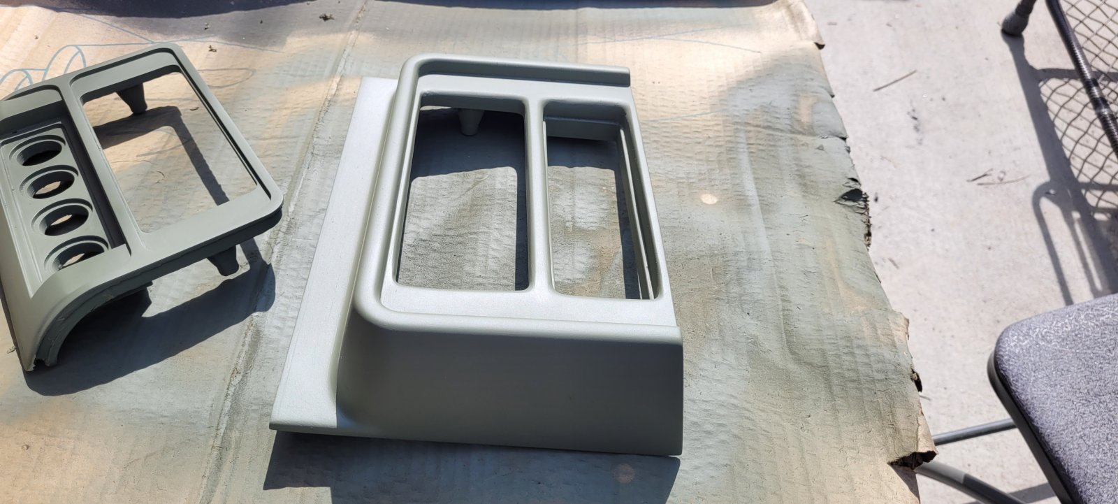

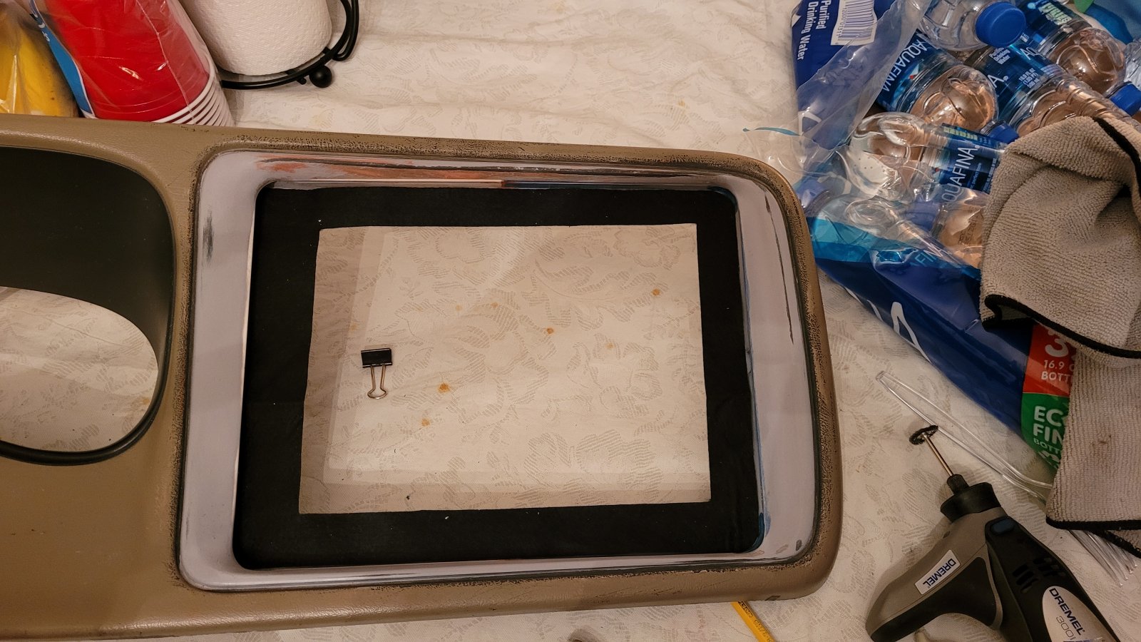

I did away with the old charging port and installed a dual USB one. The black paint on both the dash bezel and the lower ax bracket is just PlastiDip for the time being.
By all means, let me know what you guys think.

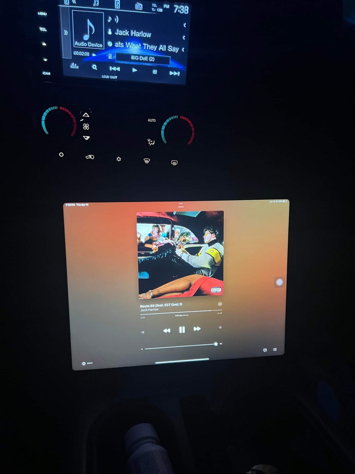

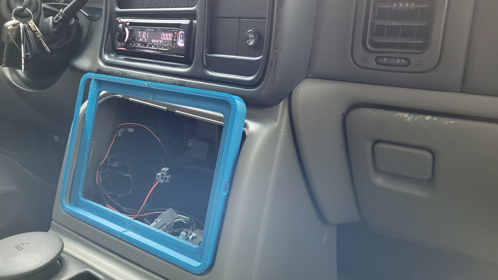

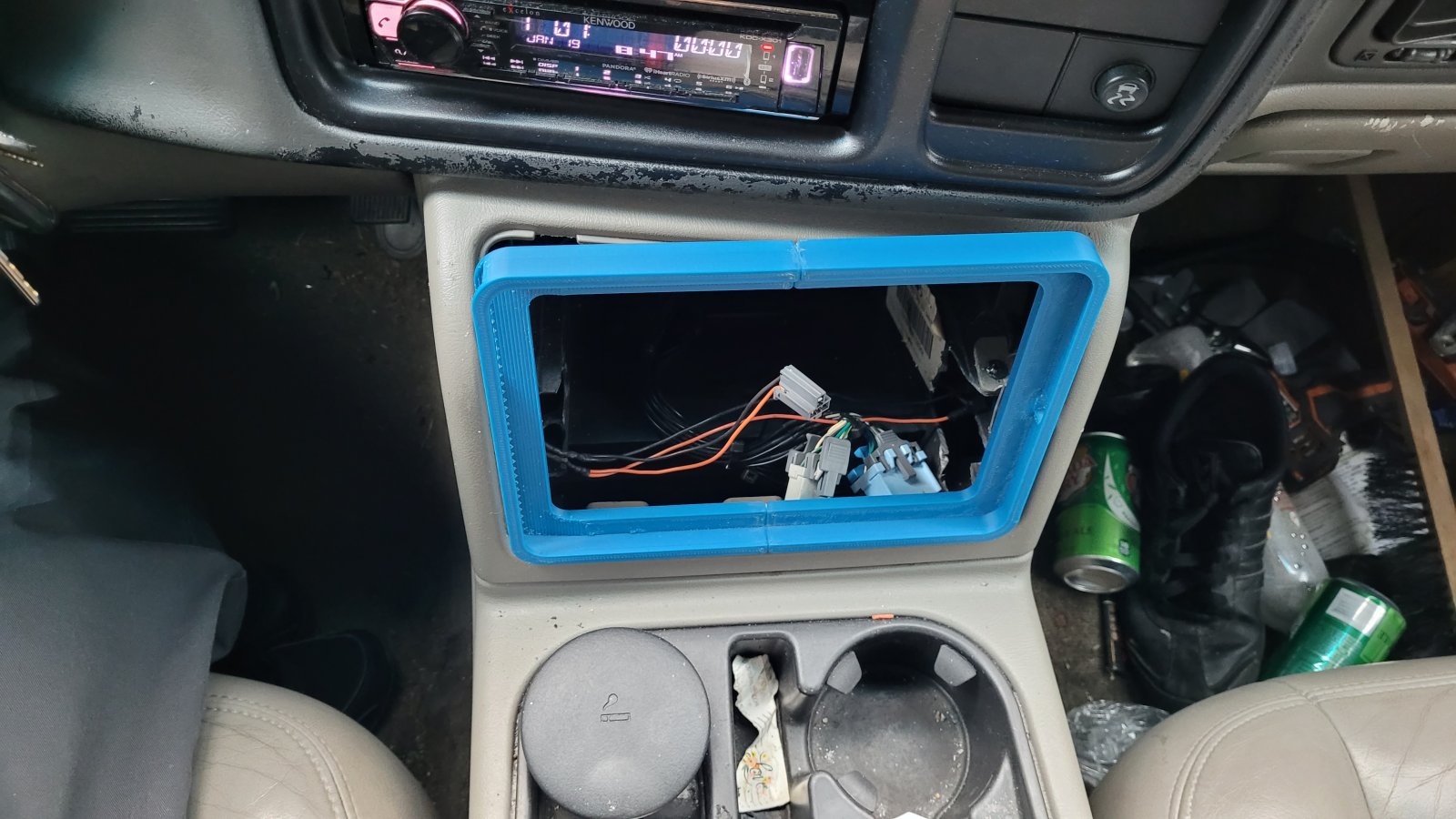

That looks great. So what will the tablet be used for? To stream music? Videos? I like it!
I drive trucks so I use this one in both vehicles. It's mainly for nav and entertainment purposes. But I also draw and edit videos etc so I can be used in that way as well. I just didn't want the "trouble" of a double din (as if this were any easier lol). I appreciate it though and feel free to send your dash bezels my way lol. I'm working on one for the 2000-03 tahoes too (they have a shorter bezel that doesn't allow a lower cd player space)

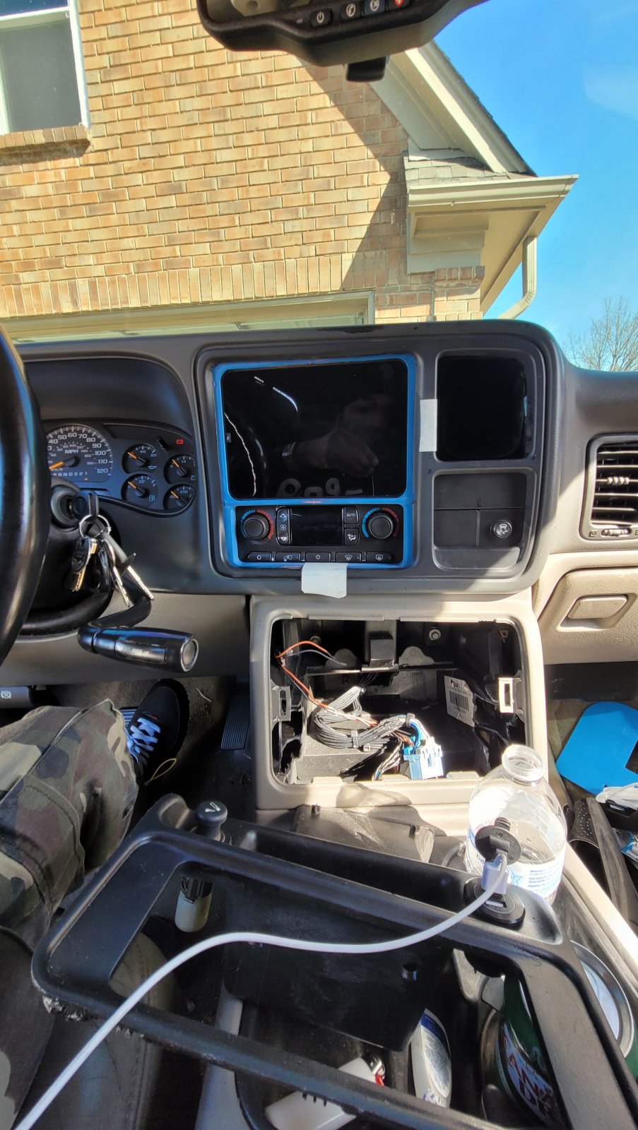

Question Is the 03-06 dash shaped the exact same as 99-02 dash specifically where the console meets the dash? My goal is Too put in a 03-06 console . I am Doing a 12.4" Galaxy tab S7 tablet indash with a custom made acrylic kit radio and climate control must be moved out of the bezel . This is why I'm asking about a swap in which the newer consoles already relocate everything.
I personally would like to know if I can use 03-06 style center console in place of my 01 console.
The only reason is too strictly have the climate heater controls lower in the console like the 03-06 uses if the wiring and vaccum linea are the same and I can just plug into 2006 climate panel. Or just relocate my 01" climate panel in the same place as the 06" ??
Any insight too direct swap or making this happen would be cool
