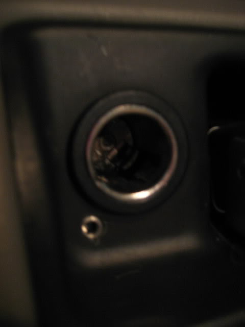

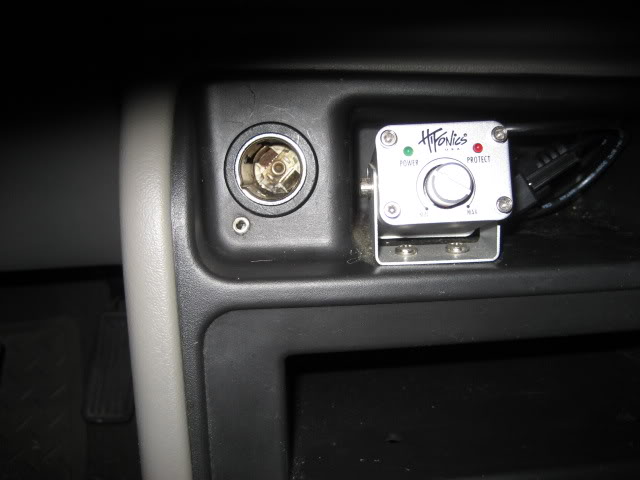

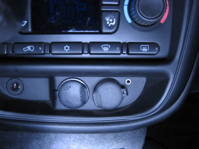

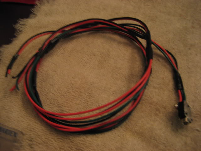

You guys who are running a 03 and up chevy with xm radio have to wait no more for the quality of sound with your ipod through your car stereo! You don't need any expensive wiring harness or any fm modulators. I found a article from another forum and decided to give it a shot and it worked great.
Here is what i started with:

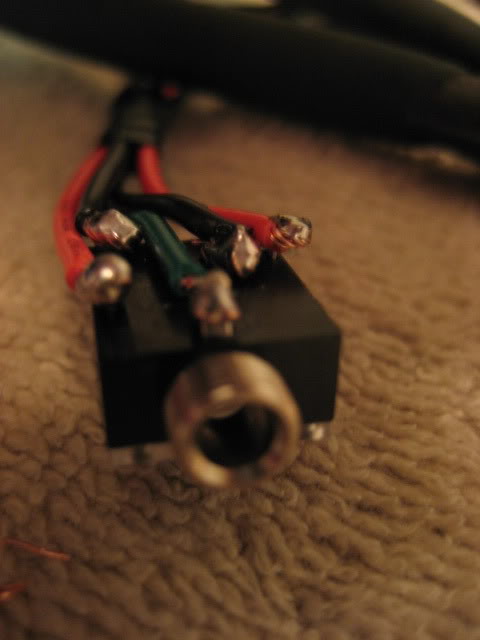

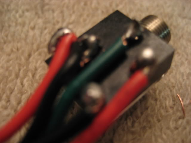

I took some wire and connected it to the correct places to hook up to the black 12 pin connector on the back of the radio (brwn/wht, black/wht, dk green, wht):

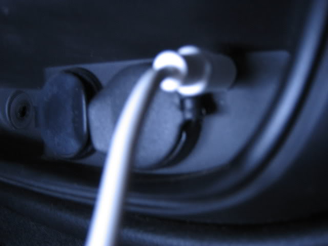

After hooking all the wires up and mounting the 1/8 stereo phone jack all you do is plug in a patch cord found at radio shack and attach your ipod or iphone or even any mobile media device with that has a phone jack just like head phones, and play your favorite music.
and this is the same set up i did on a tbss. This mod will also work on all tbss from 06-08 with xm radio. The xm still shows the artist and all the info but the jack bypasses the signal and uses the input signal until it is disconnected.
