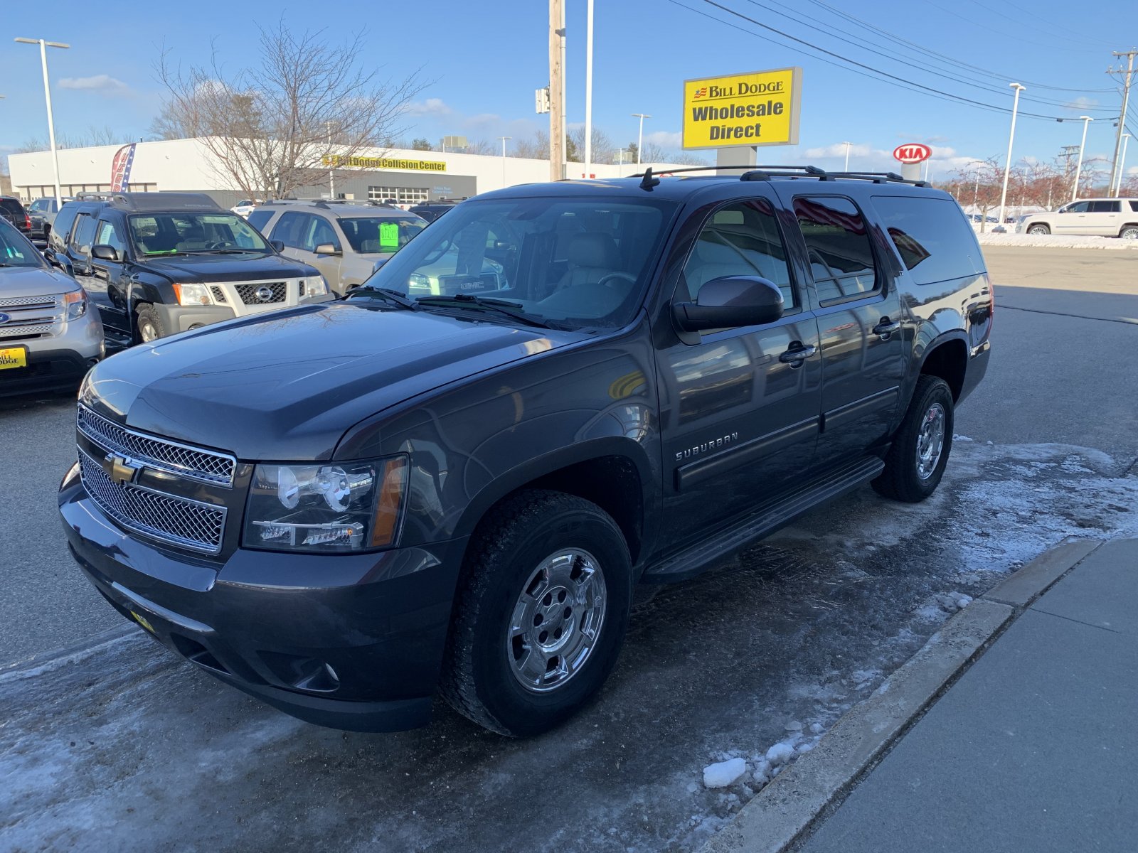

Hey all! Looking to replace my wife’s 02 Tahoe with an 07 suburban as our family needs the room. A local dealer has a nice one we’re looking at and has it listed as an LTZ. I ran the VIN through a decoder and it’s coming up as an LT, not LTZ. The vehicle has had the emblems shaved (so annoying) so I can’t really tell from the pics. If I post a link to the sale add can someone let me know what they think? I plan on going to look at it Wednesday.
One pic shows Z71 in the gauge cluster, also would like to know if that’s legit too. Thanks in advance!

Looks like an ltz to me but maybe someone knows better
Edit, i take that back its a z71.. bumper and flates give it away i missed the first time
Edit 2, looks like its got common issues for year but i did notice a large stain on drivers side headliner.. prob sunroof drains but something to consider in your offer...

It is an LT with Z71 package. The LTZ has woodgrain trim, chrome mirror caps, a different front bumper, different fog lights, different different gauge cluster, no fender flares, and it would have electronic suspension.

Yep, highest option package for Z71 was LT, not LTZ. Couldn't get the VIN unless I contacted the dealer, didn't do that.
Go over it with a fine tooth comb, check for rust and rot underneath, etc.

I think a lot of dealer software (from used car lots, not new car dealers) don't have an option for Z71 and they populate as LTZ based on the VIN because I've seen a lot of Z71's listed from used car dealer's as LTZ's. Also, if I'm not mistaken 2007 and 2008 LTZ get listed as an option package on top of an LT trim level because I've noticed taxes and insurance seem to be cheaper for the early LTZ's.
