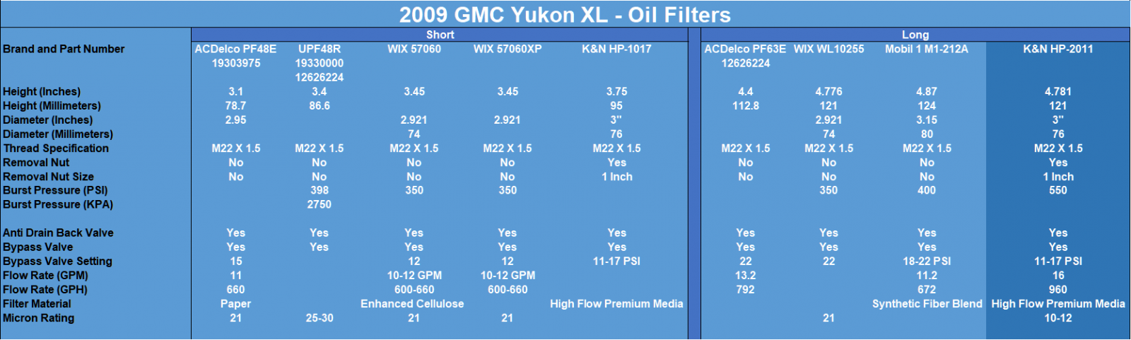

I just picked up the ac delco 61e for the daughters Silverado and going to give it a run and see how it does vs the shorter delco. I havent dealt with anything on the 5.3s other than delcos.
