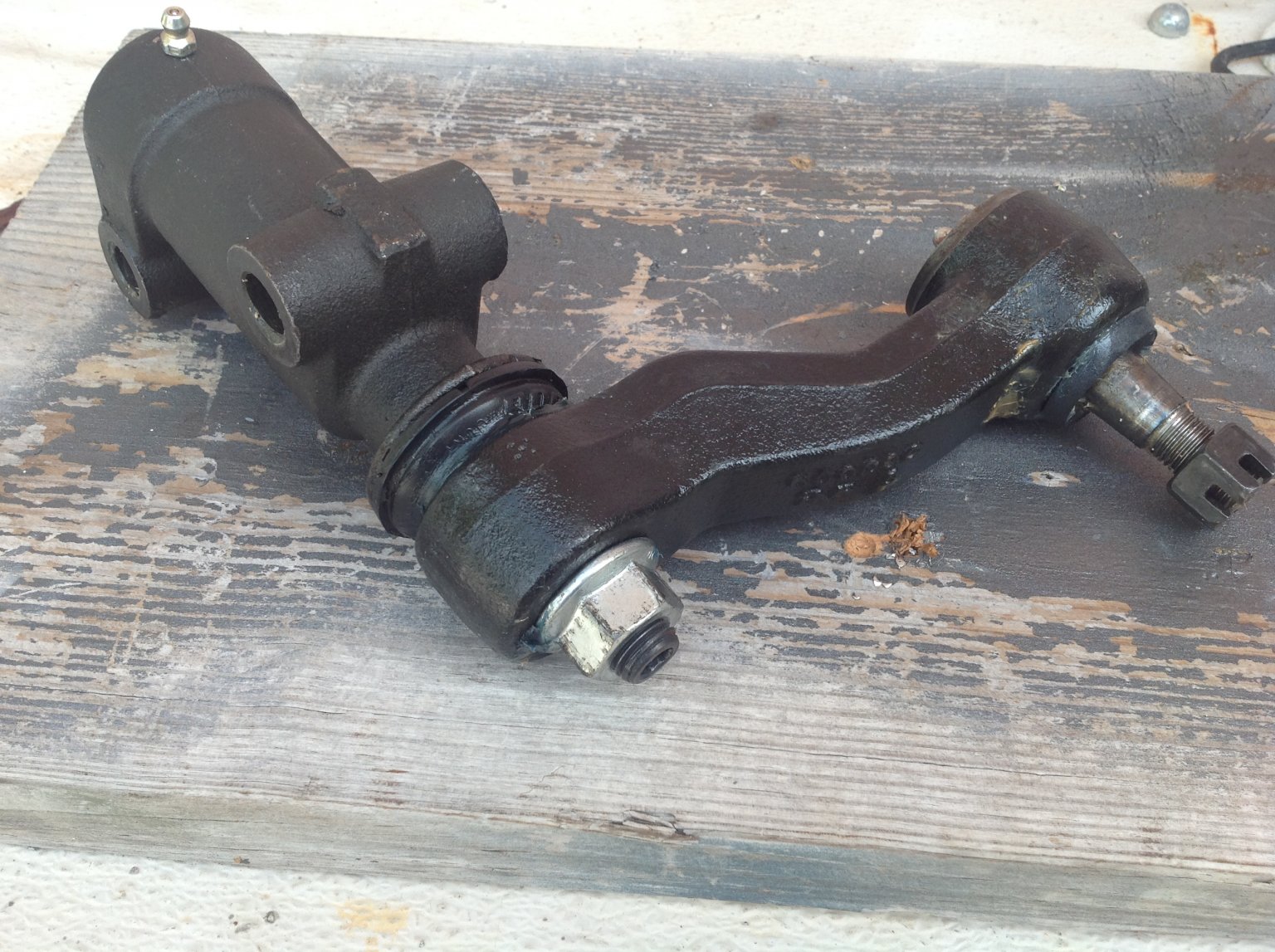

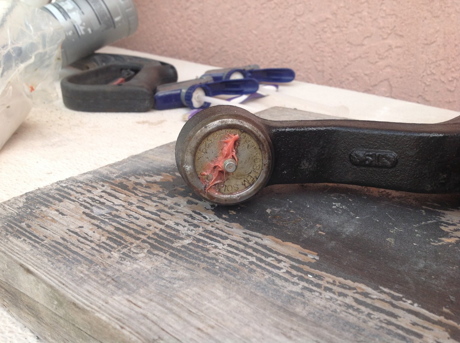

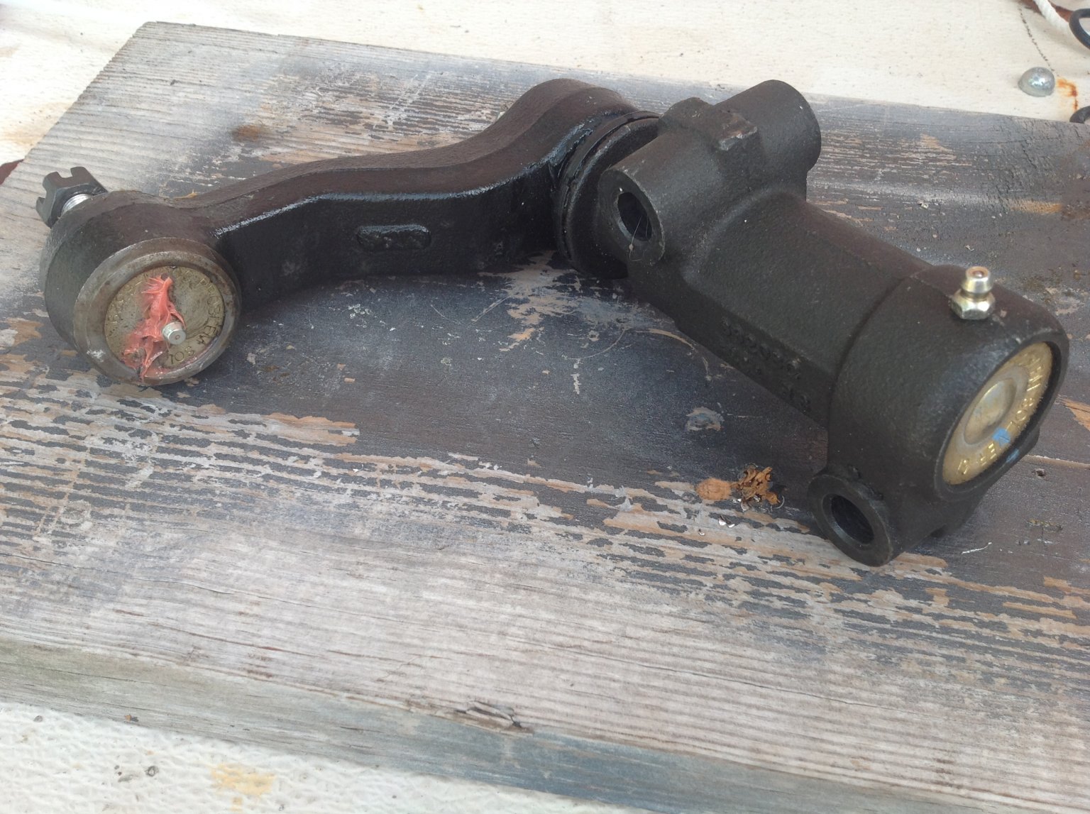

Rare parts make some really high quality stuff. I'm using their tierods, pitman arm, idler arm bracket, along with a moog idler arm and cognito support brackets. Rare parts re-engineers their gm steering parts to fix its faults. My steering feels great without a steering stabilizer but my gearbox is getting worn so I still have some play.
