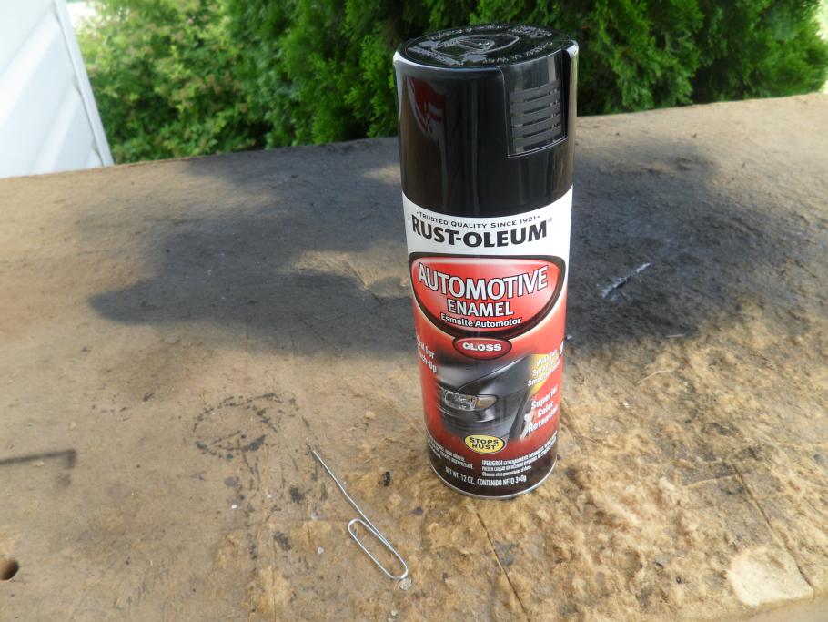

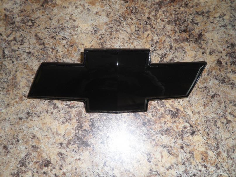

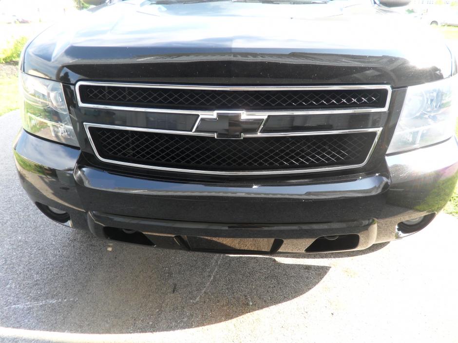

I just painted mine on sunday! Don't wast $70-$80 on the bowties. I spent $5 on a can of rustoleum automotive enamel gloss black spray paint and $4 on a small bottle of goof off. It took 15 minutes tops.
Take the bowties off and put goof off on them to clear off any oils. Then spray paint the bowties and let them dry for about 10 minutes. You should be good to go after that! Trust me it was a piece of cake. Here are some pics and the outcome.
