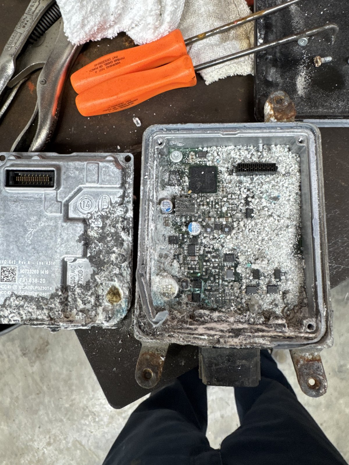

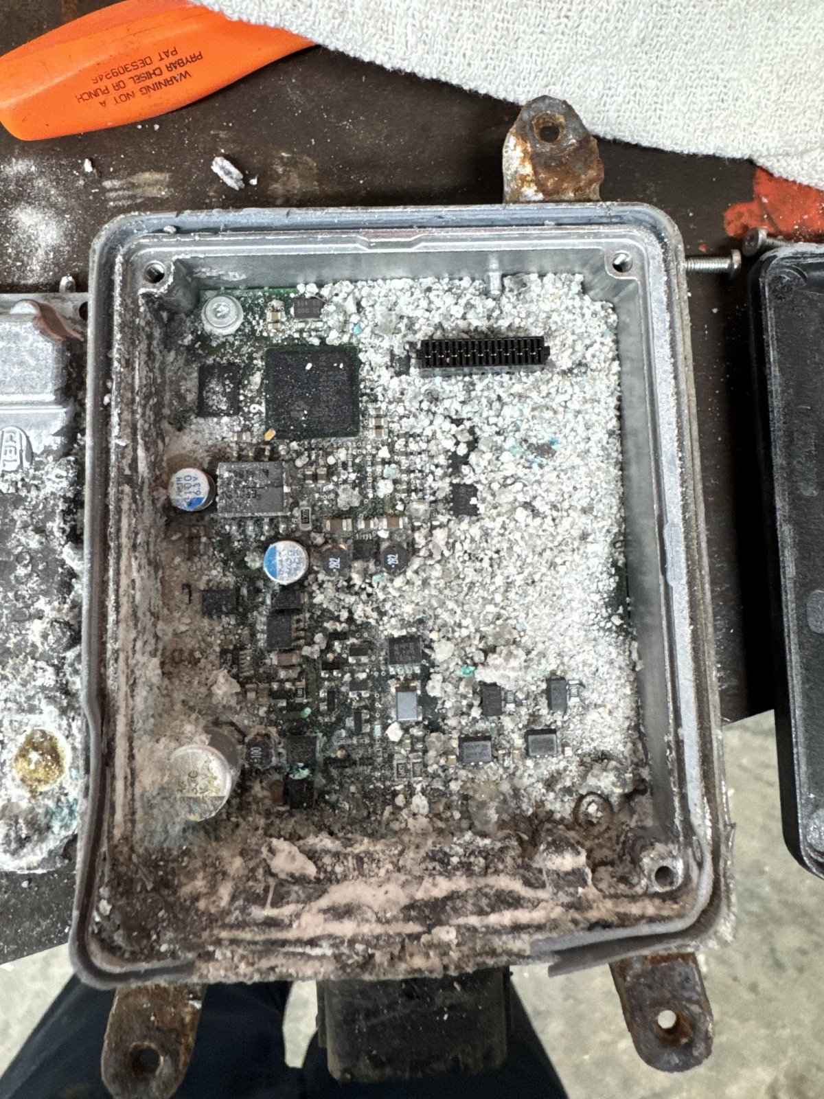

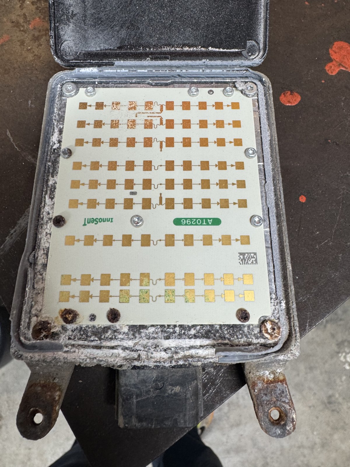

Latest update, still no luck with the Yukon, I ordered a new tail light that will get put in this weekend. I’m wondering if there is anyone that can give me an idea of where modules are located on the truck that could get any water on them from driving or just sitting out in the rain. I’m just going to go module by module making sure they’re good and clean, spray all connectors with contact cleaner and give everything a healthy does of dielectric grease before I put it back together. Hopefully this will help me find something. Thanks in advance for the help.
