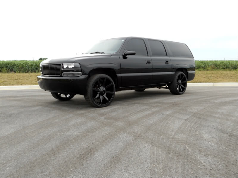

I could go a little lower yes.. I'd be happy with another 1-2". The torsion bars are completely removed.
So if the DJM arms are just indexed differently can I put a set of lowered arms on it from a pickup?
The only other way would be modify the lower shockwave bolt on bracket to drop the lower shock mount 1-2"
I'll get some better pics hopefully this weekend, been raining every other day it seems.

Pic of when I pulled the bars, inners are sitting on the tires... Looks sick!

Well first step will def be see if there is an LCA that has a lifted spindle mount and not just different hole degree.. if you can find one id still try it with the lowered spindles on for sure..
if there is next thing is to look really food at clearance on that shocky bag thingy you got ...
Then.. if there is clearance issues.. OR if there is no LCA you like.. the next thing to do is look for a different or customized UCA to help clear it OR you might have to start looking into moving the upper or lower bag mount , over, or up.. over for clearance.. and up for more drop.. lifting the upper mount will obviously allow for more drop.. or sinking the bottom bracket of the bag lower.
The rear.. ill tell you this.. when youre trying to go low on a budget... youre gonna need 3 things.. djm drop brackets.. longer control arms.. and a modified or adjustable panhard bar.. because you will hit the front of the fenders before you hit the top... and the side to side is gonna kill you before that even happens..
It looks sick as shit btw.. just as a dude who went through multiple add and removes back and forth.. id like to help anyway i can

Looks awesome, the way it all runs together almost makes it look like a 1500 quad cab with a camper top instead of a burban lol
