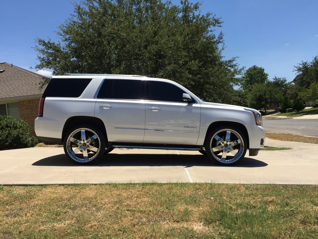

Glad to finally be back... Picked this one up last Saturday and it's been a busy week...

looks nice
hows the exhaust sound?

Thanks. It sounds good but I wouldn't want it any louder. I'll post a video of it soon.
PeteMan187
Feb 24, 2016
Sick ride! What did you do with your stock wheels? Are you looking to sell them?
