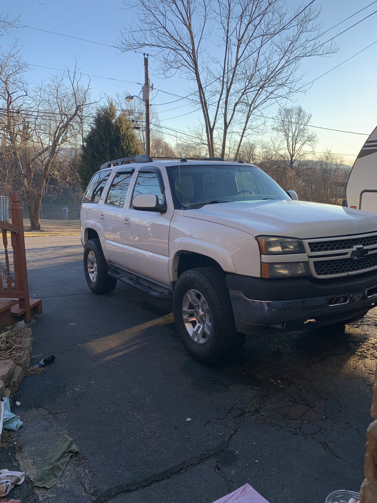

New radiator and new power steering cooler mounted and hooked up. Topped off, bled air, and checked for leaks.
got a little concerned because the fans didn’t cut on for almost ever, and started to get worried that I must’ve messed something up, but then they finally cut on.
Drove it around the block (mostly to wash the truck off) and found some new issues:
AC compressor I think gave out when it started this time. It made an awful noise when it started, then there wasn’t any cold air, or noise when you turned it on or off. I added some refrigerant and the pump made some noise, but the lines were under pressure already, and nothing changed.
as if that wasn’t frustrating enough, the blend door for the front AC has apparently quit again, so I’ll have to change that (again). Additionally I tried to replace that part for the rear AC unit only to find out it had broken off and feel down into the unit, so maybe I’ll take that apart too.
radio connection is shorting out (wife reminded me it was doing that before I parked it) so I’ll take the dash off to fix that.
And now almost all the lights in the gauge cluster are out, so I’ll be looking for someone to rebuild it, or put the esky cluster I always wanted in.
still trying to find someone to paint the new door for me, and then figure out how to move all the parts and electronics from one door to the other..
Struck out on the bolts for body lift to replace the ones for the truck bed in the kit, so I’ll just order them.
all the body parts are installed, except the wheel flares waiting on new body clips, and the bumper and grill which are waiting on paint and the body lift.

Update:
got to spend two days this week working in the car. As the virus picks up in my area my free days from work are gonna become less and less..
anyways, got a few things done. Installed the rear wheel spacers
peeled the stickers off the rear window, and took the pin striping off the sides.
prepped the calipers and painted them for the NNBS brake upgrade
then put all new rotors on the front, and put the new (to me) calipers on.
Didn’t take anymore pictures, but also put bigger torsion keys on to level the front, and added the wheel spacers to the front as well. Stance is much improved.
While trying to prep brakes after install the pedal Unexpected went to the floor and there was a sound like air. The pedal kept going to the floor, but would eventually push back. I thought maybe i had some air in the system, and decided to work on the AC.
replaced the orafice port between the high and low pressure lines, vacuumed the system out, and then repressurized. Ac is colder now, but I’m still having an issue with the actuators not giving me cold air on passenger side and rear. I’ve replaced the front one once before, and tried to replace the rear. The rear one actually broke the door off, and had it fall down into the system, so I’m not real sure how I’m going to fix that.
As I got out of the car, I noticed a dripping puddle behind the drivers side rear door, and at first thought it must be condensation off the ac units, but it was on the wrong side. Reached down... brake fluid. Looks like the line burst on the drivers side while trying to repressurize the system. I guess the stainless steel lines just got moved up from a “later” upgrade to a “now” upgrade
