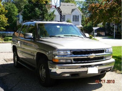

Got my 2001 Tahoe from my godparents last may (may2009) @ 91,589 and have now got it up to 101-102,000 miles im not sure how wel they took care of it but it seems to run very well. im just wondering what are some key things i should get tuned up and maybe even replaced to keep this thing running for many more years. I change the oil on time and top off any other things i need to but im not shure what else is needed! Thanks for your tips !

You just breaking it in. I guess you could flush the radiator and put new coolant in if that has not been done. Basics bro check belts & hoses. I gave mine a tuneup at about 80,000. Didn't need it but I just wanted to do it. Changed out differential fluid with Royal Purple.

Yeah, that's still pretty fresh for these rigs. That's actually good miles for an '01...dang. Mines '03 and at about 150k, about 35k of which I've added in the last two years. Unless something needs attention, I wouldn't necessarily do anything special, honestly.
