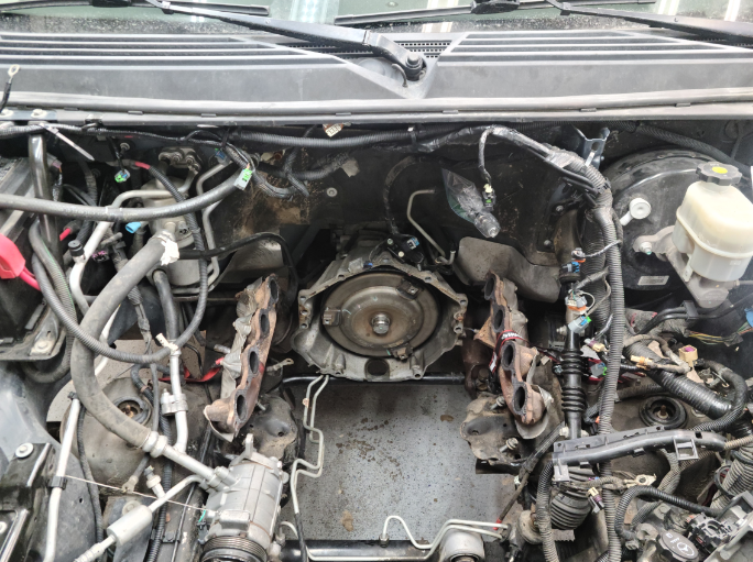

So obviously somebody else has had the trans out. Now I remember mine- fuel lines on driver side. Trans vent hose on top, trans wiring harness I think on passenger near top, then trans dipstick on passenger center. There should be 4 studs and the rest bolts. Sounds like whoever was in there before didn’t reattach everything and just left shit dangling.
Having bought it at 147K, I can't say with certainty that mine has never been messed with. But, here's how my bolts were and how they went back:
img_2062-jpg.250020
I wanna say this is haw they are from the factory as I believe it was @tgui that posted up about the odd mismatch for the bottom bolts and they were the same as mine.
