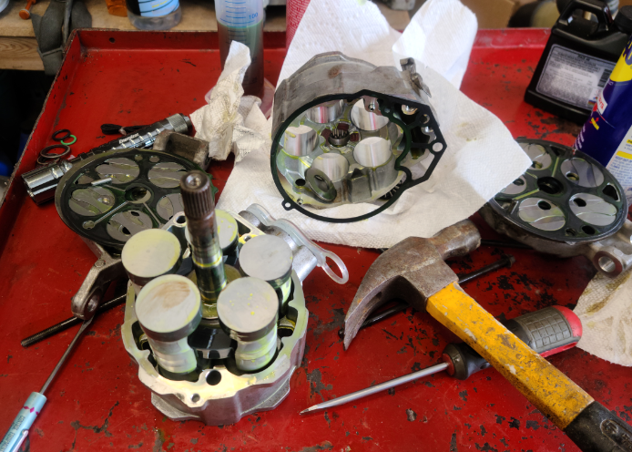

I also went through my pump last night, it's not terrible.
the housing looks pretty good
but the rotor and slide looks like it might have pumped/grinded up some little bearing bits.
I did some light cleanup of the rough bits, and i think i could use it.
but should i...
it's a $160 pump. :hahano:
It was pumping just fine, my oil pressure was great and stuff.
the idle oil pressure did start going under 40psi hot...
but i could still pin the oil pressure gauge at wot.
:hmmm2:
From your description, it sounds like the pump is fine. There's no need to peg the pressure. That's just excess load on all the seals involved. Based on your other symptoms (glitter in oil), your loss of pressure is not from the pump getting weaker, but from tolerances getting wider, likely cam bearing(s). Since you have the pump apart, why not port it? Oh- and pull out the relief valve to make sure there's no metal in there. You don't want it getting stuck open.

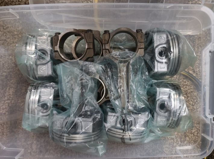

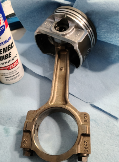

And for the pistons, i went full circle and worked to find the matching pistons for the 799 heads and the 6.0 engine.
Looks like a 09 trail blazer SS used the 6.0 engine, with the 799 heads.
And used flat top pistons!
GM PN: 19178305
I found that this comes as a Mahle PN: S224-3665
and then ends up right back at my original piston find!
https://www.summitracing.com/parts/slp-h1129cpa
I also confirmed that the 5.3 rods have the PN: 12649190
And the 6.0 confirmed the same PN!
so i think i have my wrist pin size and all figured out now...
Thoughts?
