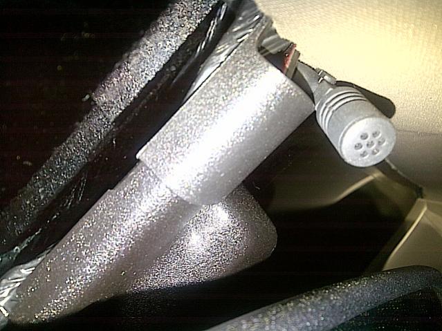

Where are you guys mounting the mic for the bluetooth?

I basically ran the wire from the glove box up the front pillar and then along the headliner to the rear view mirror. I then used the mic attachment that comes with the product and stuck it into the black plastic located at the base of the mirror. I've attached pictures and hope this helps you.
