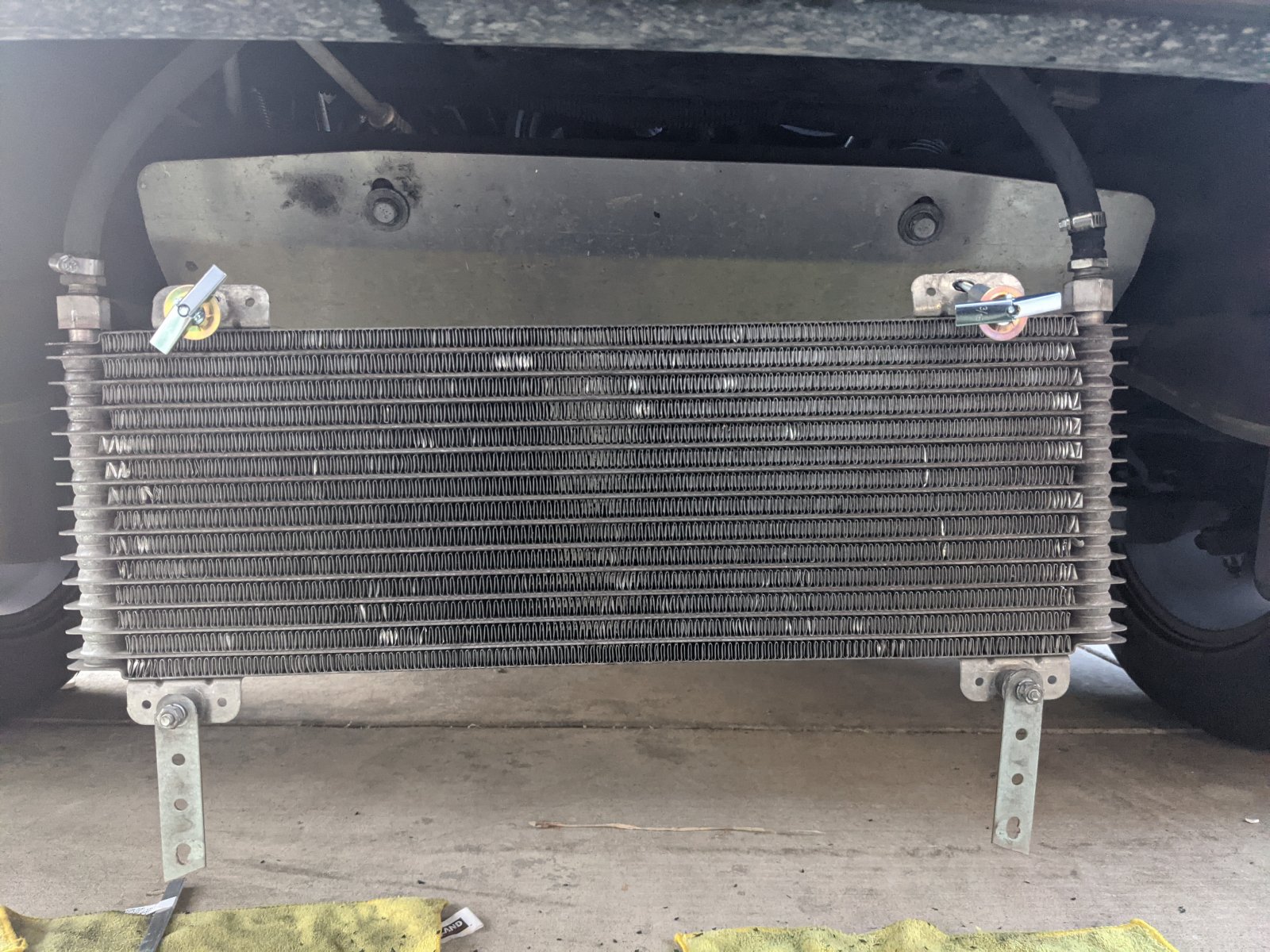

I have a decent sized external transmission cooler I put on the Burb to replace the factory Auxiliary cooler but it isn't as big as a 40k...
You can see it is the black one in the center, not the silver one on the passenger side.
My transmission, once up to operating temperature, runs consistently 80° above ambient temperature.
