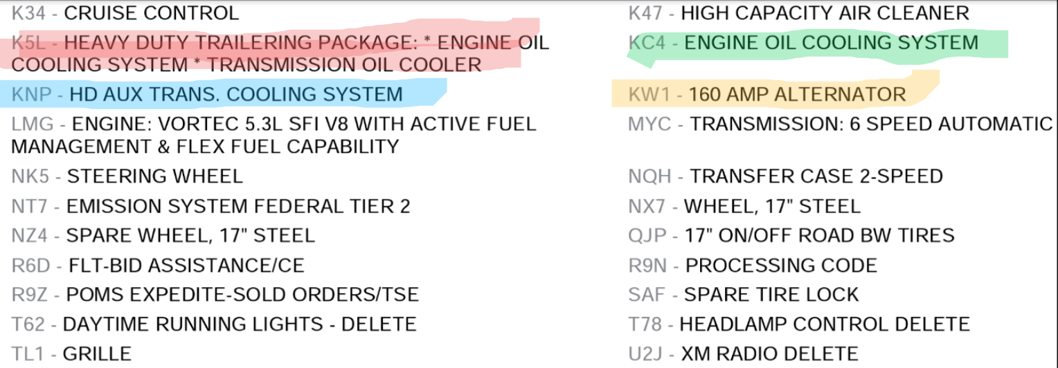

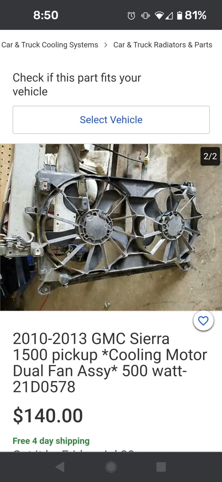

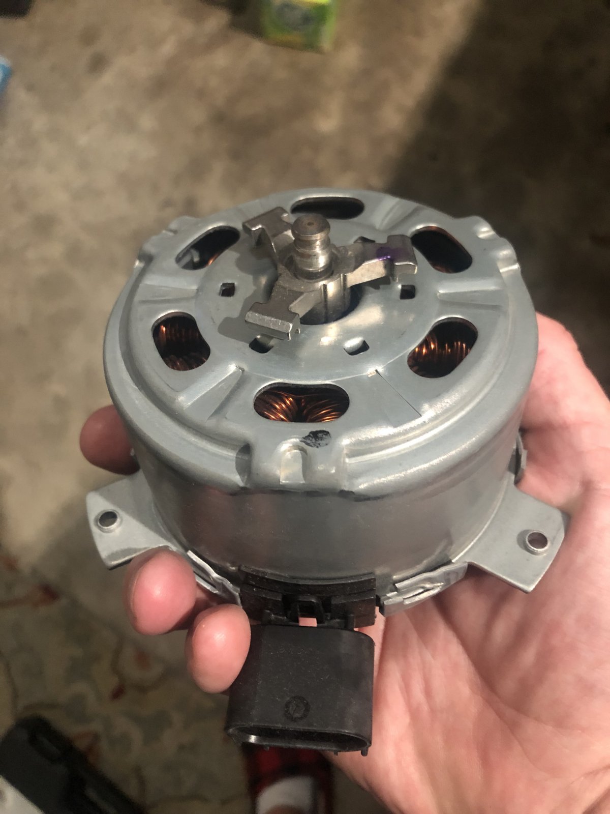

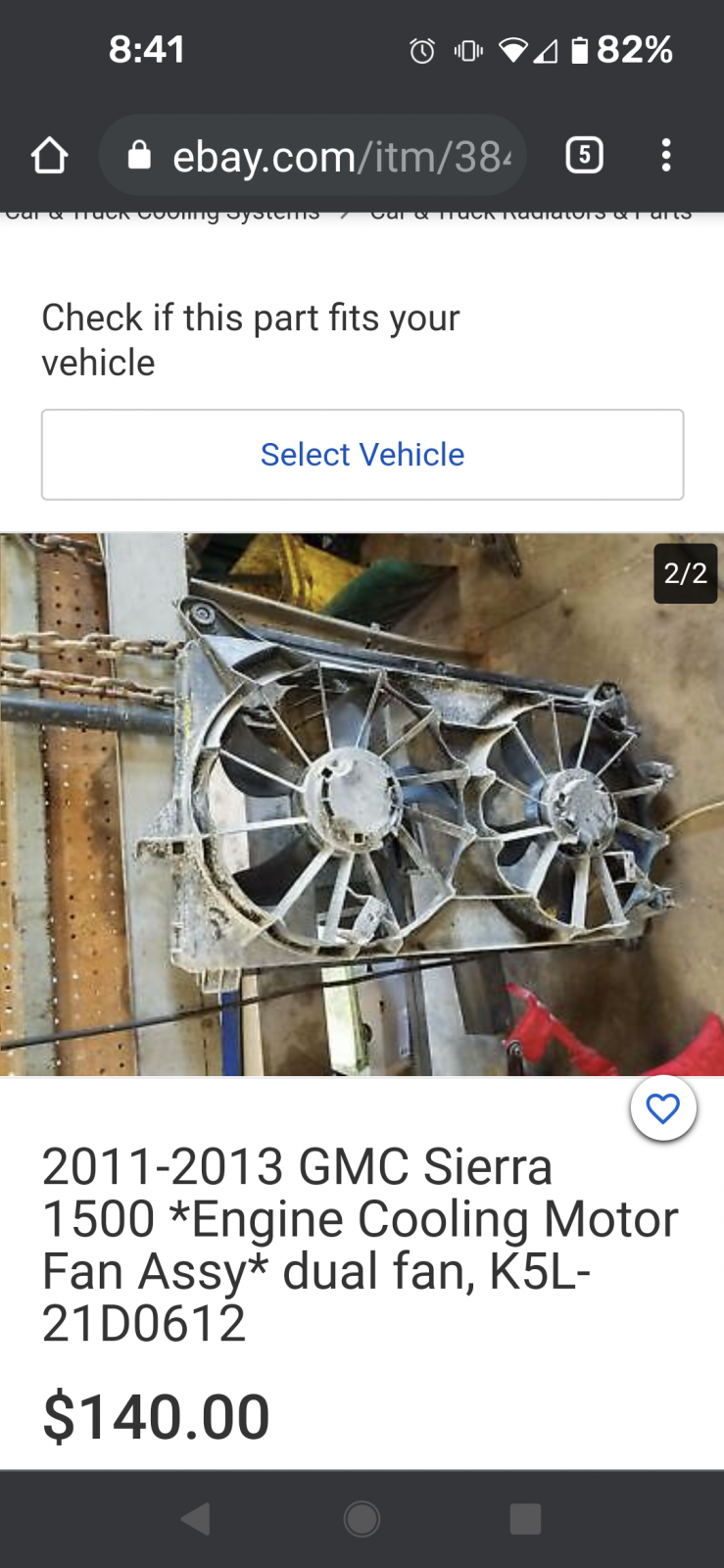

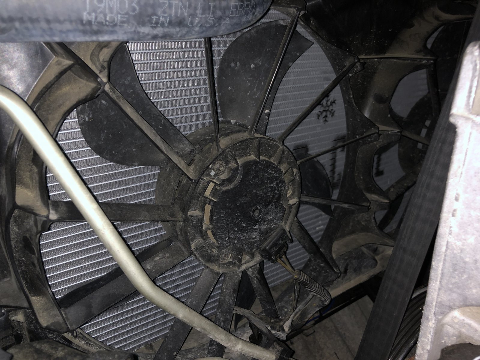

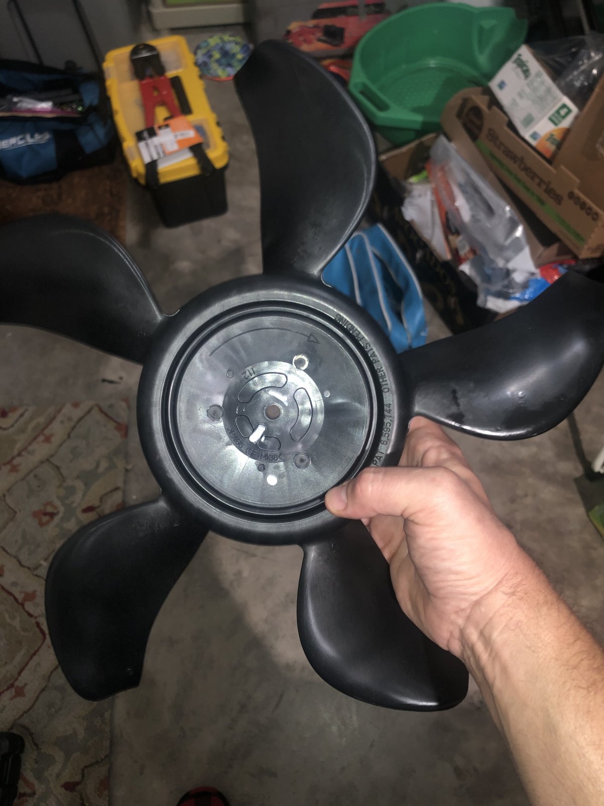

I have a 2011 Yukon Denali that had high trans temps when pulling my new trailer. Installed the TruCool and no more trans overheating. Now the engine temps are rising to 225 as soon as I get going down the highway. I thought the higher wattage fans were to be used for in town cooling. Mine are fine in town and cool right down when I get my speed down or get off the highway. What kind of restriction do I need in the radiator hose or should I just purchase a OEM item? I purchased this vehicle a few months ago, didn’t find a trans replacement on the Car Fax but it does have a 2020 sticker on it.
03_GMC
Sep 12, 2015
146
201
Ok so just so we have a better idea of what you have done.
Tru Cool trans cooler ☑️
Higher Wattage fans??? Need more info
tuned at all?
what do you mean radiator hose restriction??
