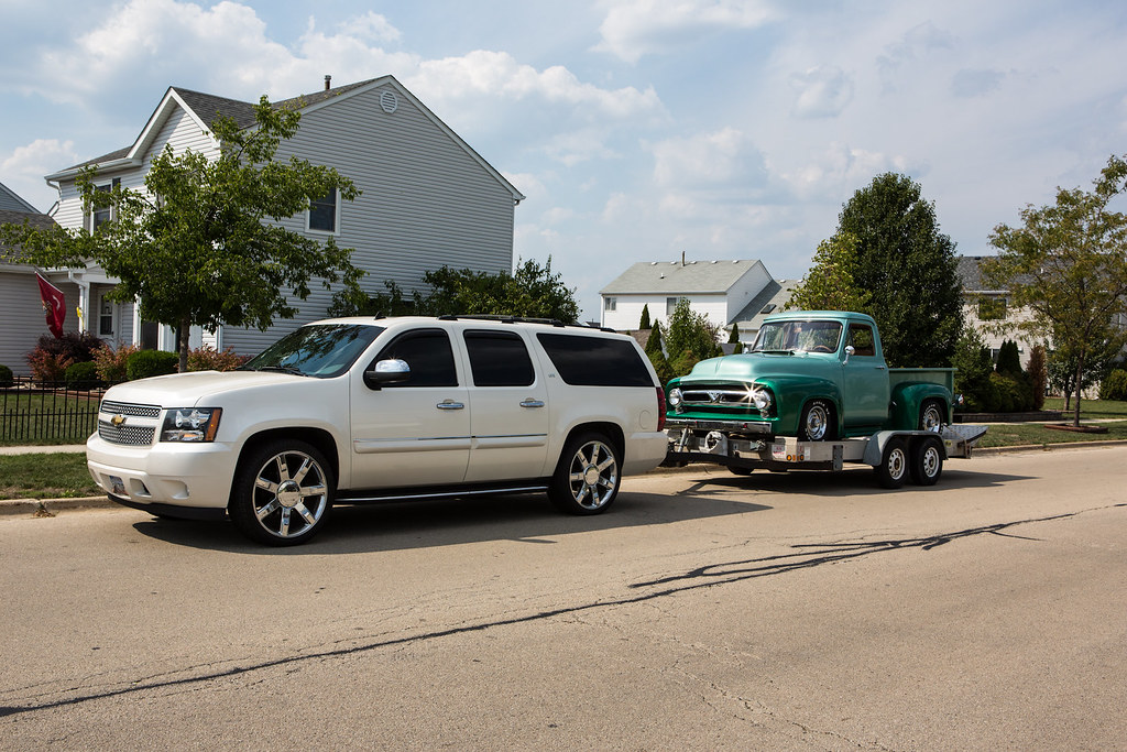

With this pic did you use a camara rig and drive about 2mph and they just photoshoped out the rig? I had something similar to this with my show car when it was featured in a magazine.
I used my boom arm with cups and super clamps. This was at about 35mph and I just drag the shutter to keep the motion. I freelance via a small studio out of my home and just recently branched to in motion automotive December of last year.
