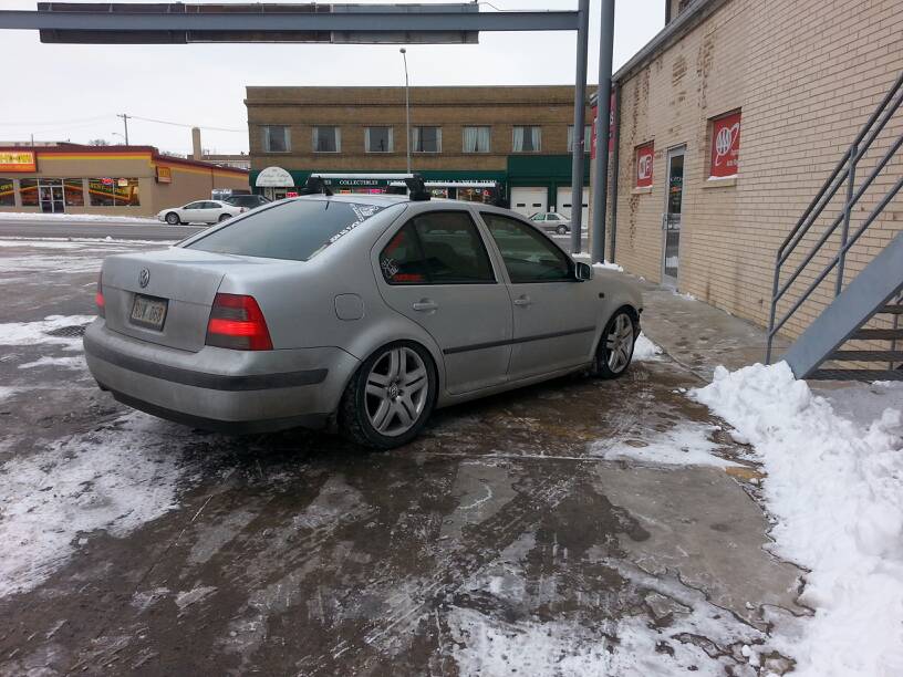

Are there any preventative maintenance items I should take care of first? Already know I have a bad wheel bearing, should I just have both replaced at the same time? Kind of new to the world of lifted trucks. uploadfromtaptalk1407126477860.jpg my jetta that should be sold soon to pay for more truck goodies.
