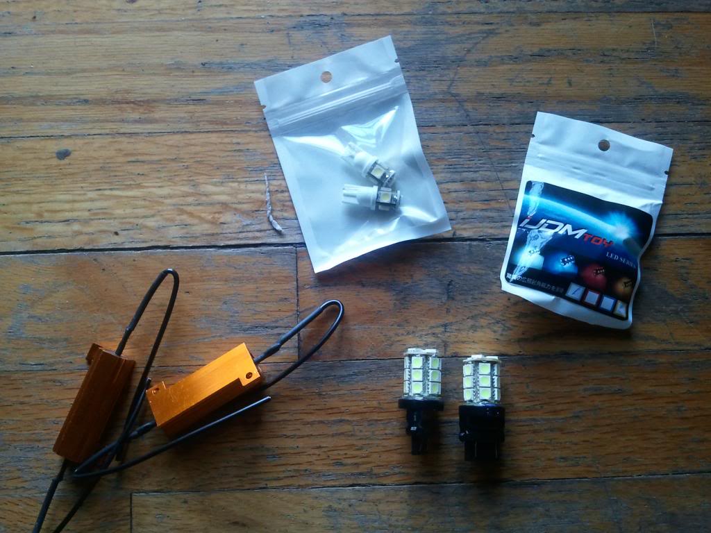

I got these for my blinkers. Put them in and got hyper flashing so I ordered some load resistors- http://cgi.ebay.com/ws/eBayISAPI.dll?ViewItem&item=360236618578&ssPageName=STRK:MESINDXX:IT
Got 194's exactly like these, can't remember the seller but they are bright, only problem was they were a little too tall for the housing so I cut off a little bit of the wedge and now they work great- http://cgi.ebay.com/ebaymotors/Supe...ptZMotorsQ5fCarQ5fTruckQ5fPartsQ5fAccessories
And these for reverse but haven't had time to put them in yet- http://cgi.ebay.com/ws/eBayISAPI.dl...IguKH7Y%3D&viewitem=&sspagename=STRK:MEWNX:IT

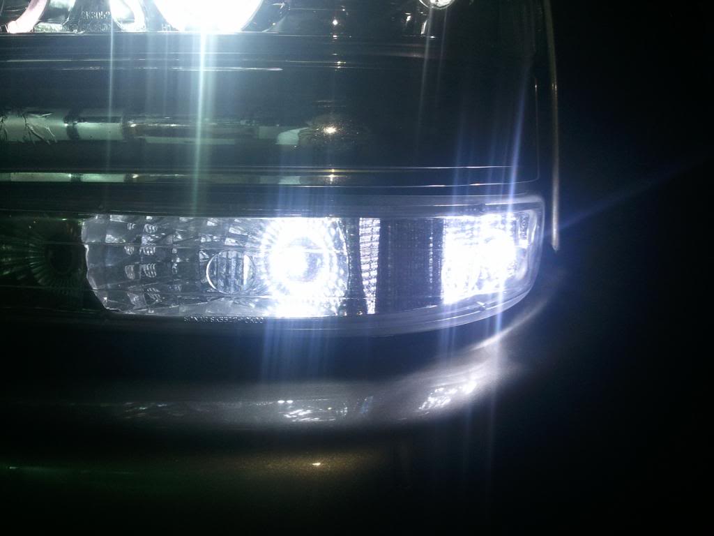

I have been looking into corner turn signal leds but there pricy so im waiting out the storm im on the fence with the drls but like the turn signals id like to see it done before i jump... and for reverse i want to try a hid kit like someone did on here. when it comes to the outside of the car it takes alot of leds to produce good light they are usually washed out easier so in parking lots with ;lighting and what not id go hid...but for drls and turn signals its not a bad idea

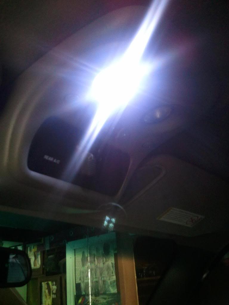

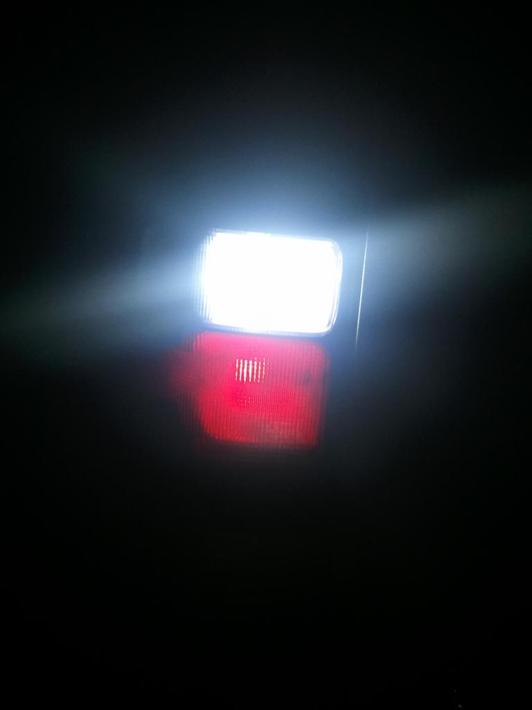

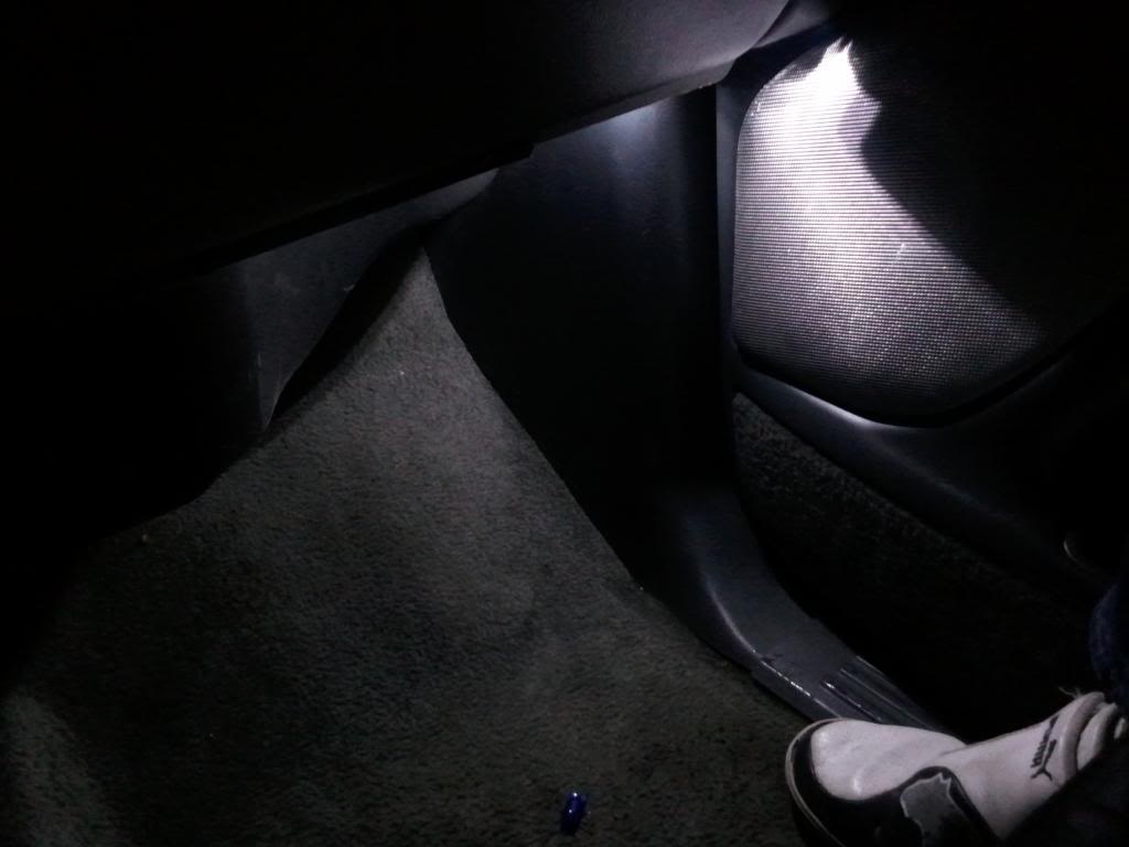

My order Consisted of the following.... All are "6k cool white"
My Map lights
: (v-Leds.com)
(194 wedge) 4led high power
V-LEDS HID WHITE 4 M-SMT 2W HIGH POWER BULBS 194 168 158
(i origonally ordered these for the the license but the wedge was too long)
[There expensive (10 bucks a piece) but they are bright as hell and are perfect for what i was looking for
4-Car doors-
(194 wedge) wled-x...check your truck because some said they only had two that actually light up all four doors for me had lights.
2-License Plates-
(194 wedge) WLED-x6
4-Dome Switches-
(4410-x9)...... I believe these are the same bulbs as the bulb under the hood..
4-Dome Middles and Puddle Lights-
(4210-xHP6) notice these are HIGH POWERED aka brighter then the others.
---------- Post added at 03:31 PM ---------- Previous post was at 03:27 PM ----------
Now since the dome switches and door lights are not high powered they are more blueish than the high powered lights and way less bright...but also less expensive(by alot!) If your going all out for matching and performance this is what i suggest..
---------- Post added at 04:45 PM ---------- Previous post was at 03:31 PM ----------
REMEMBER THIS IS A SUGGESTION IF YOUR WILLING TO PAY THE EXTRA FOR BRIGHTER MATCHING BULBS!!!!!get all High powered...
an alternative to my maps lights
8-Maps & Doors & License Plate-
WLED-XHP5's
Dome switched-
try 4410-xHP12 44x10mm theyll match the middle dome lights better..
remember these WILL be MUCH more expensive but they are the match to all the other lights.. you can even leave the doors the way they are and just use the high powered lights for the plates and maps
i went on nathanjacks list as awell and i disagree on the fact the if all are high powered led's theres no reason to cheap out and but reg powered for some IMHO it looks better to have a high powered so ill be fixing that soon!!!!! i encourage all to see what right for them but i feel as if your better off going all hp led's
