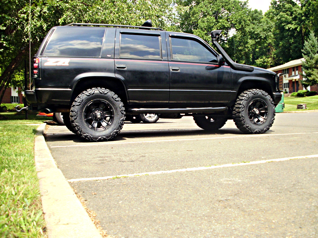

Last pic of it at this height 6inch super lift going under it on wednsday

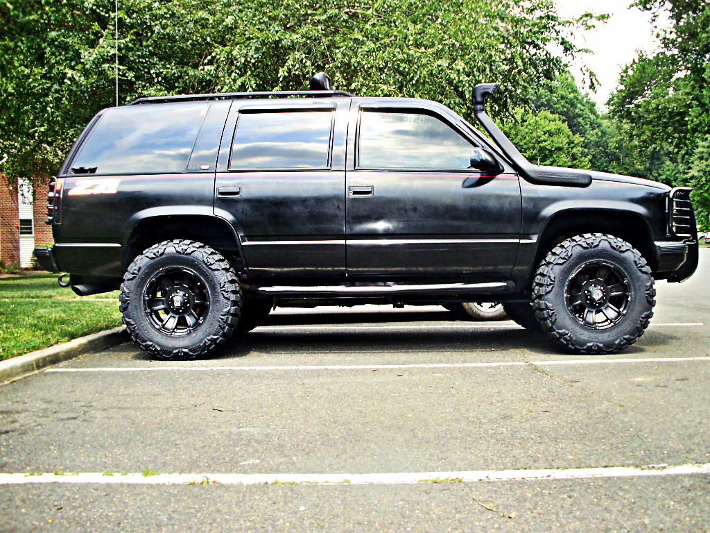

Got some good shots of it today

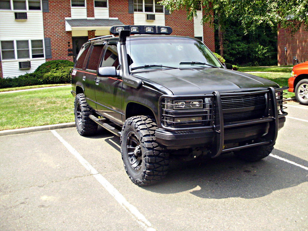

This may have been covered somewhere in here, but what type of light bar is that on your roof?

I was wondering the same.. :eek:

Yes still 31s and just ordered the rims this morning no crank I want to see how well the 35s fit first

And the light bar is a John Deere 3100 something combine light

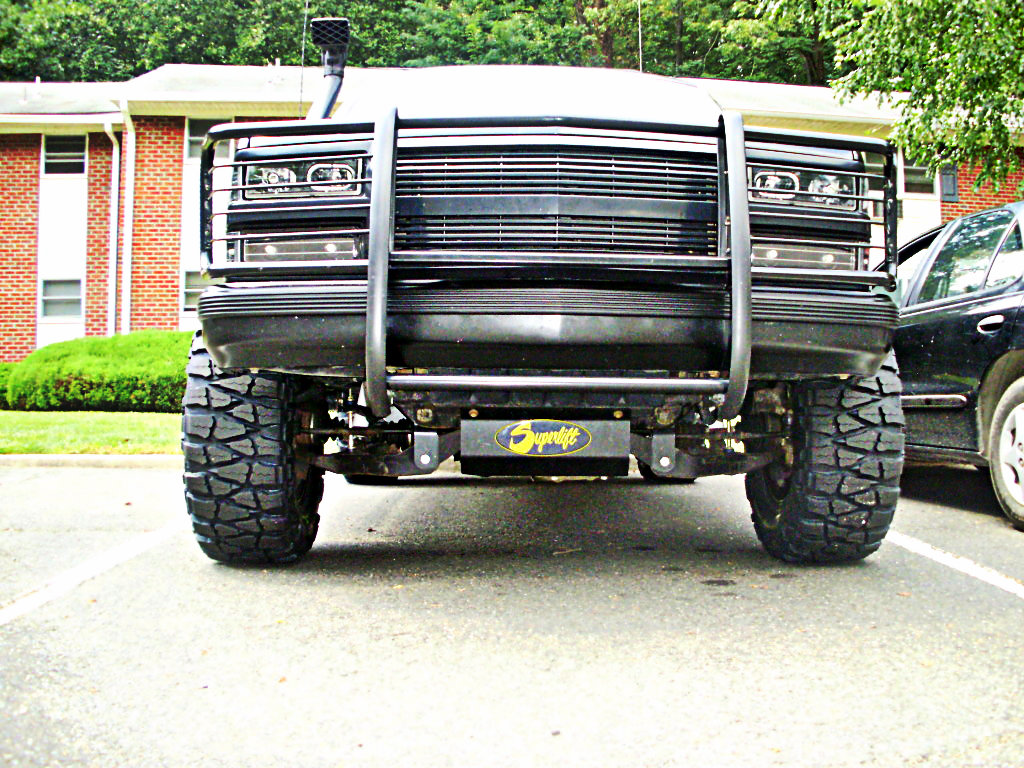

Honestly the truck drives better than ever doesn't help that I had crappy Monroe shocks under it either b4 lift but I couldn't be more satisfied it's a 6 inch bracket style lift most guys run knuckle lifts for 2 reasons cheaper and can always revert back to stock now when I say cheaper I'm not doggin knuckle lifts by no means still a good way to lift a truck . But I don't have hardly any cv angle knuckle lifts tend to and i can still run stock torsion bars so it remains factory ride I couldn't believe how comfortable it is by far the most comfortable lift I have ever rode in except for body of course. I got 5.76 on the front and 5 .25 in the back with no add a leaf and no crank I have the parts just waiting too see how good it clears it first I can get a total of 7.5 on the front with 3/4 ton torsion bars now one reason bracket lifts suck is if not installed correctly and painted between brackets they will "creak" due to the parts flexing on one another and if you don't weld them in place alignments can become a nightmare so done right and a little extra bank I'd prefer bracket lifts but as I stated b4 knuckle lifts are great too
