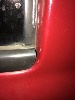

New part (belt) installed
So the 1/4" seems to make a huge difference in that part fits under the mirror assembly. Hopefully that will fix my worse leak. But at the rear, the new part seems to have a notch i had not noticed when i first got it. See picture. Does anyone have this? I guess these little gaps are meant to encourage evaporation when water gets in???

Rear window belt
So I also looked at the other windows. They all seem to have gaps at front and rear. I guess this is normal. I can't imagine that all of these were replaced so it must be OEM.
