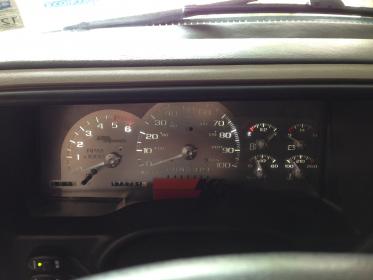

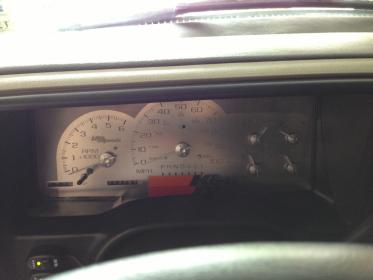

alright, got all but two of the LED lights converted over...had just ordered the wrong style for the back map lights. I don't know if anyone else struggled with doing this conversion, but the LED lights are finicky (sp?). I bet half didn't work after I installed all of them and of course, didn't test each one as I went on to the next. Ended up making small adjustments and getting them all working. Actually had one bad one that kept popping my illum fuses too. Took me about two hours, 1 1/2 hour was troubleshooting! Will upload picks tonight when it gets dark. Installed all bright whites...Swapped gauge face to SS too, looks good!

leds are diodes, so they will only work plugged in the right direction. If they aren't working, flip the bulb around. They are also cheap so chances are some will be duds rights out of the box.
btw, a throttle body spacer on anything except a carb or TBI motor is a waste of time and money.
I thought that may have been the case with the bulbs, but wasn't sure. Now i know...i had to order a couple more, so it should be simple this go around.
About the TBS...whether it is a waste of money or not, it was a therapeutic to install, none the less!
