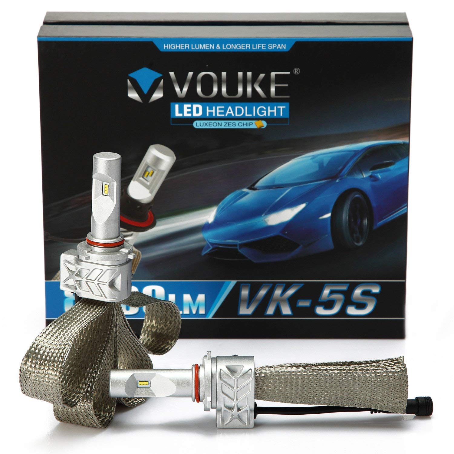

I am also looking at these:
https://www.amazon.com/dp/B077BT6M6...cfd7c39b45e5d0da7ec37f376598fd&language=en_US
With some of the reviews I've watched they are saying these are a bit better.
I'd be interested to hear feedback if you go with them.
