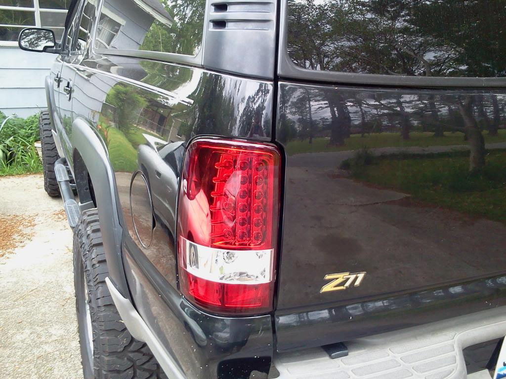

If its still worth anything to OP, here are the pics I was talking about, Top set of LEDs is brake, which has 2 stage for tail light and brake light. Second set is the blinker (hazards in pic). Didn't get one of reverse, but that is up to you as the bulb is not included. However, I suggest a BRIGHT LED. As in, on superbrightleds.com get the ones with 4 or 5 bulbs in relative brightness (believe over 140 lumens).

Grimes, those look like the Sonar lights with resistors built in already. They are an exact match to mine. You went the way I did and bought an led flasher. In my opinion it is the only way to go. I don't see why people would hack up their wiring harness to install resistors.
