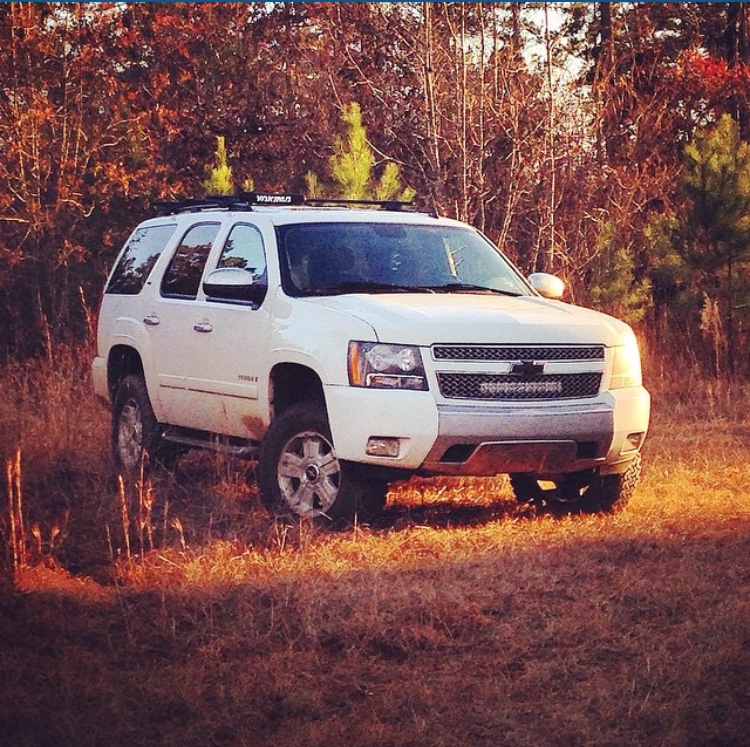

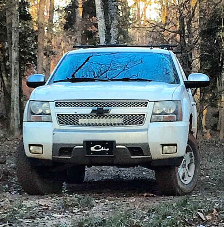

Just another picture of mine. Thinking of lifting it another 1-2" up and try to stuff 20x12 with no more trimming.

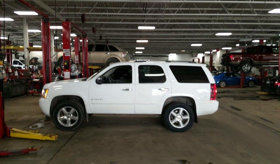

Hey fellas.. if anyone can help me or give me advice on lifts it would mean alot.. so I got my 07 tahoe 4x4 and today I found my passenger shock is shot so I'm going to buy new shocks idk anything about how these lifts work or what I need but I Wana lift it 3-4in. But I don't Wana buy new shocks if I need some other kind of shocks to get the lift I'm looking for.. any advice and maybe what I'm looking at spending.. thanks!!uploadfromtaptalk1438569586981.jpguploadfromtaptalk1438569604289.jpg

Get a level kit lift and Bilstein 5100s. The front shocks automatically lift the fron an 1" but are adjustable so maybe only need a 1/2" spacer to mount on bottom. This giving the front 2-2.5" of lift which is fine for stock angles. Then get a 1-1.5" rear coil spacer. If you want 4" go with Rancho or CST any bigger go 7" FTS or McGaughys
