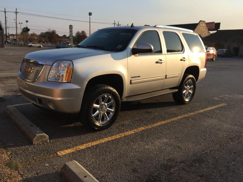

They are 305/55. Rubs away bar at full and I mean full lock. I've got to crank it pretty hard. I trimmed plastic behind wheel liner at the front, gave the rear of the front fender about 10 whacks with a 4 lb hammer and trimmed about 1-2 inches from the "sticky out" pieces of the rear wheel well. I'll get pics later.
Tires ride great, just a bit of hum. I noticed it because I was looking for it. My wife hasn't noticed any difference.
If I've lost any mpg, it hasn't been much. Maybe 0.5-1 at the most. Overall, very happy with how it turned out.

Nice trim job and looks like you got all the right places! How bad do they rub sway bar at full lock? Love those wheels too.

It runs but I have to crank the wheel pretty hard to get it to rub the away bar. I'm mostly unconcerned about it.
I love these wheels too. Probably my favorite oem wheel for these trucks.

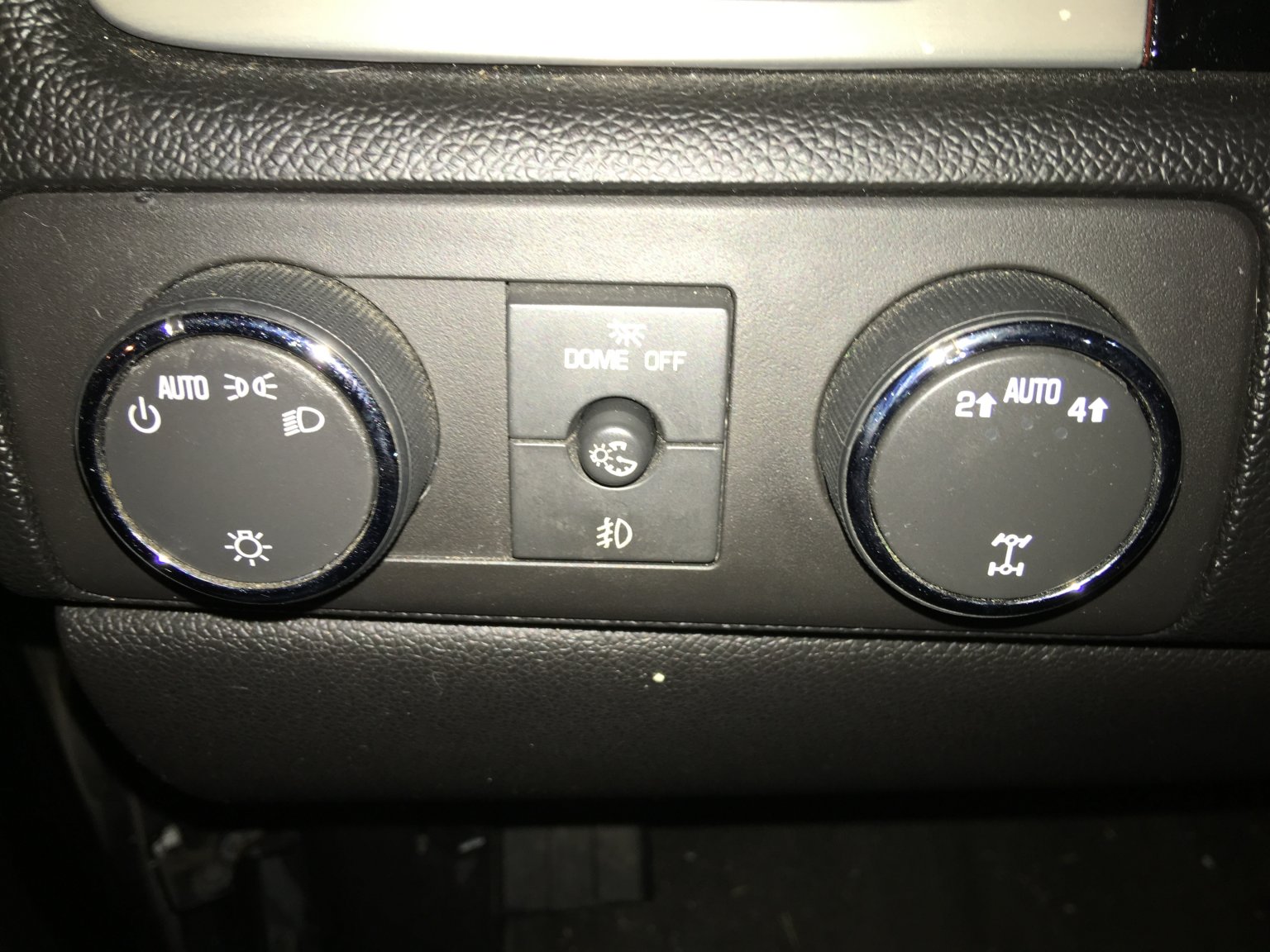

It's an LS 4 wheel drive. No air ride. Minor trimming? And thanks for getting back to me.
