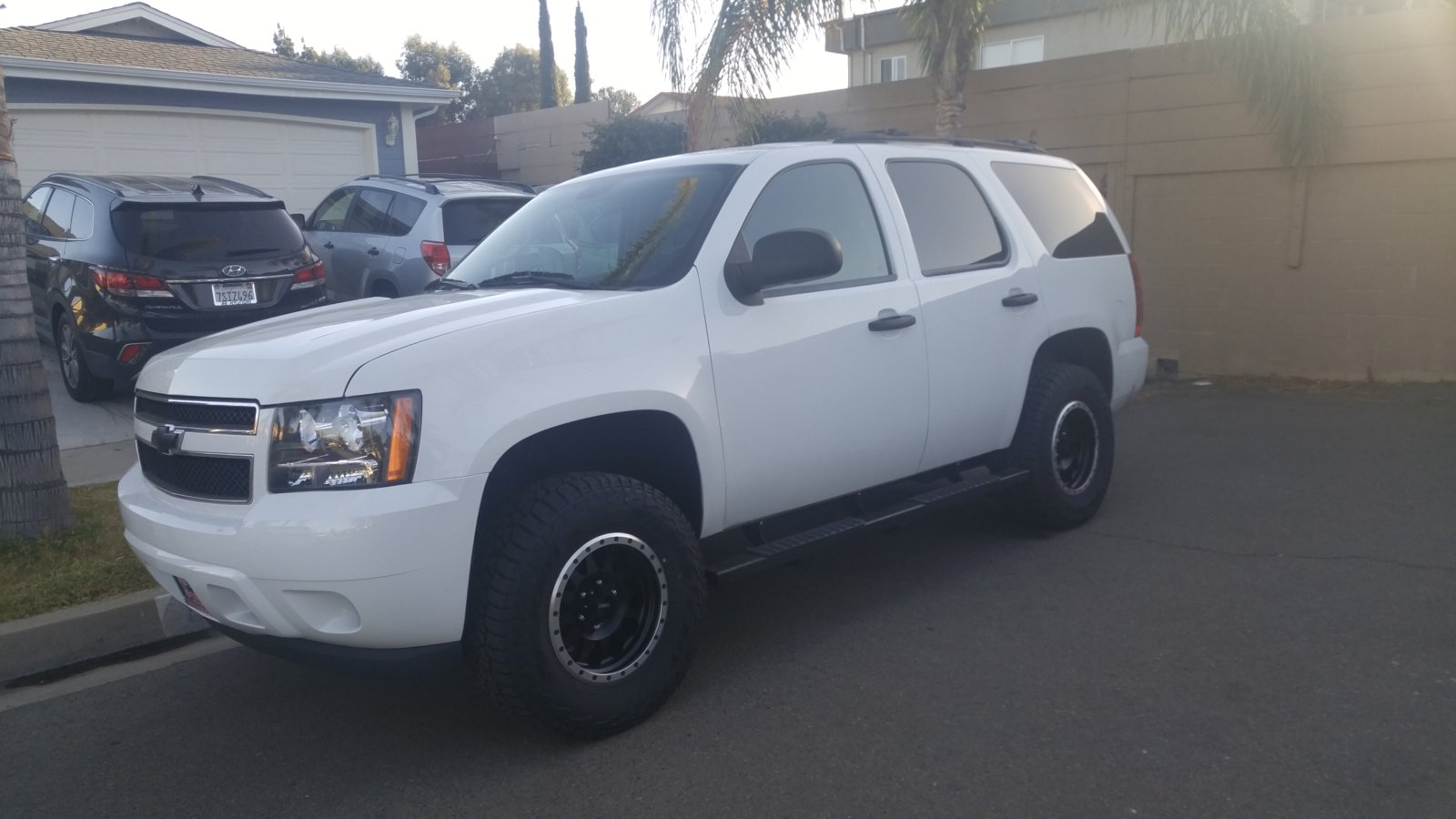

Lose the 20s. Here's Fabtech 6" 17" rims with Eezi Awn rack.
If you ever need to air down 20s they get a bit squirrelly, like they are going to come off the rim.
That looks great! What size tires you running? Man that looks good! I really didn't want to lift it 6 but maybe it's necessary. I don't want to rub but I'm open to trimming and I think having custom bumpers will help with that clearance too.

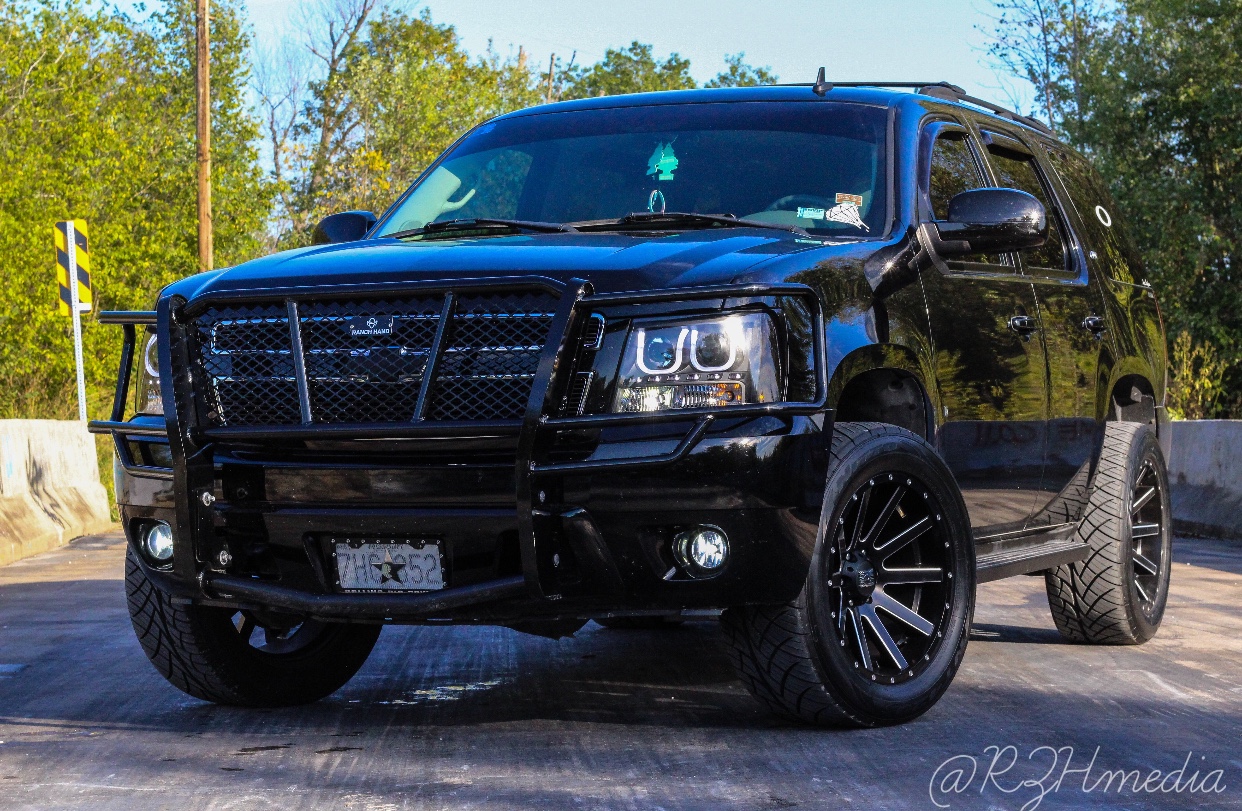

Help! Totally noobie and honestly my first Tahoe. Got a 2012 with very low miles that I want to turn into my hunting rig. I'm having custom bumpers front and rear built. Going to add roof rack, steps, fender flares, and Line X the entire vehicle. Also going to lift/level and add tires and wheels. The wheels I'd like to go with are Fuel Coupler D556 and the tires would be Toyo 305/55/20. I want them to be wide enough that it doesn't look like a railroad car when I put the flares on! Please advise on what lift I should go with. I'd like to go 3.5 front and maybe 2 or so rear but I don't want to lose ride and have bad angles up front. Thanks all!

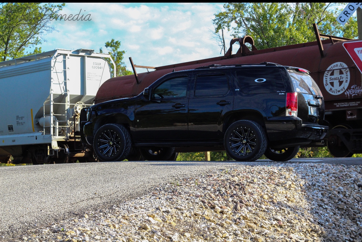

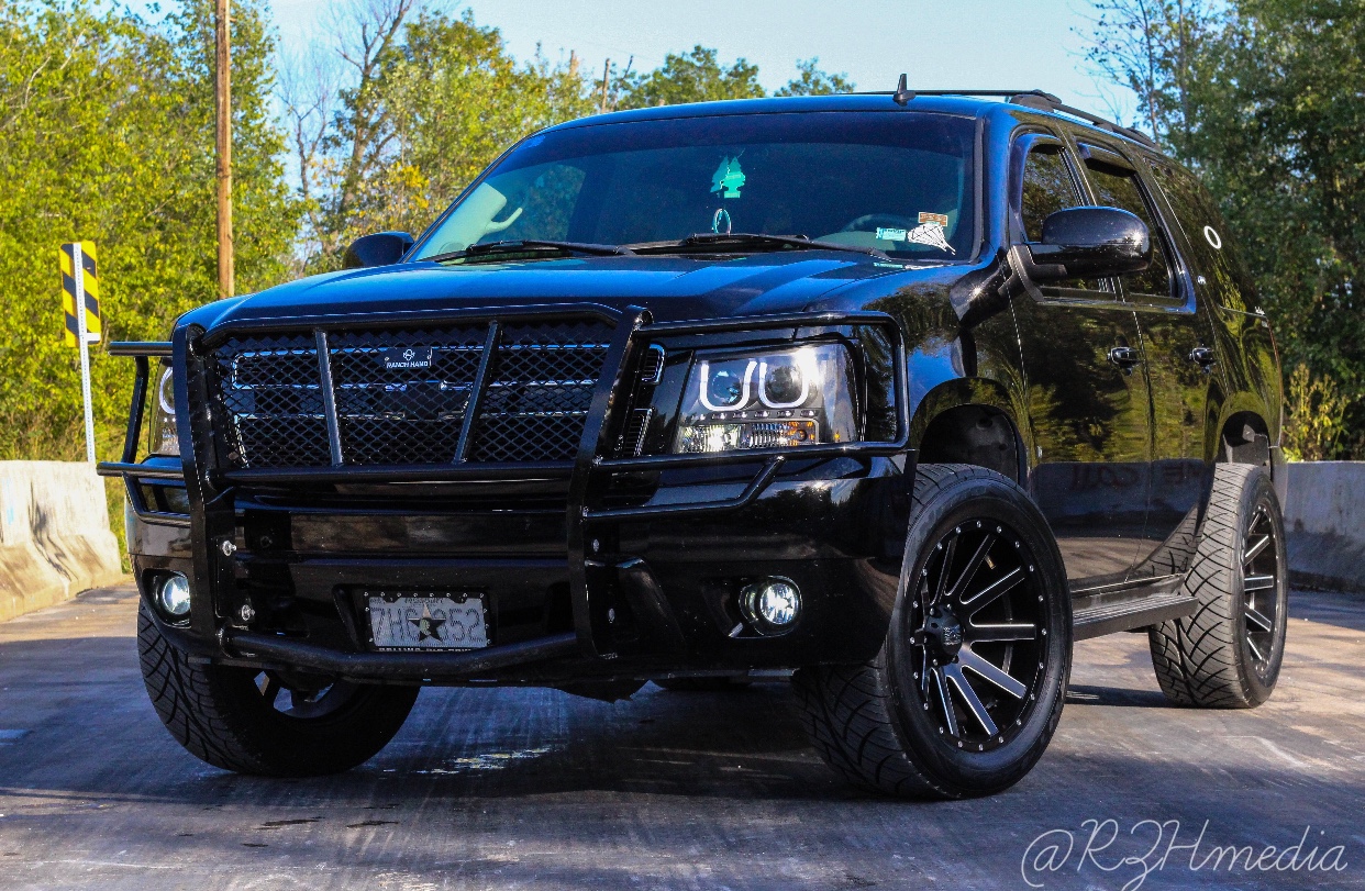

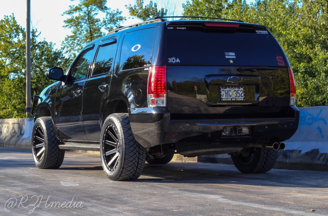

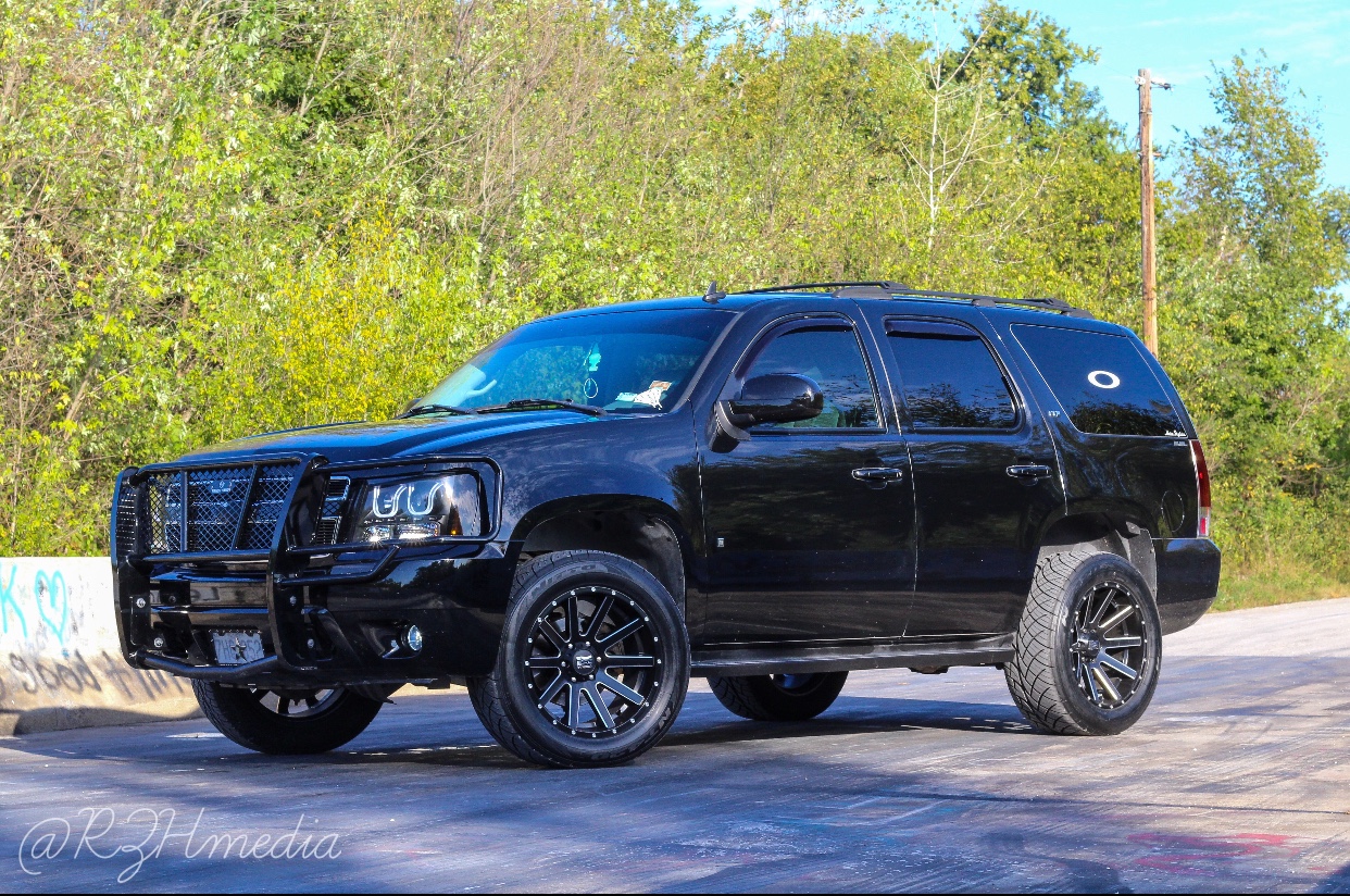

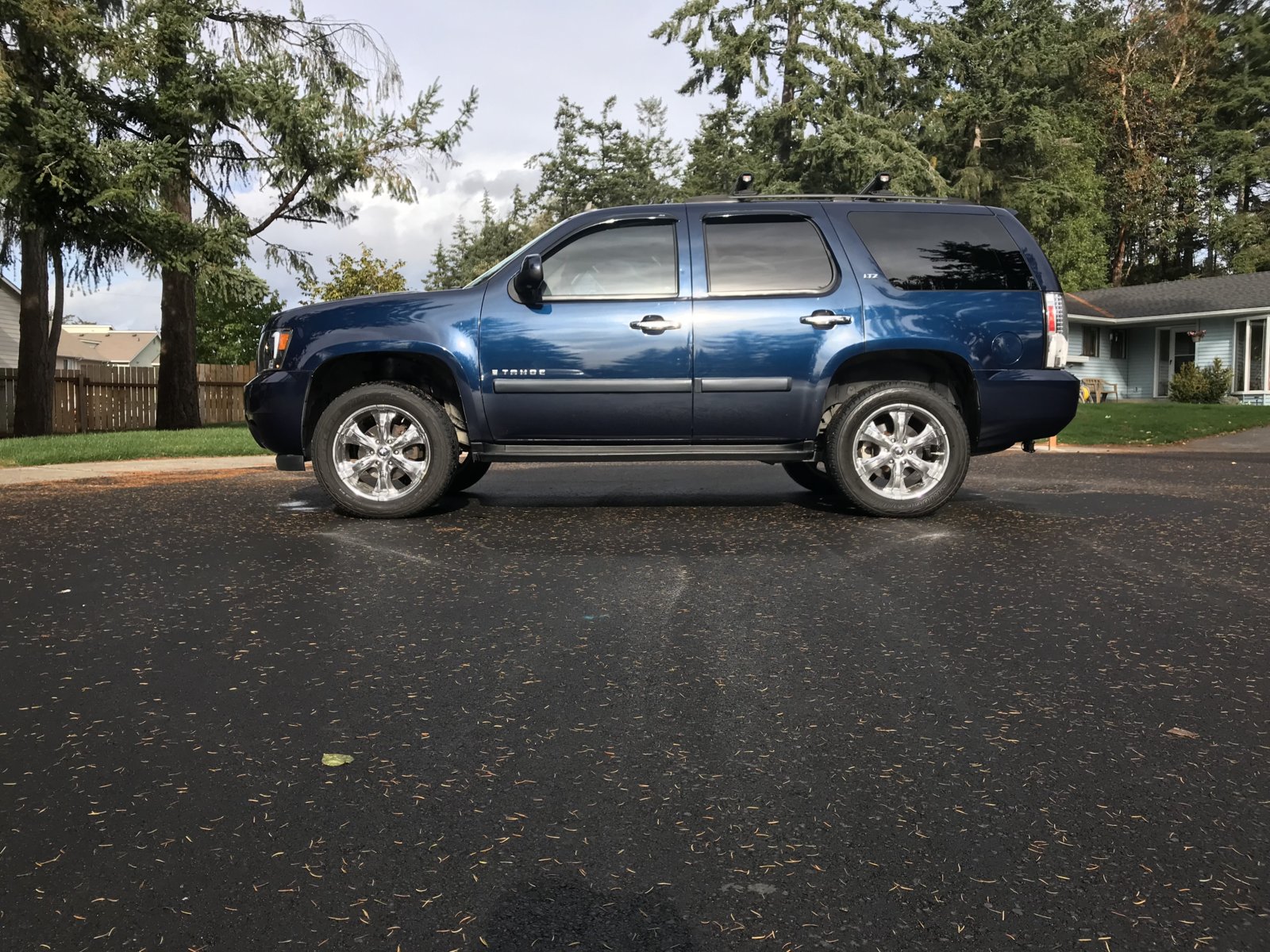

2007 LTZ 4x4, black leather, navi, roof, dvd.
3" Rough Country lift, 2015 GMC wheels, 305/55/20 BFG All Terrain
That looks damn good too! I like both rigs. I'm looking more for the 3-4 inch lift I think but I need to know if I'll be able to clear 305/55-20. If I decide to go to a smaller rim it'll still be a 33x12.50 toyo r/t. Think I'll rub on inside of fender well? If I can get by with 2.5 level then I would. I'd like a negative offset to push the tire out so it'll look good with the flares. What offset are your wheels? Both you fellas!

You won't be able to clear 305/55 on any level kit. Have to go up higher to a 3.5-4" but those kits can be sketchy so pick a good one. Also only way to clear is stock offset wheels but never not rub sway bar. The big flares like mine stick out 2" so you need a 20x10 -19 offset which won't clear on a level kit and I have my doubts on a 3.5-4". If it were me and you want a little offset I wouldn't run any flares and do a 20x9 -12 offset with 295/55 on a 2.5/1 or maybe 3.5 kit. Only reason mag clears the 305 he has is cause bfg are infamous on being skinny. Every other 305 will rub on a level

Thanks. Not sure what the offset is. The wheels came off a 2015 GMC Sierra with the All Terrain package. I used 1/4" spacers, no rubbing.

Thanks for the advice and help! What kit would you recommend? Where are you thinking I'll rub? I'd like to run that -12 or -24. That's the options in the wheel I want. Thanks again

You will rub both sides of bumper corner with the 20x10 -24. The front side where painted and need to trim the liner brace back. Also the rear fender side need NorCal mod to clear.
The -12 offset won't rub much and need some minor trim of the areas above.

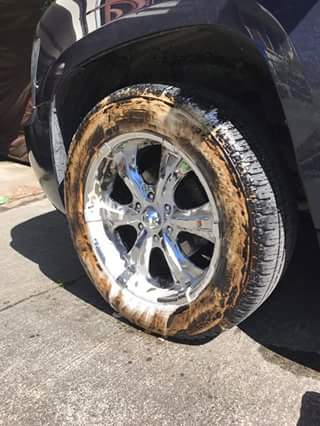

So running 33x12.50 MTs on my 3" level will rub with 17x9 -12? Could I get away with trimming minor plastic?
