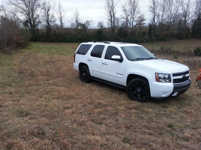

Old pic because it doesn't look as clean anymore. Actually gets taken offroad, even for a two wheel drive. Has dents and scratches from being squeezed into tight trails.....
6" Fabtech for autoride, autoride bypassed.
McGaughys front shocks set at 8".
McGaughys rear shocks with 2.5 spring spacer.
20x9 0 offset, 35-12.50-20
