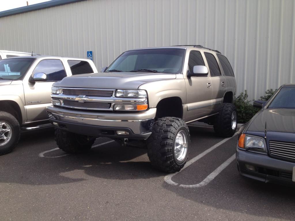

Just did an 1.5 body lift and cranked the keys in the front to get it more level. Fender measurements are around 38 at each corner now. Waiting to add a 6" procomp lift and some 16x12s and 33s. Waiting on lift spindles and NTBD for the ligt then off to powder and then order tires.
LRM_EXPORT_20180126_164514 by James Pate, on Flickr
That is a lot of lift for only 33s.

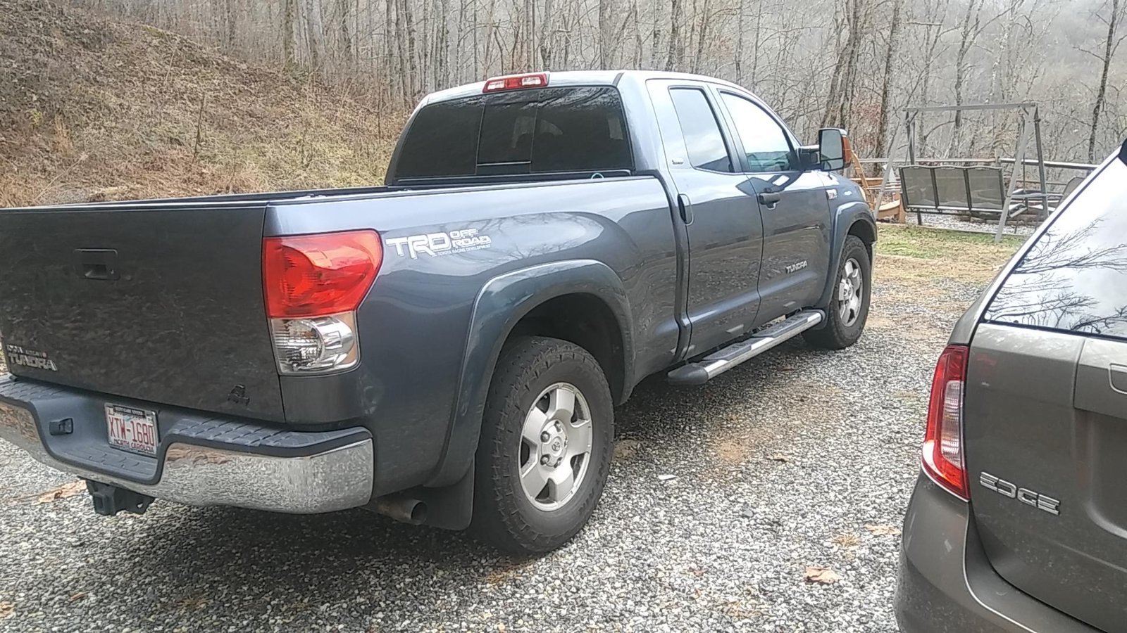

I had 30k when I traded my truck. Still had plenty of tread. Probably could have gotten 45k with tread still looking decent. I always buy new tires before I need them, can't stand shity worn treads . They rode great, no complaints .I rotated them every 5k and had on my truck for around 3 years, all on road miles .
Pic of tires with 30k
4f0017cf-d30b-4233-a547-8ed28c44b913-Vehicle-4.jpg 4f0017cf-d30b-4233-a547-8ed28c44b913-Vehicle-1.jpg

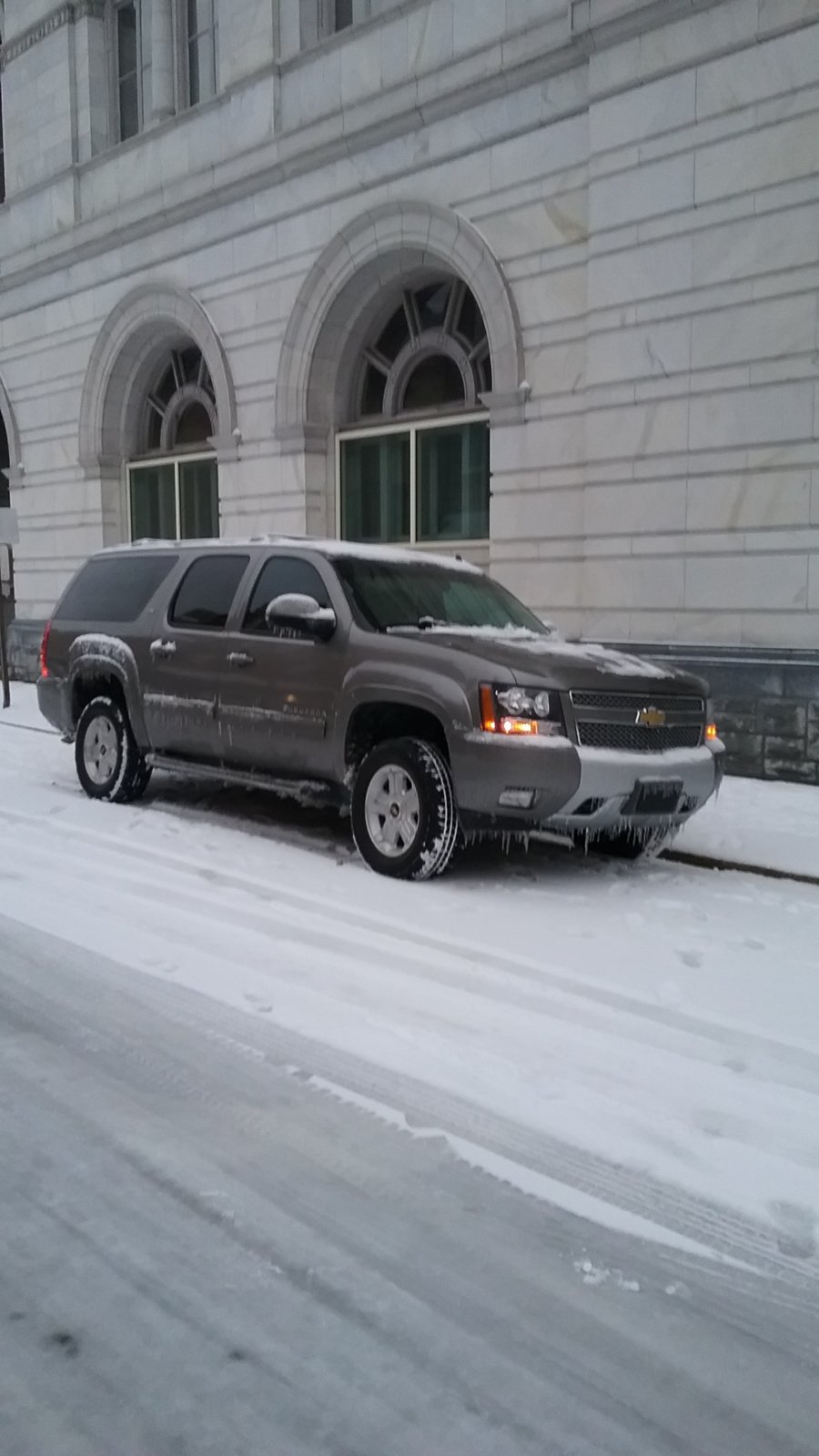

Lot's of great threads on here however, I am not finding one addressing my question, so here goes...I have a 2012 Z71 4x4 suburban with a Rancho 2.5 inch quicklift upfront and a 1 inch spacer in back. I am wanting to mount BFG AT KO2 275/70r18's on stock rims. Will this combo rub? If so, how much trimming can I expect to do?

I have a 13 lt tahoe 2” rc level only with 285 70 17 no rub. You have a slightly taller tire but 1/2 taller level... you should be fine
