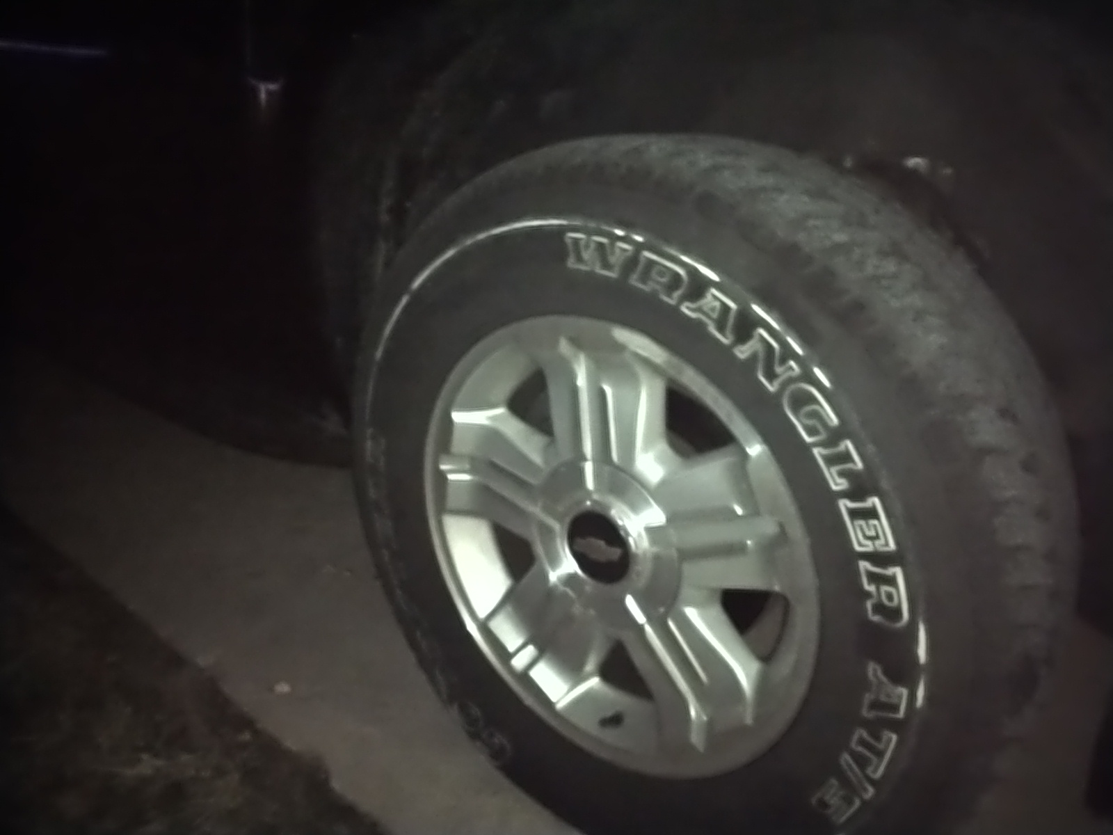

I keep forgetting to ask about this:
Ever since changing tires, I have this error message about the tire pressure monitoring system. How do I get rid of it? Besides pressing the button every time I start the car, of course.
I don't actually care about monitoring tire pressure.

Because it's a gubbamint-mandated safety system, it can't be disabled without external intervention. It's been a while since I've researched it, but there is (or was) a module that mimics four sensors that you program to the car just the same as if you were programming actual tire sensors. It sends out four individual signals telling the computer that the tires are at X psi.
Otherwise, just get sensors for your new tires/wheels and program them. IIRC, GM sensors are about $25 each and you can get a tool to program them for about $15 on Amazon. This would be really handy to relearn the positions after rotating them. The tire doesn't need to be fully removed from the wheel to install the sensor- just break the outside bead, squash the tire down and install it. If you're thrifty and bored, you can do this at home.
I'm gonna see if I can find that spoofer module.
*EDIT*
Looks like those spoofers are available in Canada and Europe. They're around $100 USD, anyway. It's easier and cheaper to just keep the system functional.

Are you saying it cannot be disabled in the computer?
