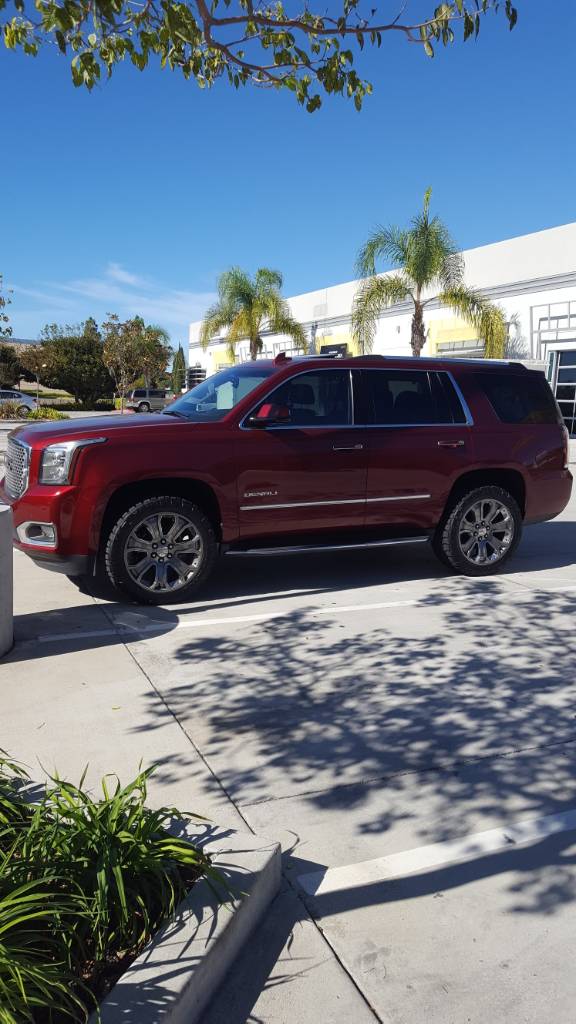

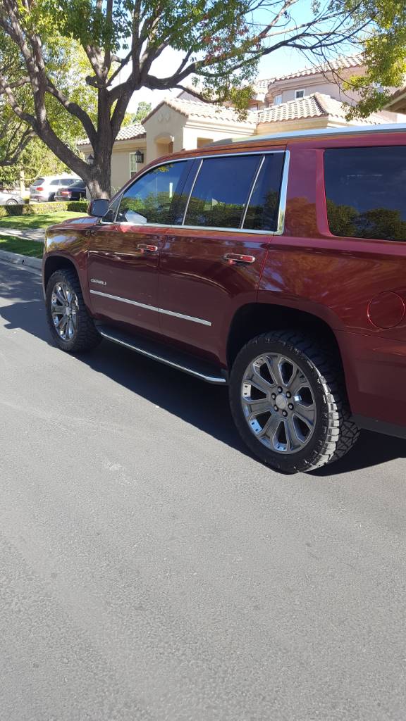

Finally got everything installed, must say I am very pleased how it turned out. Here are the specs:
2.5" SuspensionMaxx leveling kit
285/60/20 Goodyear Duratracs
Chrome snowflake wheels
