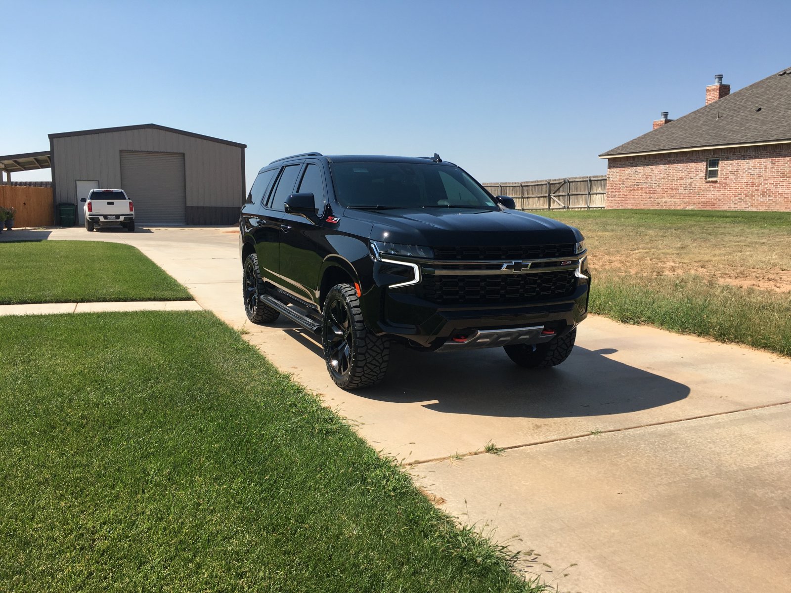

Changed some things up today. Went to the 2” level from RC (new release with front and back spacers). Also went up a tire size and squeezed in 285/55r22. Slight trim required to lower portion of front fender well behind felt, in-noticeable. Good luck going any bigger on a 2 or 2.5” level.

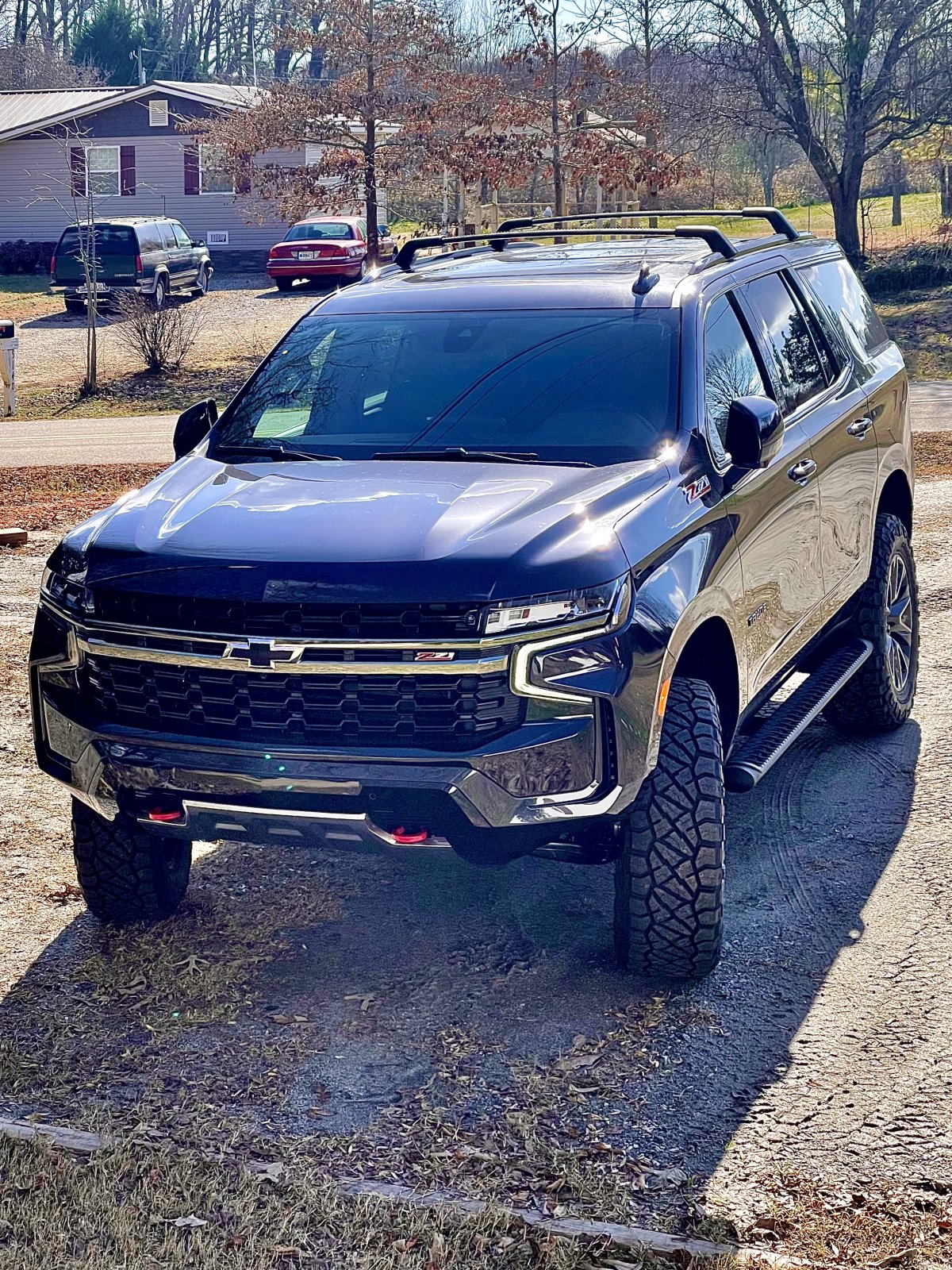

Got the 3.5 r/c kit in today. As well as the 33" nittos on 22x10 -25 hostiles.. wifes loving her new look!

Do your front tires stick out more than the rear or am I seeing it wrong?
Certain angles it appears like that, since the front bumper tapers in on the z71. If you look down the side, tread showing is completely the same. I need to take some more pics.
