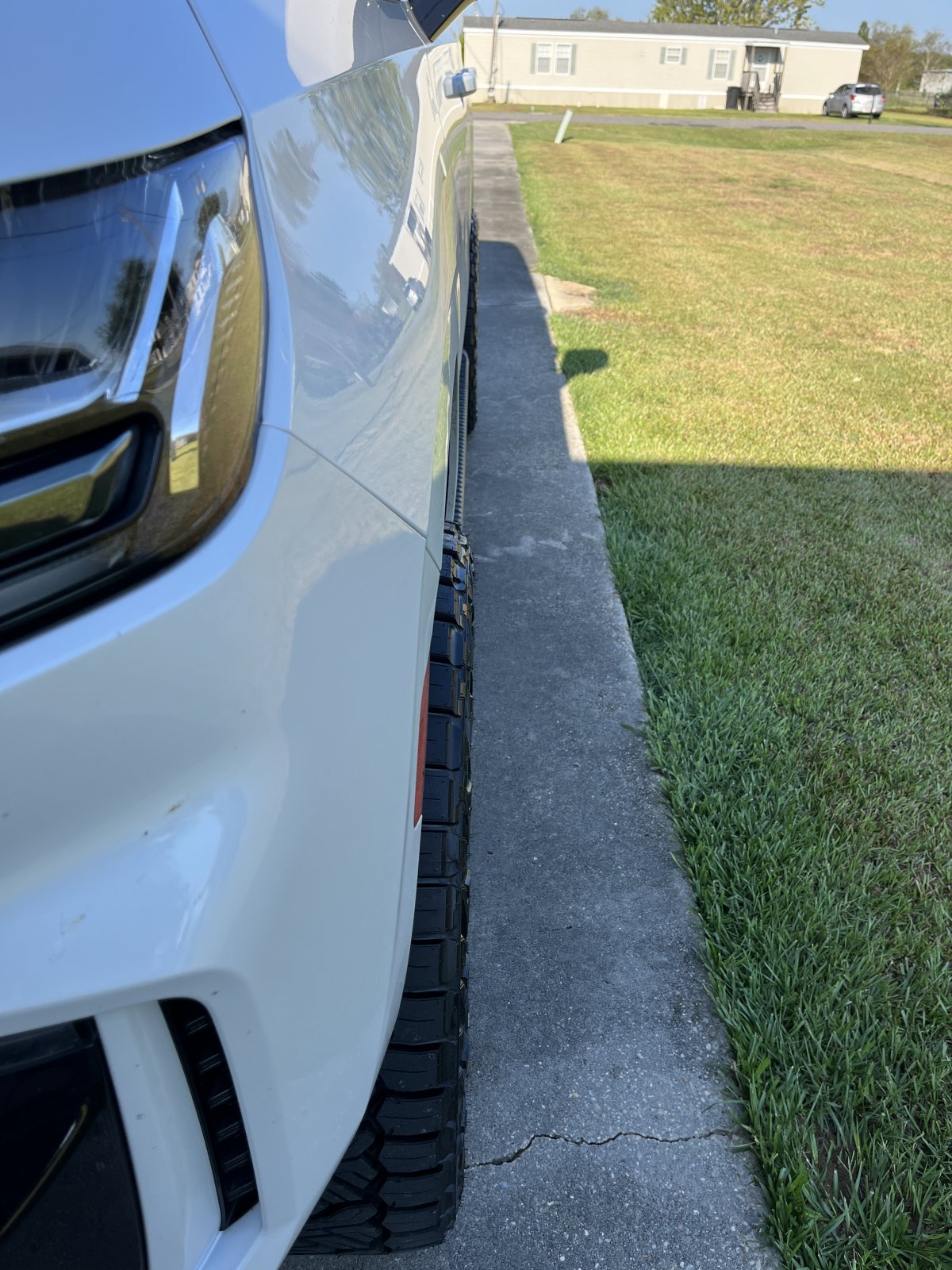

Probably not the struts, it’s the upper control arms that are hitting your wheels without the spacers. I’m running 2” RC, 1.25” spacers, stock size tires and had to remove the brackets behind the fender liners and do a little trimming. Did you remove the brackets?
That’s correct- Control Arms not struts- my bad. Yes, we removed brackets and pushed the felt back. No felt trimming though. I wonder what part of the felt that Westcott pullback kit pulls. I will look to see where the major rubbing was. I have the vehicle with factories back on them now. I might just put the 285/55r22 on and drive for a while and just constantly trim. I dont think I will be happy with 285/50r22 with a 3.5” lift.

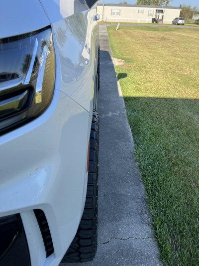

Finally finished… 3.5” RC lift 1.25” spacers 285/55R22 Nitto Recon Grapplers. Trimmed and zip tied felt back. Minor rubbing on sharp right turn. Wife is happy so I guess we good. Love the tires!! I have the Ridge Grapplers on my F250 and I think I’m going with the Recon next.
